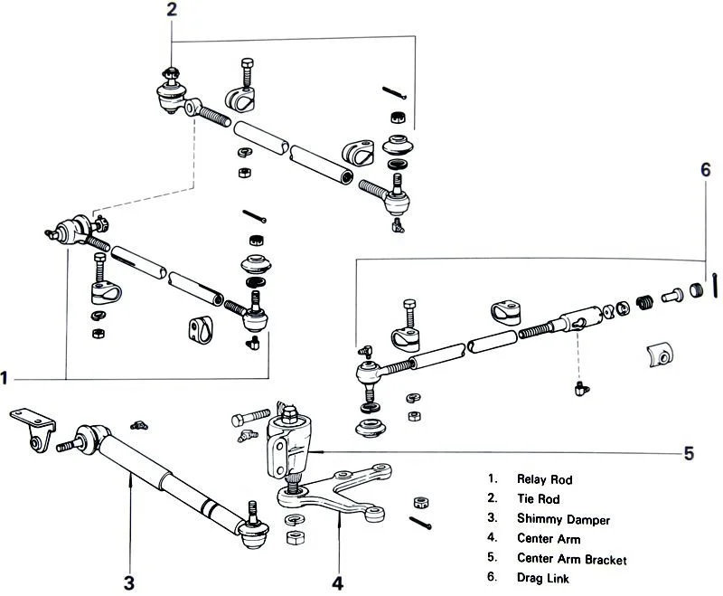

Help..removing TRE from Tie Rod
Help..removing TRE from Tie Rod.
Ok, all the Tie Rod Ends have been seperated and rods removed from rig.
Now I cant get the old rusty TRE (#2 in picture below) off the rod. Any secrets?
I removed one end but now have nothing to hold on to when turning the other end. Aggrevating!
I have read that others use heat but where? Heat Rod to expand the TRE end gets hot too ???
Also, do the ends all thread on clockwise?
Any help appreciated.

So in picture below, is this one Counter-Clockwise?
