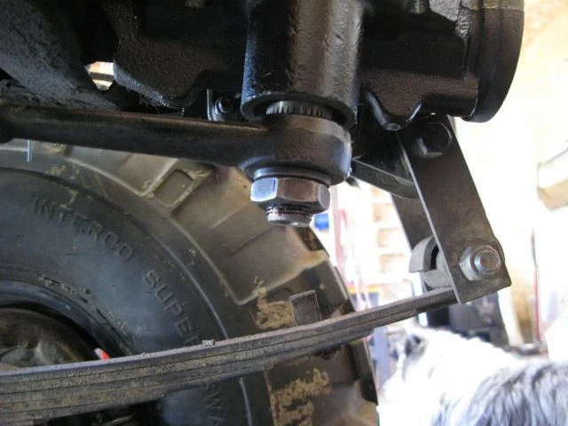

How tight this nut?
Anybody know how many ft/lbs for this nut? It's a chevy ps box. Any help appreciated.

I torqued my Pitman shaft nut to 140 foot pounds I cant recall in what book I found this spec.
