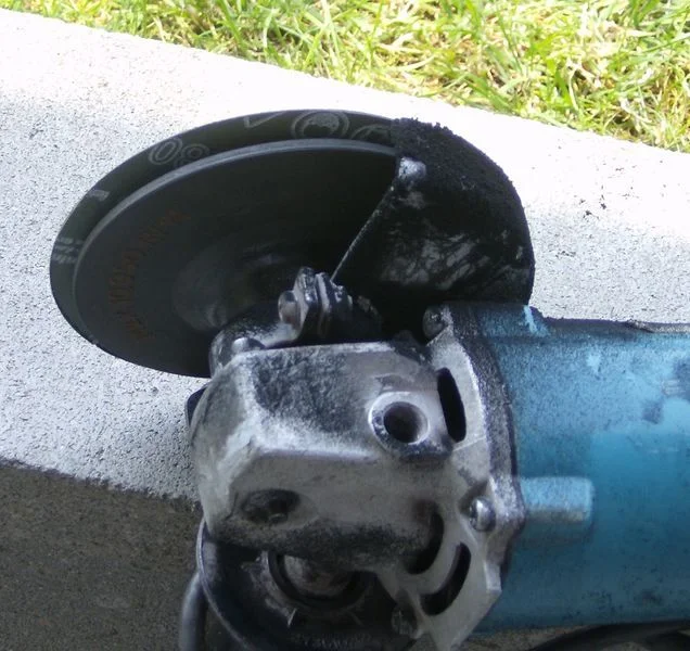

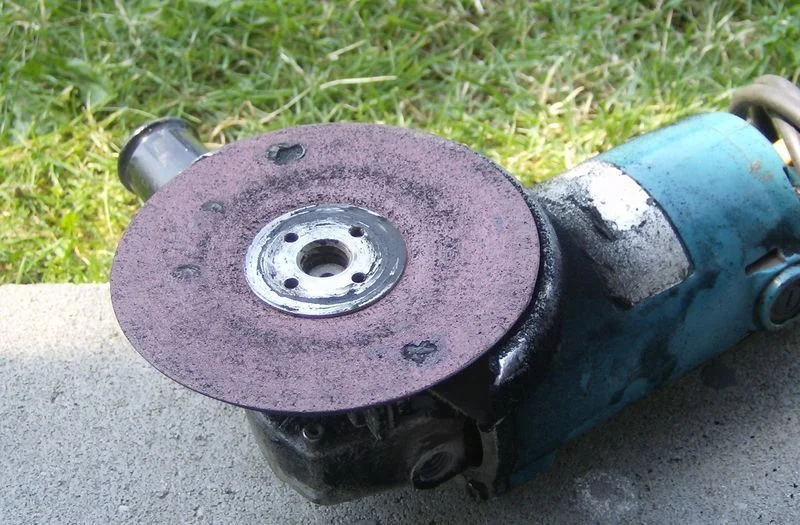

wire wheel works great for me also ,i also use the sanding disc (80,120,grit) with rubber backing pad does a nice job as well .
i would clean it up if ya have the time. i always use a face shield and ear muffs
