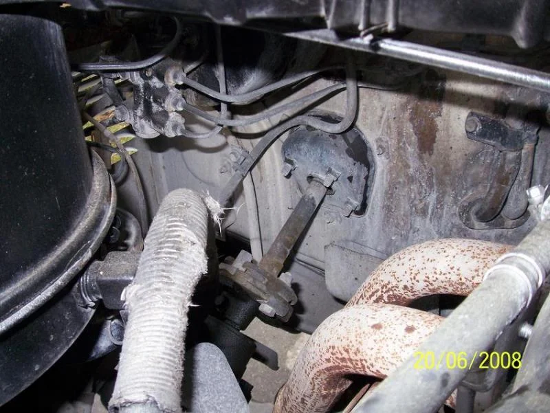

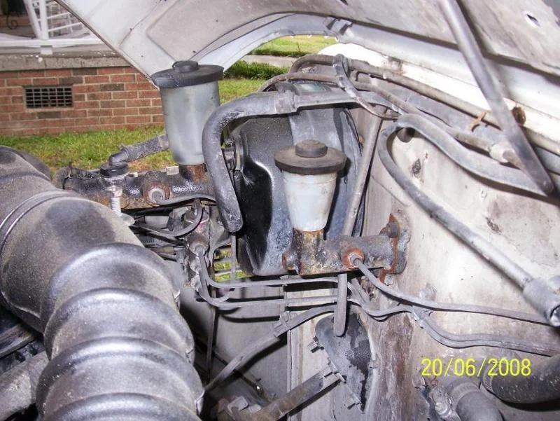

I beleive mine looks diff and is from AUS? mine is a single resevoir but has some funky lines, will take pics if need be? here is pics of mine RHD.
R
__________________
1983 BJ42 LX
CDN M101
"De Oppresso Liber"
Roberto is offline   Reply With Quote

Mine looks the same, also RHD. Can someone throw up a pic of a US or LHD cylinder?

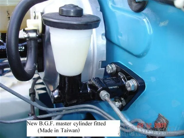

By the way - My BJ40 clutch mastercylinder uses a different 3- bolt mount (compared to your BJ42s):
