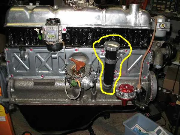

Again, that cover is not plastic, and you do not want to use it.
The engine oil fill is on the right side of the engine block, ahead of the distributor.

The middle one is from an F. It's the same one I have on the engine I just pulled, although I don't know the year of manufacture. Oil fill is on the right side of block in front of dist.

Yep, it's an oldie. My 71 had that (upgraded to a 2F cover).
Here is a pic of where the oil goes in on my 71. With the 2F valve cover I can now put oil into the motor in two places!
