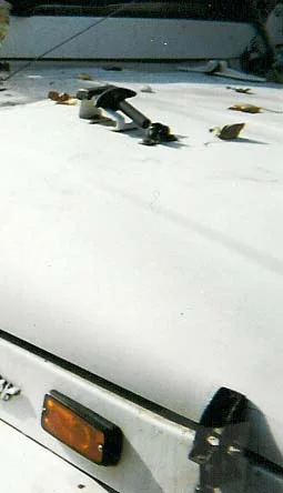

is there a hook that locks the hood-windshield hooks secure
My 73 never came with hood hooks to hold the windshield down. I was able ot track down the hooks, but that is it and they seem to need something to secure them when not in use. Is there a hook or catch that hold the hooks secure on the hood when not in use?

Yep, these things on the hood...

Uhhh.. THESE things...

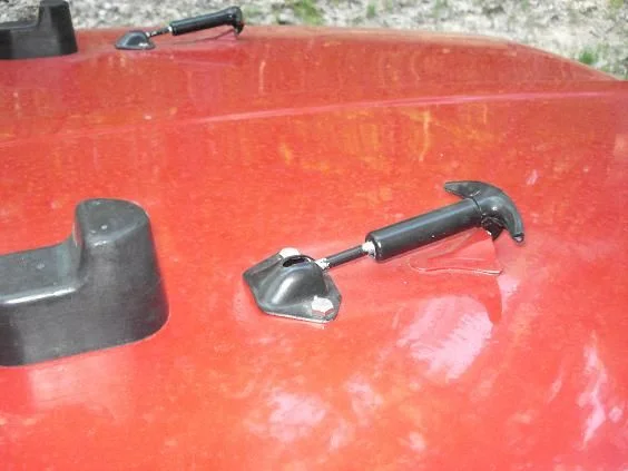

This is my 74 hood with the hooks. I used a 78 hood and welded the hooks on to make it fit a 74 windshield pads and hooks.
Kevin

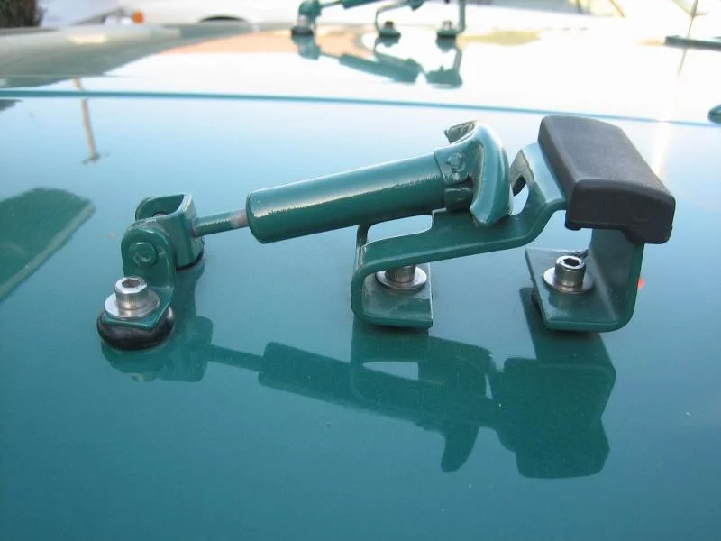

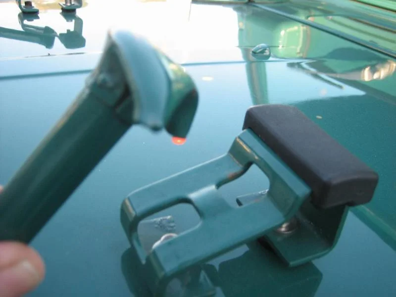

And here is another version. 1975 model

you meen like post #8
yours is alot cleaner looking

When I put my glasses on, I realized that they were the same! haha, I thought the same thing

Not the Same
Quote:
Mounting hardware is different and certainly not OEM.
Anyone got an OEM picture?

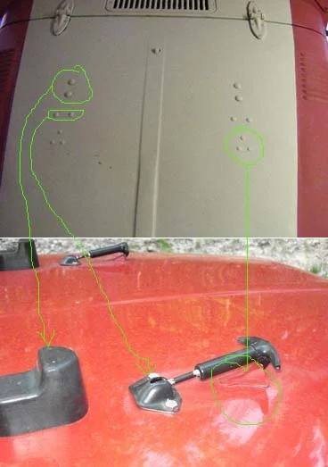

The two lower bolts are where the actual hooks bolt into. After that and closer to the windshield would be the bumper/hook retainers?

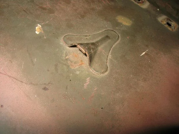

somebody drilled out and pried off your hook retainers
see pic

OH CRUD! I see how they go. I guess the only thing I can do is get some squared off U-bolts and use those in place of the triangle hood latch or maybe an "O" lag bolt? Damn that is ghetto. Then I still need the bumper for the windshield.
Since I can't see and it looks like they look wleded, or am I not seeing how they are attached to the hood since mine has the 3 bolts you indicated (2 for the hooks an one I guess where the catch went)? Is there any way for someone parting out a jacked up hood to cut out the catches or cut out chunks of a hood and I coulg cut them off and weld them to my hood?

1) find a trashed hood and drill out the hook retainer (they are spot welded in three spots) than bolt them in and replace the hardwear...or.....
2) or find the later set-up in post #11 and be done with it.
3) leave it be...as cool as it looks ....its a PITA to drive off road in the woods with the windshield down...its a PITA to drive on road with the windshield down...i have only driven with mine down 4-5 times in over 17 years.
