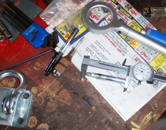

Come to find out, the hard way for me, this here rod has to be adjusted every time you replace the master cylinder. If you don't then things go down hill from there. The spec on this thing is 0 clearance to - 0.02". What that means is!!!!!!!! better to get it as close to 0 as posible.

First, You need to be sure your drums are in harmony (you know, like an OLD Rush song). Assuming your brake pedal is adjusted properly, and with the master off, pull that rod out from the front of the booster, did it have vaccum? resistance to extraction followed by an air escaping sound? Good sign I think, means booster is not leaking. Measure length to get yourself a baseline (not totally neccesary). There is a whole proceedure (read mega pain in the ass) that can be easily bypassed with a Billy Bob. This is it. Grab up your master, with pushrod in place, shove the master on there. Pay real close attention as the master comes in contact with the rod. Did the rod depress the master cylinder piston? That is bad. Did the master press against the booster with no noticable sping resistance? Could be real bad or just right. Case a, the rod is too long then every time you hit the brakes, brake pressure builds tell you can't move the rig. Too loose then permanent long throw in your brake pedal. Bla, bla, bla but you get the idea. Adjust the rod length accordingly.

Oh and one more. 0.02" is about a 1/4 turn or less on that length adjuster so it is real easy to get WAAAAAAAAAAAAY off. Bet it is too short therefore the root cause behind yuor long brake pedal throw.

I finally got time to pull the wheels and I found that a lining had separated from the shoe on the right front. I am replacing both sides in case it was a bad lot. I also adjusted the rod out to where it just makes contact when the master is bolted up. It took about 3 full turns to touch. That explains the double pump problem. I also re-bench bled the master while I had it out. I will pull the rear drums off tonight to see how they look and then will re-bleed the entire circuit again I think I will have it fixed! I also put in my new rag joint last night. Look out here I come. Gonna take the top off the rig and go cruising....Finally!
