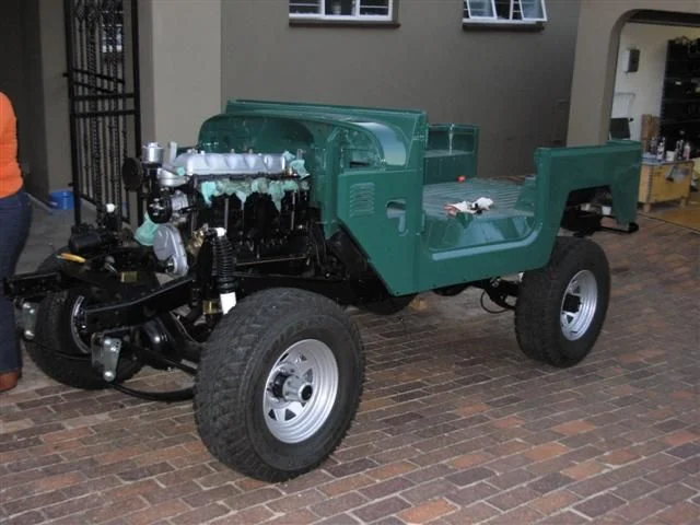

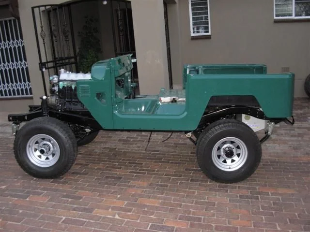

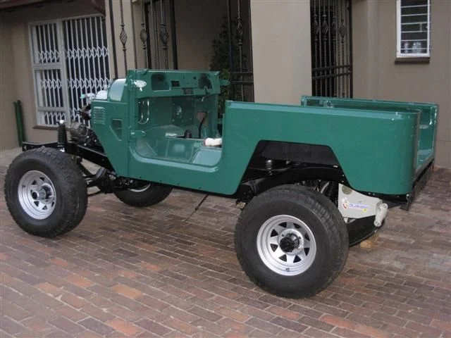

Then last night I eventually got the engine in the chassis
And tonite I got the cogbox (transmission) mounted too.
That is my progress since February this year, I'll keep posting as I progress.

Update
I managed to get one good alternator rebuilt from the parts of 4 Alternators.
Located and installed a two belt crank pulley for the 60 series PS
60 series PS mounted
The reinforcing (anti crush) bracket for PS rack
Alternator and two belt crank pulley
New master cylinder and vacuum booster installed
It broke my heart to cut a huge hole in the freshly painted rear panel for the long range tank filler
Due to the unavailability of most replacement weatherstrip and rubber seals it was necessary for me to cut my own from 3mm rubber sheet.
Mounted the overhauled Aisin carb
Fitment of the kick vents (Zimbabwe Air Conditioning) after installing the self cut rubber weather strip
Main tank filler
More updates to follow as work progresses.

Update
This is the current state of the progress on the BJ-FJ rebuild
At one point I became disillusioned with the progress because I was putting in hours and hours of work, but visibly the progress was not tangible
Needless to say a few weeks later and the progress is now at last tangible and visible.
