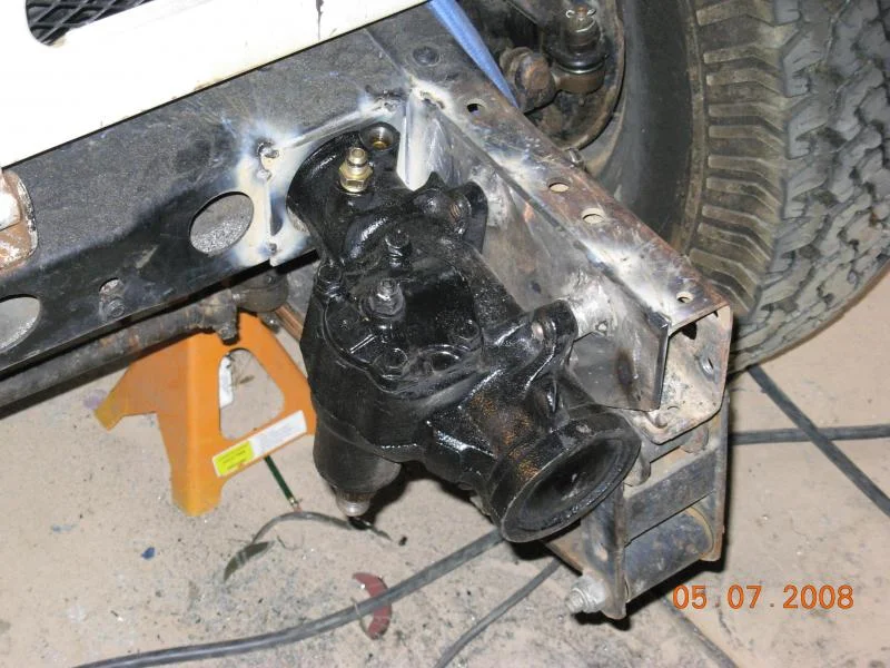

test fit before welding everything up. I also decided to add a 5/16 plate where the box penetrated the frame for a little extra strength

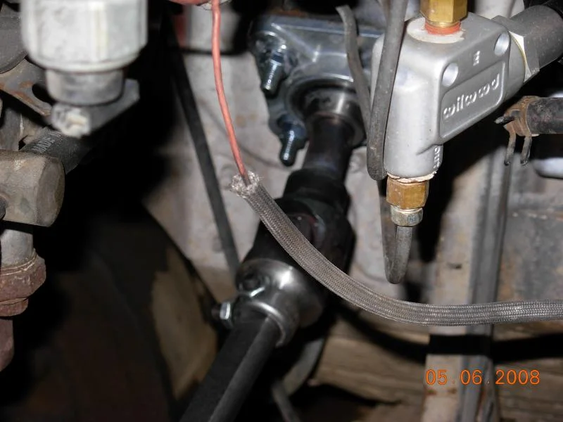

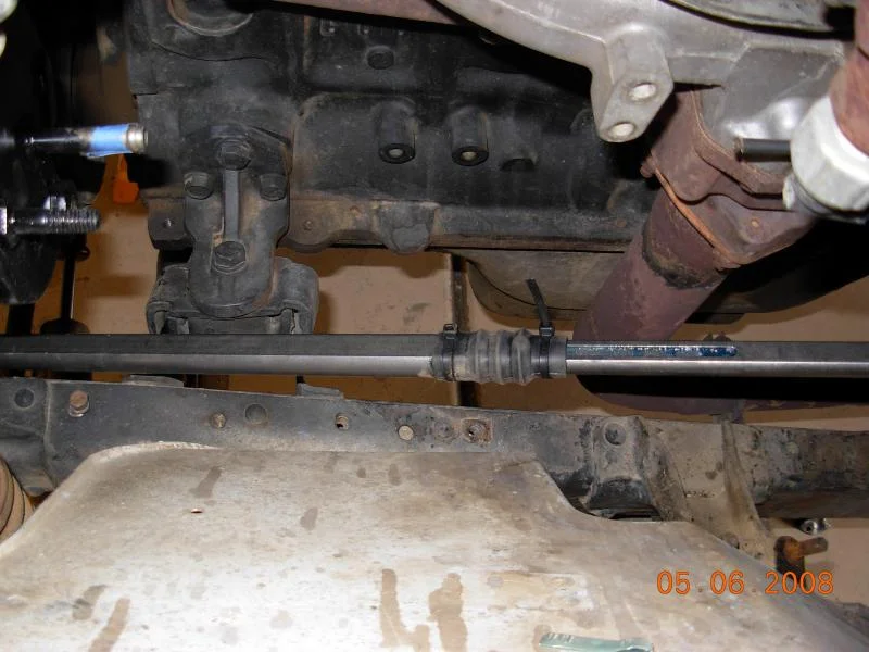

I used the Borgeson 36" DD telescoping steering shaft- It fit between the motor mount and frame.

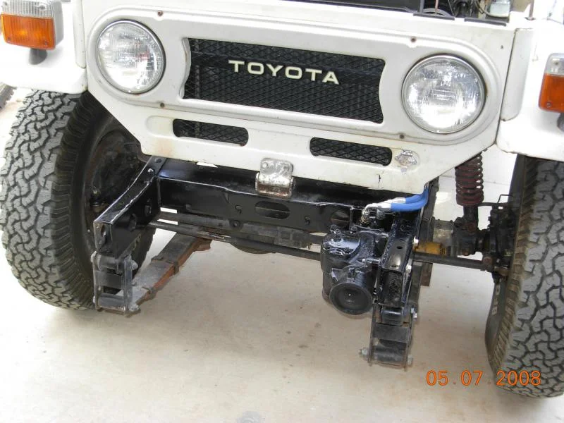

here is a shot with the bumper on.

Very nice job. Enjoy the simplcity of driving in the rocks....

Whats the deal with the wire ties

My guess it they are to hold the rubber bellows boot to the steering slip shaft to keep debris out. These are found on many factory setups and are normally held on with metal band clamps but a zip tie can do the job just fine also I bet.

Does that thing ride hella-hard? Your front shackles are almost verticle.

John Smith was correct- Just a dust boot- like they use for shocks. - BTW- I did trim the excess off so it would reduce drag and friction

The shaft is a Borgeson telescoping shaft. They have a nice web site that has some good info.

Actually rides nice for 32 year old springs. Give me a little time and I will correct that shackle angle-

The shaft was a 36" DD with a 1" bottom and 3/4" top. It cleared the motor mount and frame barely- but with some wiggle room.
I would strongly reccomend this shaft and u-joint set up for anyone doing this conversion- it's just superior to a solid shaft set up and the u-joints are trick sealed bearing units.
