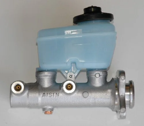

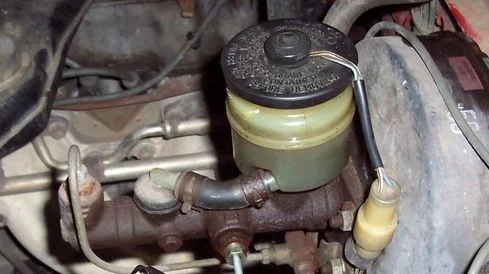

FJ80 Non ABS Master Cylinde - Marlin's
This is my current master cylinder - discs at all four corners and I was thinking of upgrading to this....

FJ80 Non ABS Master Cylinder
I was thinking of upgrading to this master cylinder

Issue...
I wanted to get a bit more responsive breaking and I read the larger bore could make a difference. It looks like a direct bolt and replace, but is there anything I am missing. New to disc brakes mods.

Just for clarity, you want the master cylinder for a FZJ80, not an FJ80. It should be a bolt on. One suggestion. While you can bend the line at the front of the master cylinder to match, it's easier to just boneyard the line from a mini-truck/4Runner with the same side outlet.
What's interesting is the FZJ80 brake master I bought from Toyota looks different than the one Marlin sells. See attached.

the one i got from JTOutfitters looks just like the one pappy posted (i was told it was from an FZJ80) but i didnt install the proportioning valve and as was stated i just bent my line to make it line up. it has worked great so far (about 5 years) stops on a dime and in a straight line. oh and i also upgraded the front calipers to 4runner calipers for better front stopping power.

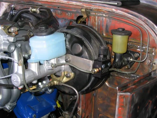

I did the 80 master from marlin and a dual diaphram mini booster, the dual booster made a HUGE difference, brakes are super responsive now.......
writeup here:
http://forum.ih8mud.com/40-55-series...r-writeup.html
