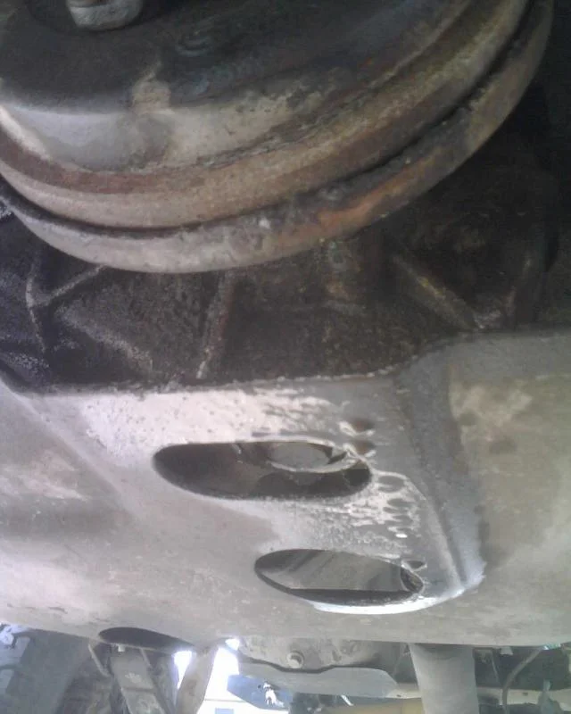

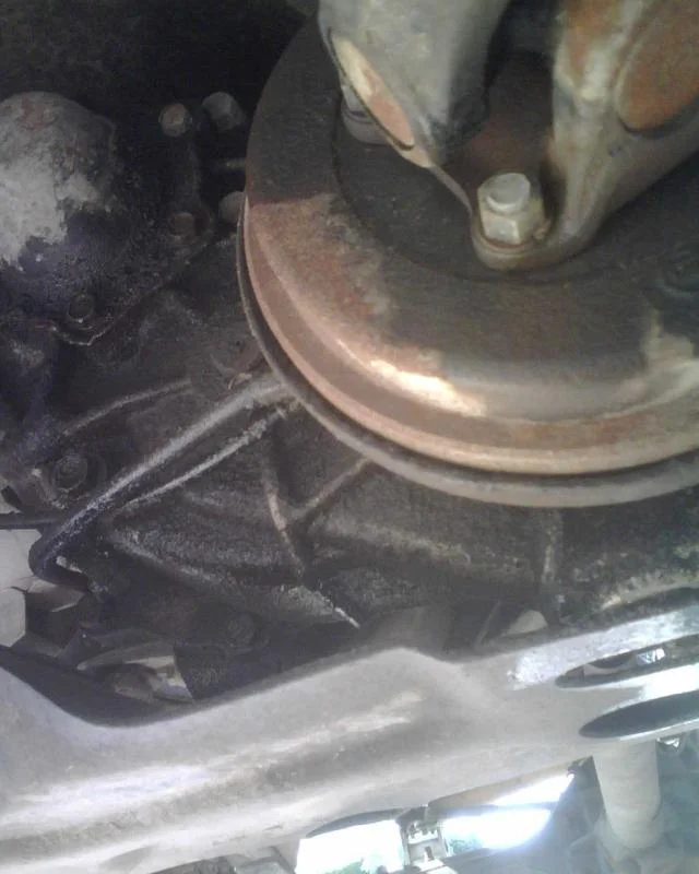

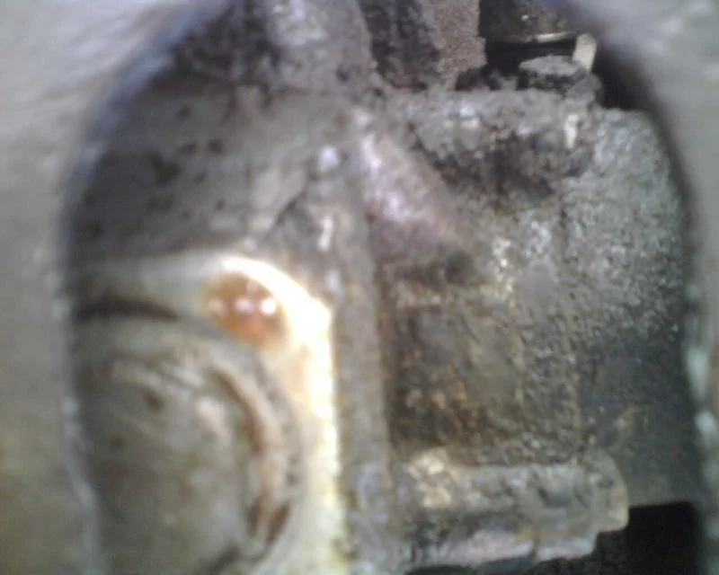

Here are three pictures of where it is dripping. The first two are the view looking forward and the third is looking straight up at where it appears to be leaking from. Possibly a bad gasket on the other side of that bolt?
Let me know what you think.

thats a pretty common leak on these rigs. New gaskets and maybe a sleeve should cure it. Other members will have more info I've yet to replace mine.

Luckily the fluid coming out looks real healthy. A nice golden brown, like new motor oil.

Rear seal would be my guess. Pretty easy to replace.
