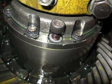

First, bleed the system. Sounds like air in the pump and lines.
Pull, the hoses on the pump and manually turn the box to make sure it is not a problem with the box.
Also, if you say it happens when in four wheel drive, is the ARB on in 4WD? If the infamous "pin" in the ARB came out it would cause it to lock up.
