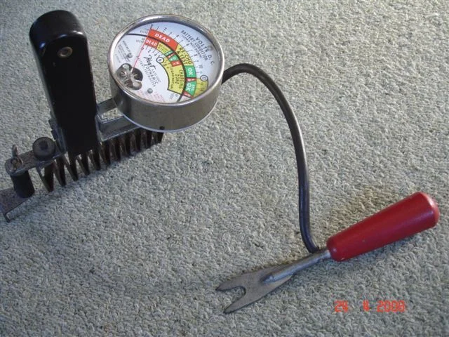

Here's a photo of my tester that cost me something like 10 or 20 dollars at my favourite antique/junk shop:

On topic comment: That is a neat looking battery tester!
