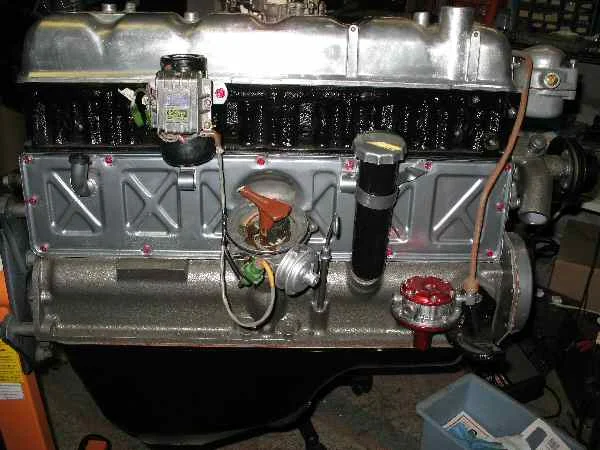

You can use your stock wires. The FJ60 dizzy clamp just needs a 8mm x 1.25 x 16mm bolt to secure it. Pic is before I cleaned it up but you can see the simple method of securing it.
Ideally you would want to get the wiring harness section from the donor FJ60 to the FJ60 dizzy and splice that into your 73.

The ignter/coil assembly will mount right to the head on the F engine. I'm debating this location though as Toyota later moved it to the fender for some reason. Heat or vibration???
Yes.

The stock FJ40 wires can be used. If you wanna buy new wires, order a set for 1981-later FJ40.
The signal wire lead from dissy to ignitor will need lengthened a few inches if the 60 coil is mounted out on the FJ40 fender. That's a simple cut 2 wires, splice in 2 pieces of similar gauge and crimp & tape.

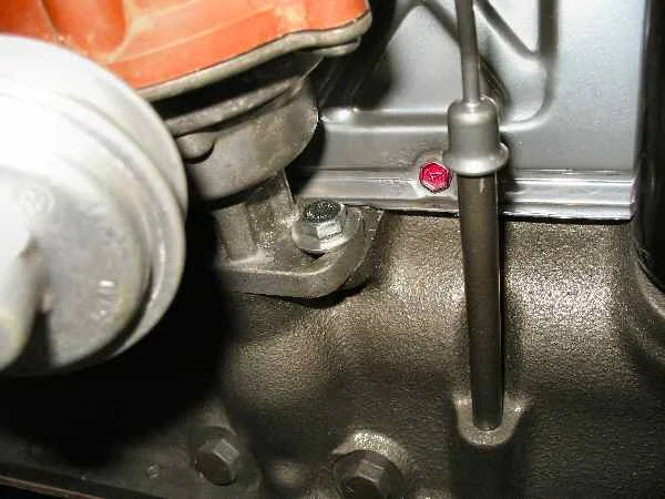

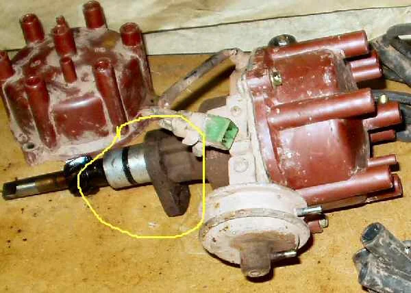

OK I am blind so the simple didin't work (and your site rocks). I'll grab a bolt on the way home. It will robably be self explainatory once I see it, but can't see it in your picture (the yellow circle must have it)

OK, here is your simple pic!

yup simple I picked up a bolt yesterday. I'll start tearing things down this weekend if my wife would get off my back and let me wrench. FOr some reason she feels jealous of my time with my other lady in my life.
