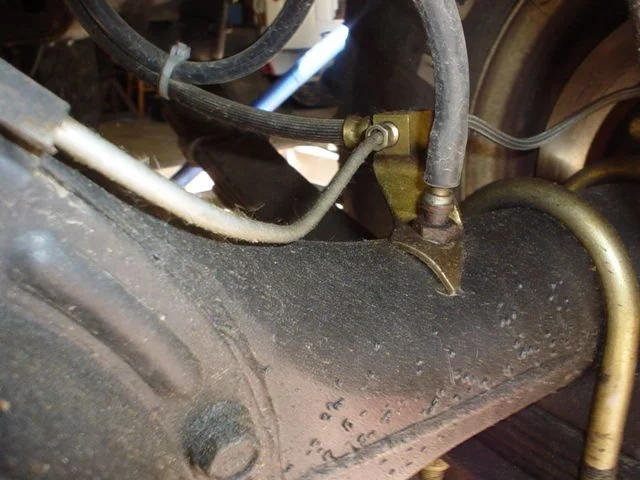

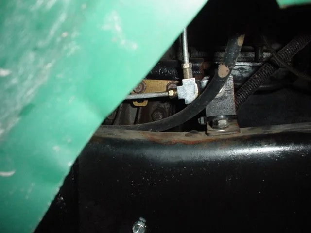

That is the fitting I used. Yes, it is 10mm. For the rear, I used a piece from a Chrysler MiniVan that was the flex hose, T fitting and nifty axle mount that bolted right up in place of the old 9mm Toyota fitting.
It really pays to have a little local autoparts store where there a couple of old farts who have sold parts for years. Guys who have to use their brains, not a drone-screen.

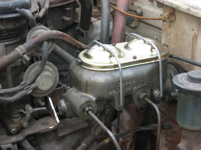

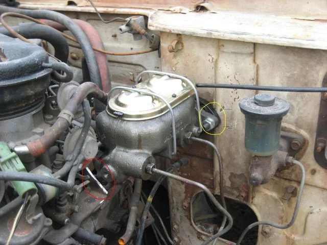

Ed, got the adaptor and GM dual circuit installed this evening..........finally ...........overtime at work is killing my cruiser timehad to grind a piece out of the rib and have brakes now after bench bleeding the GM master; everything fit well but still have to go with the cable throttle route to get the gas pedal hooked up; one problem; the 69 brake yoke rod is too short; although I adjusted it all the way out; well, I left about 1/2 inch threaded in the yoke and was just making a dry rundon't feel comfortable about unwinding it any more than that; any thoughts on longer yoke rods?; mine is about 3 1/4 inches; could probably use a 4 incher adjustable one........will post pix later this evening after get some chores done..........have a stock 79 2F with a grafted 69 pig body onto the 79 pig frame.....front disks rear drums............BTW the adaptor is awesome

here are a few pix showing the cut on the rib to get the adaptor + master cyl flush with firewall <yellow>and the cut on the throttle plate to get the master to fit<red>....still need a longer yoke pin but short of getting a threated bolt and cutting it does anyone have an idea of a 4 inch or longer yoke pin?; can always cut a longer one down but not much you can do with one that is too short TIA; .........Ed; could not find any sae to metric flare adaptors this part of Alabama so went with an sae neck down to 3/16ths line reducer and used the toyota lines after flaring them
Lou

Lou, it has been a while since I did that mod, but I think I did the same thing and just used an SAE fitting at the master Sorry I could not give you a heads up about that.
Cable linkage? Well I used the type that was cable-direct-to-carb and did not use a rod at all. So I am no help there

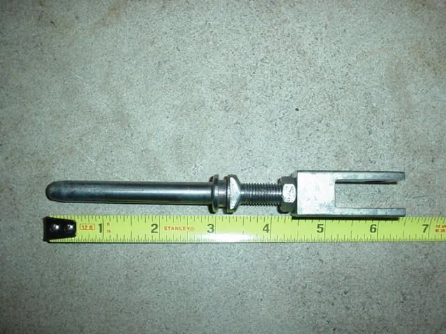

If there was such a thing as metric allthread, you might use that. I have a brake yoke out in the gay-raj that i'll go measure. I used the OEM pushrod on mine

OK, I have a pushrod that may fix your problem? It is currently screwed all the way into the yoke with no threads showing, IOW as far as i would feel comfortable with.
If you need it, I'll send it out on Tuesday.

Ed, wow...........that one will work; what is it out of?

A '40 I guess. It is just on the "parts shelf"
PM me your address again and I'll send it out on Tuesday.
