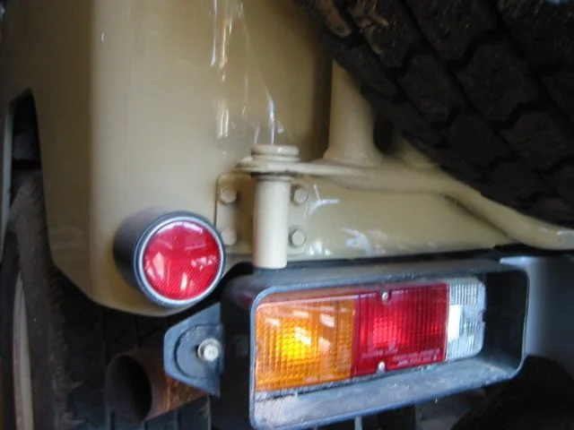

here is a photo of the rear lights with the guard on. I will get a photo of the instrument cluster lights on at night and see how it comes out.
Cheers,
Josh

Quote:
Originally Posted by patches84 View Post
G'day Beejay42 and jabxyz,
As promised, here is the info for the LED globes. The email is jag-trading@hotmail.com and he is called John. The part numbers are:
2 x 36 LED BA15S WHITE GLOBES (for reverse)
4 x 36 LED BA15S AMBER GLOBES (for indicator)
2 x 36 LED BAY15D RED GLOBES (for stop/tail)
6 x T18 18 LED WHITE GLOBES (for marker lamps)
1 x 36mm 6 LED FESTOONS WHITE (for interior)
2 x 50W LED RESISTORS (for indicators - one resistor per side)
Cheers,
Josh
Josh,
Thanks alot this is super helpful. Just to be clear for example:
"2 x 36 LED BA15S WHITE GLOBES (for reverse)"
means that I want to order two of the 36 LED BA15S White Globes correct? I need to modify this a little for the instrument cluster so that I keep three white festoons, one each for the turn signals and high beam light and three red festoons for the remainder of the panel so that it is backlit in red for preservation of night vision purposes.
G'day Lads,
The resistors go between the positive wire for the indicator and the earth. They increase the resistence so that the flasher mechanism works.
Cheers,
Josh
Josh, Thanks this is really helpful. Is ther any chance that you have a pic of exactly where in your setup you put the resistors. Something in the village idiot style for me.
