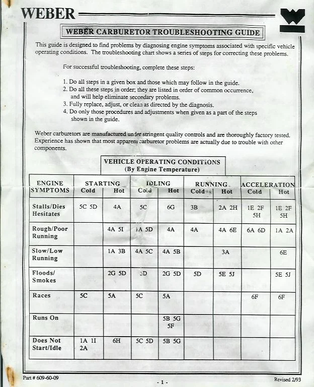

Old 03-28-08, 12:40 PM   #2 (permalink)
450,000+ mile club
Join Date: Jun 2005

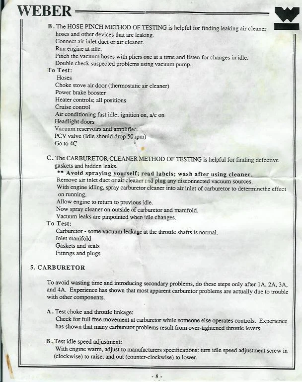

Here's a question for you guys who've got a bit of experience:
I'm running a weber 38 on my 2f. When I start it cold, the choke kicks in and it revs up pretty well. When I hit the gas to kick the choke down (off?), it starts to stumble a bit and will sometimes slow down till the engine cuts off. It didn't do this when i first installed it (about 9 yrs ago). Once it's warm, it does fine. Any thoughts? Thanks, ty
__________________
'79 Pig-"Inoshishi"
'69 FJ40-"Da Roofless one"
tyama is offline   Reply With Quote
Old 03-28-08, 10:26 PM   #11 (permalink)
Oh...Durka Durka Durka.
Poser's Avatar
Join Date: Oct 2003
Location: in the shop
TLCA# 1856
Posts: 16,023
Garage
When it starts acting up like that, spray some ether, or carburetor cleaner around the adapters and mounting flange for the carburetor, and report back as to what happens.
I am betting that you have a vacuum leak, that when the engine is cold it is more pronounced and when the engine is warmed up, the leak is not as severe due to things expanding as they get heat into them.
The bolts shipped with the adapter, that attach the top adapter plate to the lower plate are too long, and if not shortened up before installing, will pass through the lower adapter that they thread into, and cause the lower adapter to be pried up off the intake, creating at the very least a vacuum leak, and more likely than not, fracturing the lower adapter plate. This has been the case since the very first Weber I installed on my junk back in 1992, and is something that I have addressed with every Weber I have installed since. (At least 25, the most recent being last spring, and the bolts are still too long)
Post up what you find out...

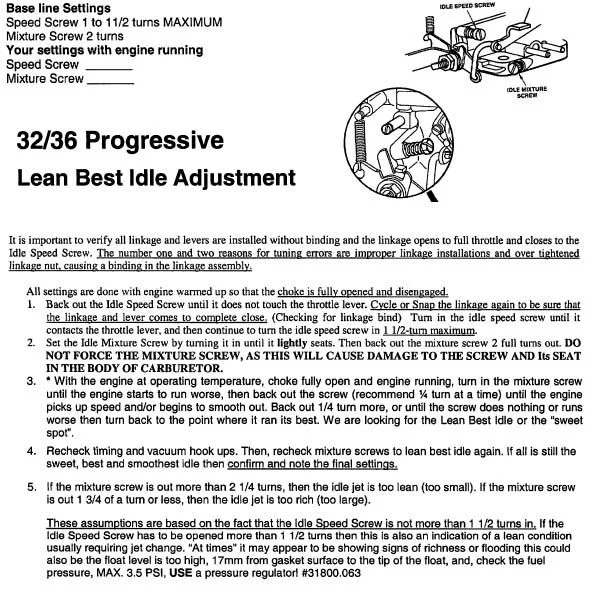

32/36 adjustment
JohnnyC is offline   Reply With Quote

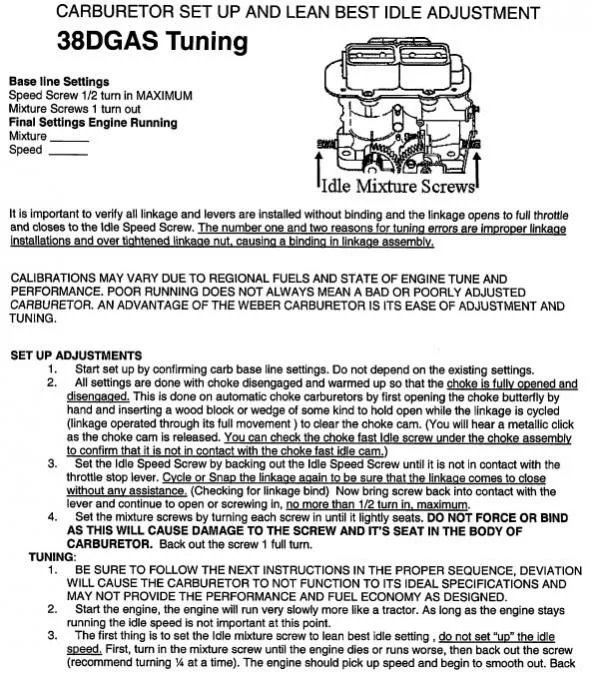

38dags
38 dgas adjustment

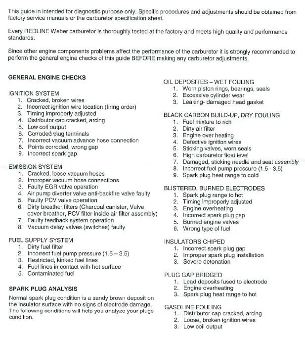

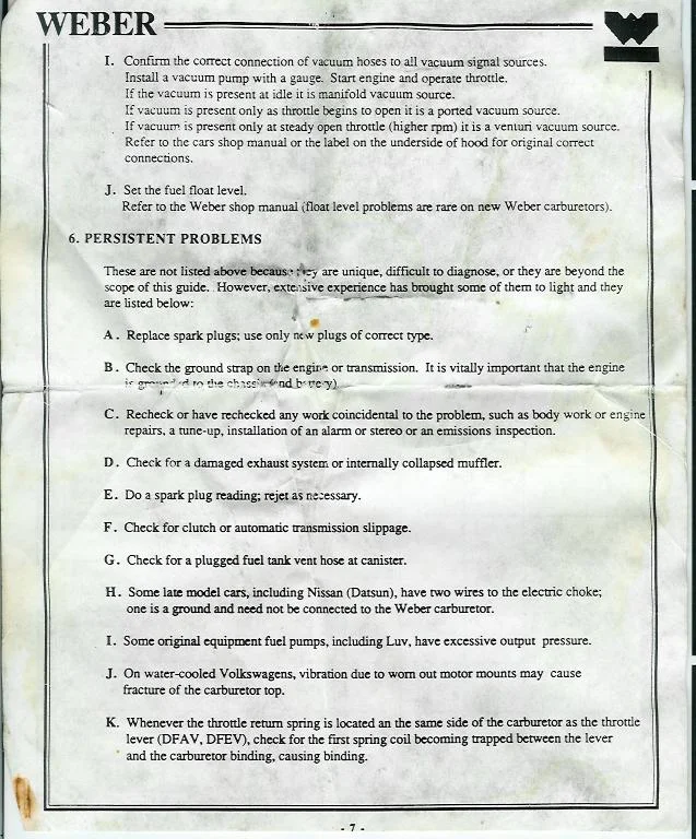

weber trouble shooting
Old 03-29-08, 02:23 PM   #15 (permalink)
450,000+ mile club
Join Date: Jun 2005
TLCA# 2231
Posts: 4,835
weber carb trouble shooting

some more weber literature....it was in my tool box....alil dirty sorry
Old 05-02-08, 09:06 PM   #28 (permalink)
450,000+ mile club
Join Date: Jun 2005
TLCA# 2231
Posts: 4,835
pg 4,5,6
Old 05-02-08, 09:07 PM   #29 (permalink)
450,000+ mile club
Join Date: Jun 2005
TLCA# 2231
Posts: 4,835
last two pg's...hope these can come to good use for ya weber users
