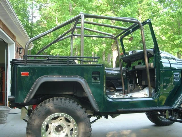

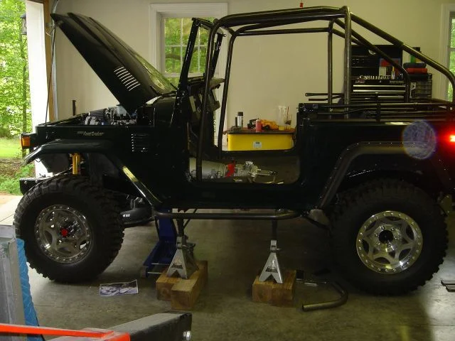

Ok... when the cage gets powder coated, the bezel will get white too.
Nobody jumped on the old cage design, so I cut the front off, re-used the "B" and "C" components, and rebuilt the "A" section. I didn't like the first design because when you tilted the windshield down, the "A" bars appeared to be completely vertical. Last week's ROTW gave me the ide to rake the "A" bars back, but not as canted as the windshield. When done at 15 degrees, it put the "A" components too far away from the actual windshield.
Remember, I wanted complete protection for front seat occupants, the ability to fold back the soft top hoops without removial, and a good platform for a bikini that would still run water off. Oh, and it needed to fit with the full doors, padded dash, and still need access to the knobs to drop the windshield. Oh, and it needed to look "different" too.

The one thing that cannot be seen from the diagrams or shot is a stringer below the belt line that goes from the "B" hoop to the rear mounting points. "A" and "B" floor mounts will be frame attachments, but not "C".
Edit: fixed the diagram above to indicate additional stringers. (pictured in blue... purple.... not sure what that color is)

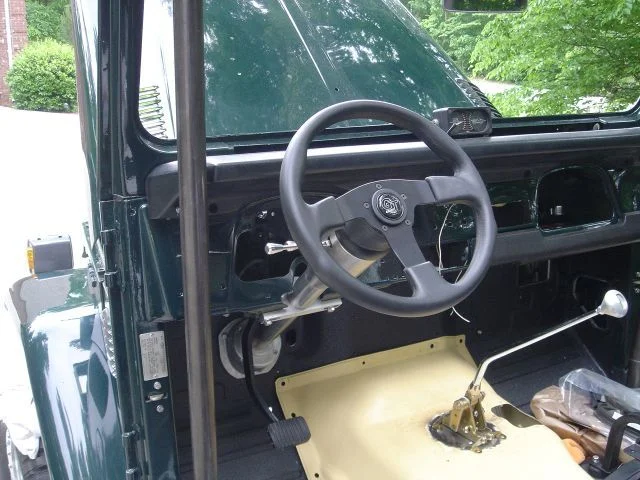

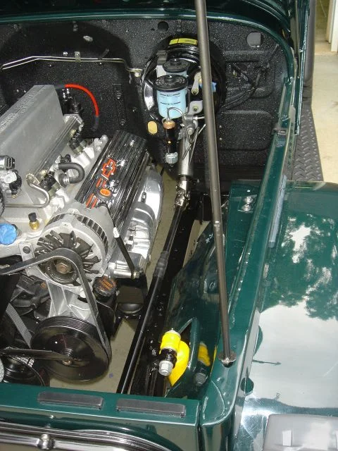

Installed the Flaming River tilt column and steering parts today. It's tough to see, but I chopped the left AA motor mount for clearance. The column clears it, and the frame, by about a half inch each.
Whew.....

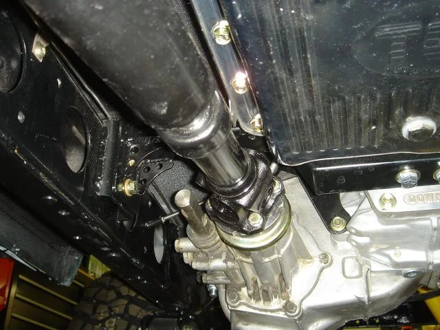

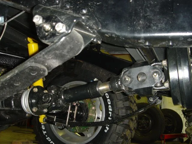

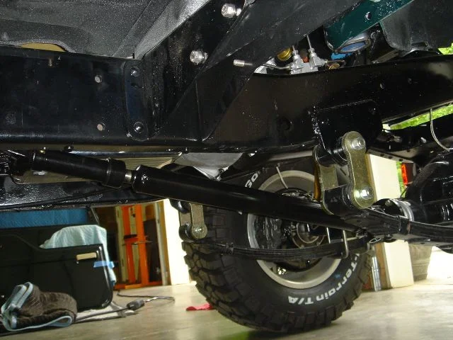

The other thing that I finally got sorted out was the driveshaft issues.
Rear - 18 inch CV shaft.
I had flipped the rear leafsprings to give us three additional inches for the rear shaft. We also cut the spring perches off and rewelded them to (hopefully) correct any driveline vibrations. It's interesting that we got so close, as we preloaded the springs with ratchet straps without a body installed (or any clue of it's final resting height).
Front shaft - 36.5 inches with the AA transfer case yoke to clear the 700-R4 pan.

Which Flaming river column did you get. Do you have the part number? I was planning on getting one for mine too. Were the mounts part of a kit that came with it or did you get those seperately?

The column was a p/n FR20006, 32 inch tilt column that has a 2 inch diameter. I also ordered a mount (FR20114) for the dashboard location. The firewall mount came from BTB. (I think AA also sells them)
Who did the driveshafts??
I had big struggles with the driveshaft shop that I used. We'd talk on the phone, exchange emails, and what would arrive was something completely different. I can't count the number of times I went out there, crawled under the truck, took digital pictures, made measurements, etc. I ended up having to send both shafts back at least once.
