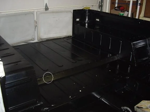

Well not enough progress to warrant pics just yet but Ugly Betty (the Florida version) is officially a frame up restore now. The body is up on sawhorses and 4x4s--Thanks to the posts and ideas I got for accomplishing that without any helpers.
I had done a lot of reading on mud about POR15 and RUST BULLET and well there's a lot of differing opinions so I thought I'd just post my impressions having used both now.

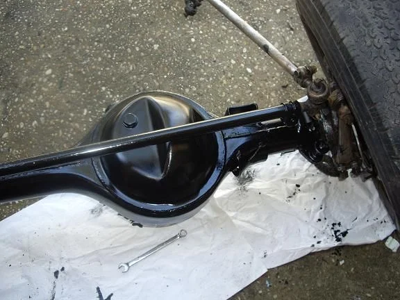

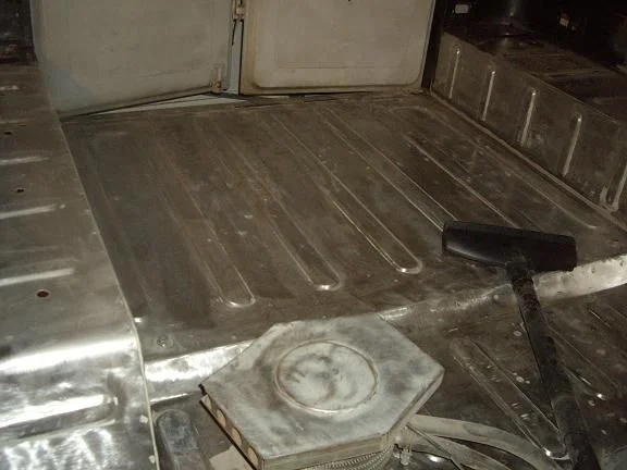

I used POR on my diffs front and rear and in the tub interior. I did some reading and decided to try some rust bullet for the frame.
POR-15
POR-15 was extremely satisfying to apply after the intensive prep. In the tub I rolled it followed by a foam brush using the roll and tip method. In tight areas I just used the foam brush. It flows out nicely and by the time it sets it looks like it was sprayed! On the Diffs it filled the rough cast metal and almost looked like plasti-coat.
It doesn't clump up around bolts or seams and spoil the crisp edges but it fills small imperfections nicely. Because of the peeling effect I would cut out with a razor and area needing touch up to keep from going farther than planned--It may cure harder over time. (I peeled some off after spilling stripper on it)
I made sure everything was spotless to the point of wearing gloves when touching metal. The product literature stresses prep, but who knows if it is really that fussy? The finish makes you step back and say wow! I'm a sucker for a nice finish even on things I won't ever see!
It seemed a shame to cover it with Chassis Coat but it is not UV stable and to use other top coats you must use their TIE COAT primer although I suspect there are suitable subs that are the same thing. The chassis coat is a nice subtle satin.
POR-15 does not store well once you open the can. I put plastic over the can then installed the lid but later with the top all gooked up I used a rubber glove and the fumes ate a hole in them! Buy small cans just in case to limit waste. It thinned okay with acetone or mek for cleanup and acetone will clean it up if you act quick. You will wear POR 15 for a week looking like dirty super glue on your skin if you let if dry.

I think all the points on prep are correct and boy was my axle prepped! And I used all the POR materials and even wore gloves to touch the metal.
The thing was that I spilled polyurethane stripper on it and that caused the problem. I wiped it off and there were bits sticking up that I pulled and it peeled a little off.
Im still confident in the por 15 though I feel it is slightly less tough than the rust bullet--just my impression, but I wont be pouring stripper on it to test the theory--sorry!
Here's some pics of the POR it does look nice going on! I'll post some of the rust bullet on the frame when I get some more progress
