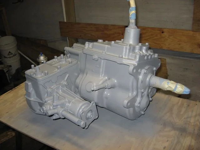

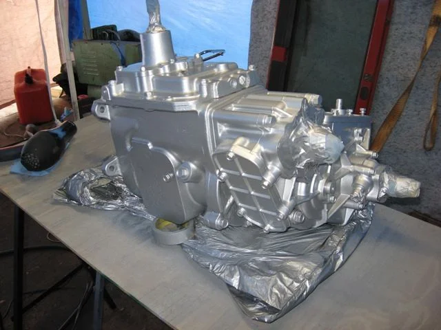

primer.. and paint

Looking very good ! Congrats

I just took a look at your bare tranny and t-case before you primed it and I must say You put some work into the hard to reach spots!!!! Your rear discs went together nice also. I need to order my brackets up so i can mount some calipers..... Oh and wow that rust on the frame was weird!
Great job!!

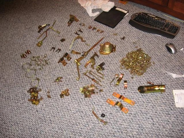

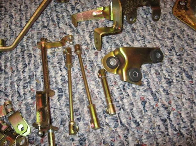

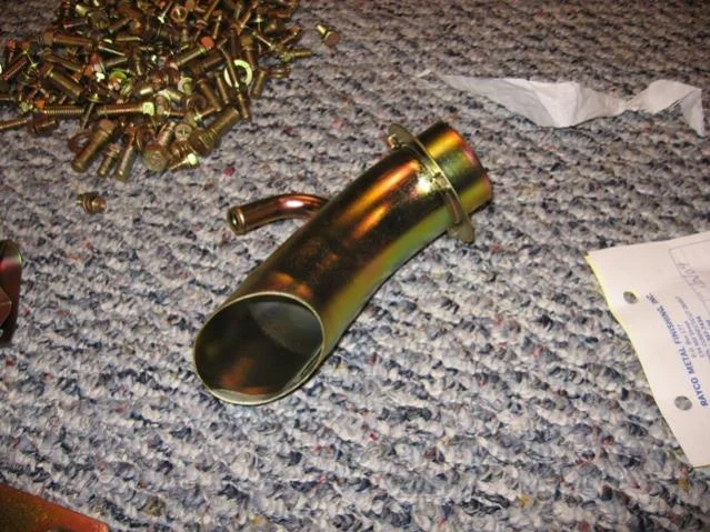

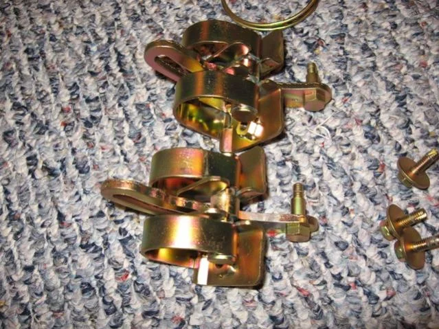

well got the bearing out.. using the slide hammer and pilot bearing puller from autozone it popped right out after a couple of slams with the hammer. got the clutch installed but cant go any further.. mainly because now i can't get the throwout bearing off of the hub and because I don't have the little clips that hold the fork to the hub but those have been ordered and are on their way.
also picked up what i brought to my local metal finishing company. they did a pretty good job on most things - the problem was that they wern't extremely clean in some cases.. esp with the bolts. He had to send the stuff out to his friend in hartford to be blasted (that cost $75) and then he charged me $250 for all of the plating. I'm not sure if that is reasonable but I sure am happy with all of the stuff I got back!! porn is below...
aside: next time I will blast the parts before i bring them.. that is definitely something i can do myself to get rid of that extra charge

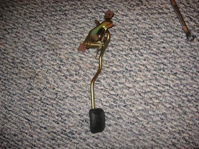

Posts: 1,040
two more.. the filler neck and the gas pedal came out really well.

Now that is sweet! Those parts though they were fairly expensive are really going to make the difference on the project. I had a 78 ford short bed f150 that was as straight as a 2008 honda accord with sweet paint but it never really came together because of the little bits and pieces just stood out with the body being so crazy........... Of course they looked great before the paint!!

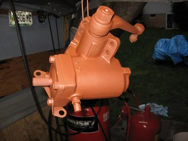

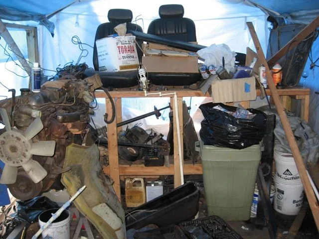

well i'm back. and i don't have to work until nov so its crunch time to get the cruiser done.. bsmith sent me some parts while i was away at school - here is a pic of the alternator i got... i'm a little worried because i don't think the belt is going to be tight enough.. i had to put the pully from my old alt on the new one. thanks again bill!
started taking apart all the steering/linkages - I'm keeping manual steering for now.. just gonna clean up the box and put new oil in it.. rebuilding the centerarm and the drag link as well as replacing the tie rod ends with 555 ends. also the main tie rod i have is bent... and i can't get the old ends out of it.. so i'm just going to suck it up and get the one that man-a-fre sells.
also had to clean up my mess from the winter...

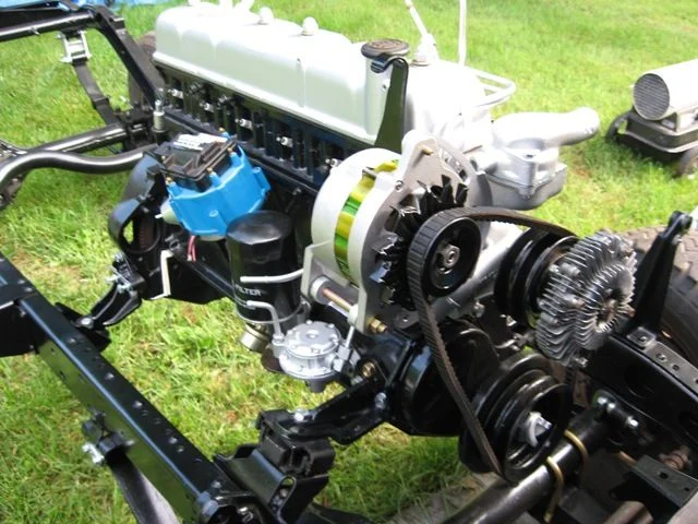

Got the hinges thanks! In the nick of time-the truck showed up today out of the blue to pick it up--had me scrambling to throw parts in it and tie up loose ends! He was supposed to call 48 hrs ahead two weeks from now!
Is that the new antenator on you motor?
thats the one! the thing is beastly compared to the stock alternator! looks great too
glad everything worked out for your truck.. i hope it makes it safely to the UK

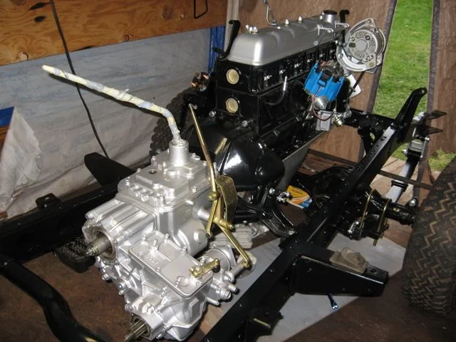

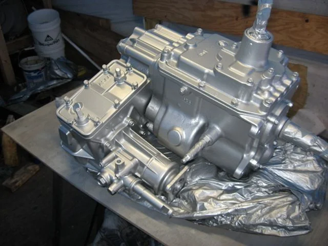

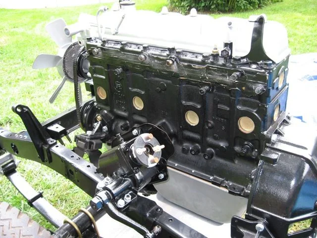

wow. been a while since i updated - got that drag link apart.. cold chisel and a impact gun did the trick! its been raining like crazy the last week or so.. so i've been busy doing things indoors.
-got some stuff painted up
- cleaned both my parts room and my shed like crazy to get ready for when i start to do body work
- restored my knobs and switches
- broke a bolt off while installing the oil pan cause im a tard.. drilled it out with the help of my uncle... it was an off center drill.. used some stripped thread repair shit and seems to have done the trick the bolt went in nice and tight.. we'll see if it leaks :/ put in rotella 20W-40
- installed steering box and center arm casing
- bought a shit ton of parts from SOR - they should be here on tuesday
- installed the transmission and transfercase! the pins on the clutch fork to throwout bearning assembly were a bitch!
this week:
-bring the body and panels to the blaster quoted $1200.. ouch.. but worth it.. they body is in great shape as far as new england steel tubs go but there is a lot of stuff i can't see.. like fiberglass and bondo so i need to know what i'm working with. I don't have the facility to get it primed so i'm gonna have MAACO or someone like that give it a couple coats of primer.
-knuckle rebuilds
and. the pics.
__________________
Oct '76 FJ40 (used to be) used for parts
78' FJ40 in progress - body '77 converted to '78, '78 engine, '78 wiring harness and switches, 4 wheel disk, '68 bib, Ehsan Khaki Soft Top, half doors with khaki uppers, rear half doors with khaki uppers
'84 S-10 - '94 S-10 blazer leather interior, 3" hocky puck lift
antFJ is online now   Reply With Quote

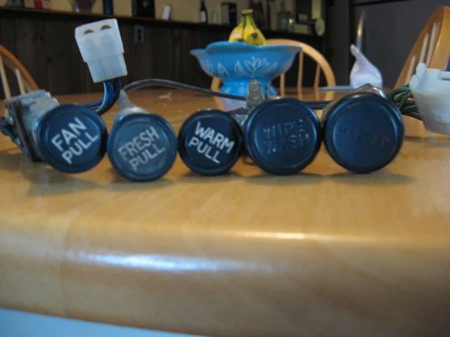

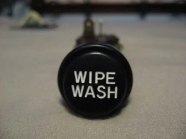

Posts: 1,040

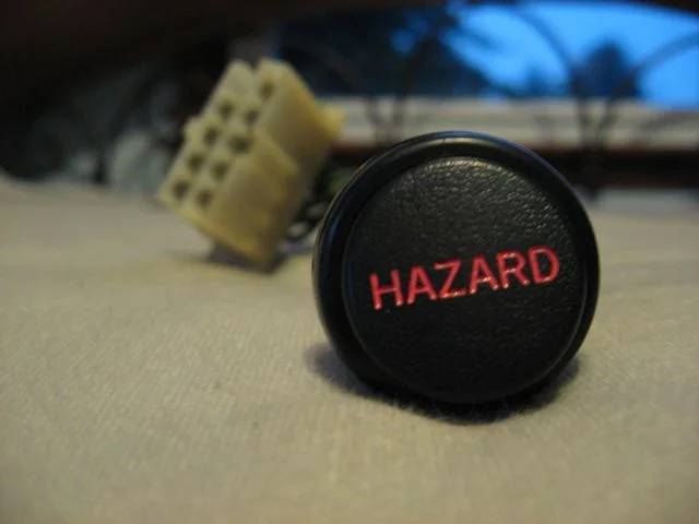

the knobs. the before and after

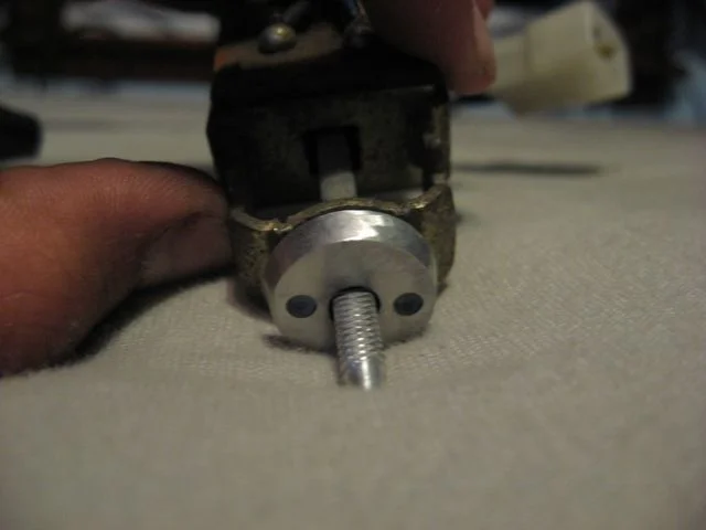

Posts: 1,040
also shined up the backs with my dremel
