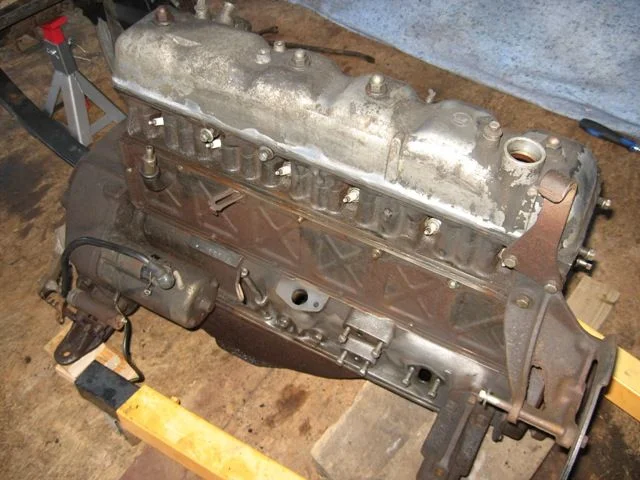

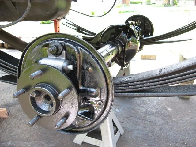

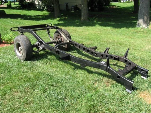

sooo much progresss!!! the pics will tell the story...

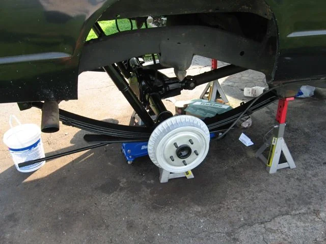

finally got to finishing taking the frame/suspension/axles apart..
but first i had to get the driveline off.. sold the tranny/transfercase to a great guy named Jim.. he along with my father and my neighbor helped me get everything off.. safely..

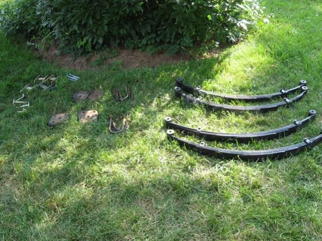

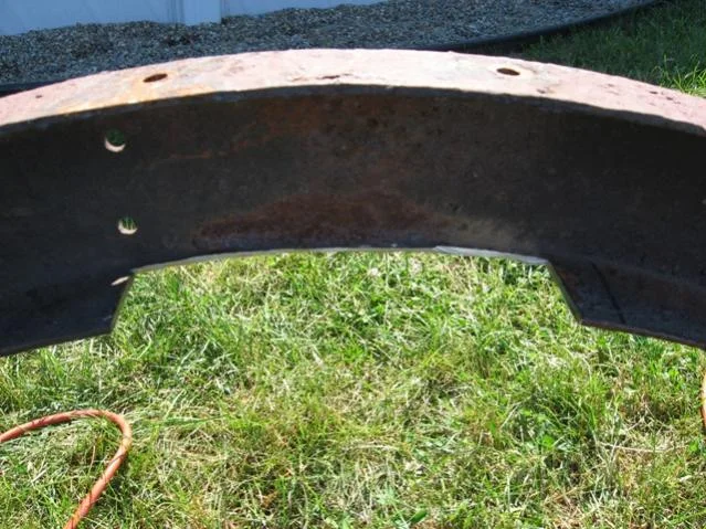

probably just going to blast the springs and paint them as packs.. they are bran new and only have a little bit of rust from sitting for a couple of years..

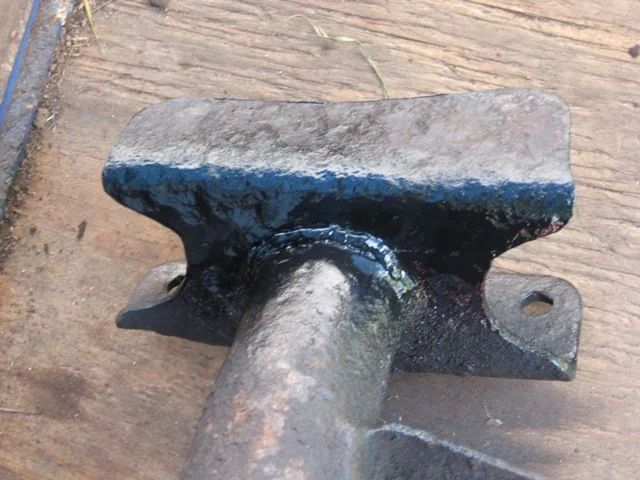

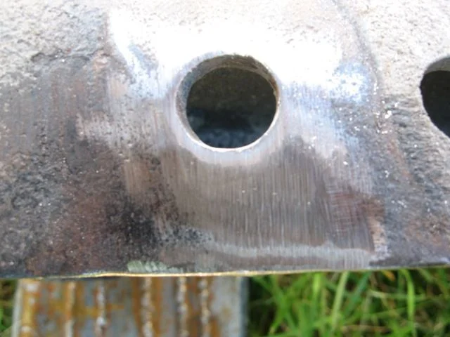

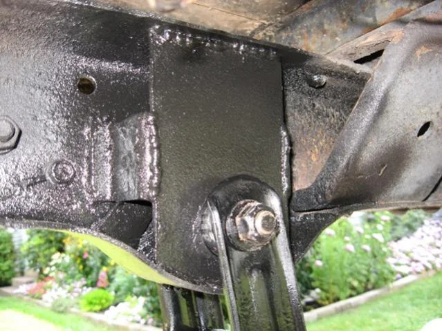

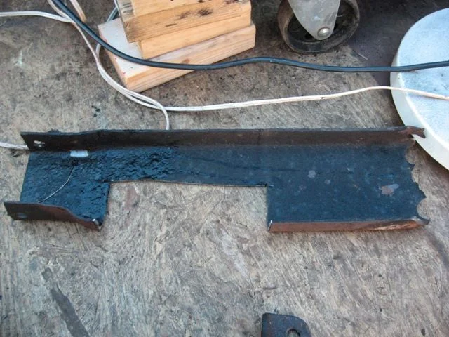

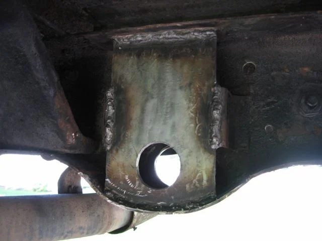

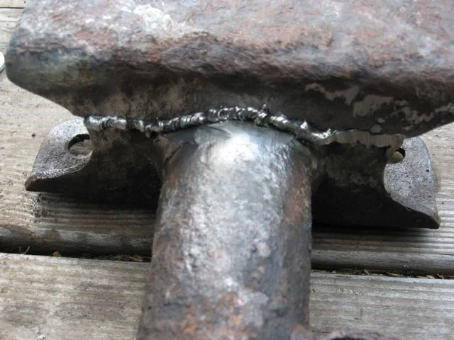

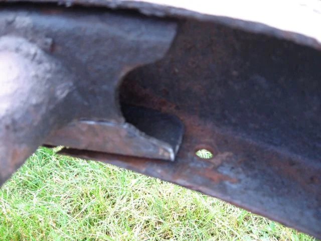

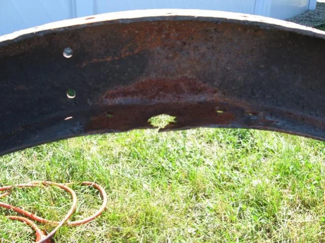

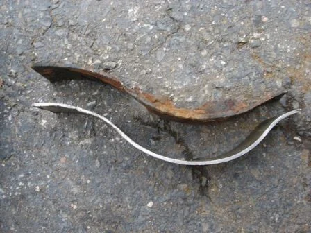

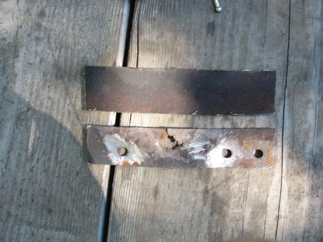

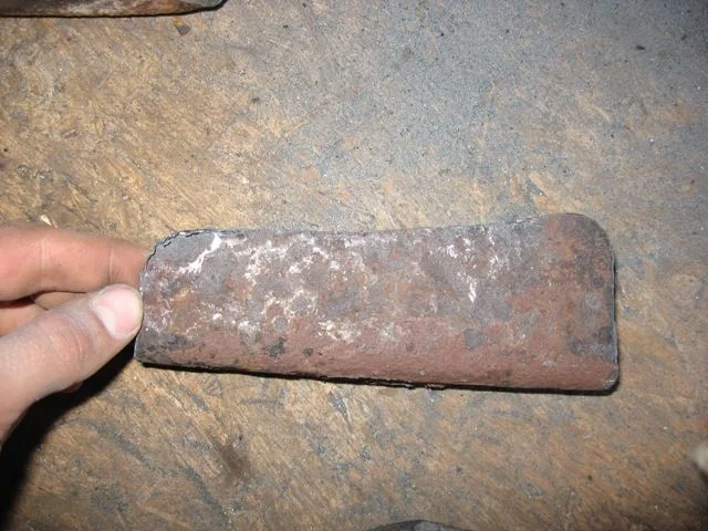

now for the fun part... i got my welder in..
it's a lincoln 140C.. i know i know.. its not a 220 but it served me well.. and it was a ton of fun. this is the work I did on the frame.. please criticize anything you think is not right..

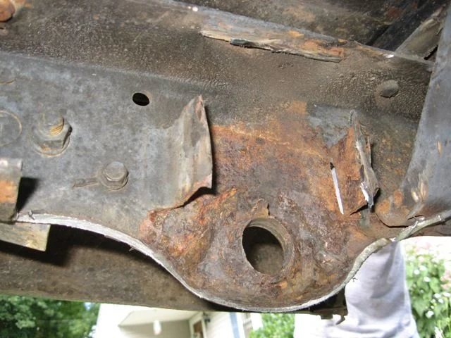

here i'm fixing the upper shock mount crossmember.. one of it's tabs was completely rusted out.. cut a basic shape from a scrap piece of frame i have.. beat it with a hammer to get the curve.. then ground it to the right shape..

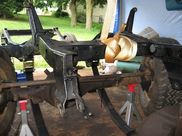

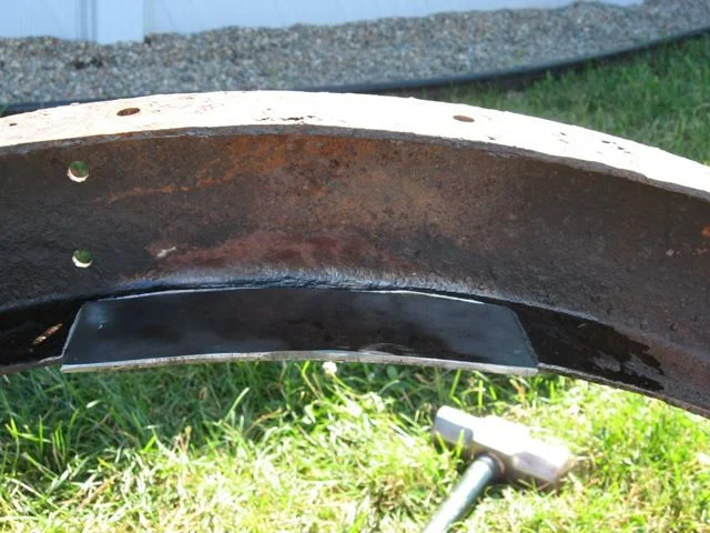

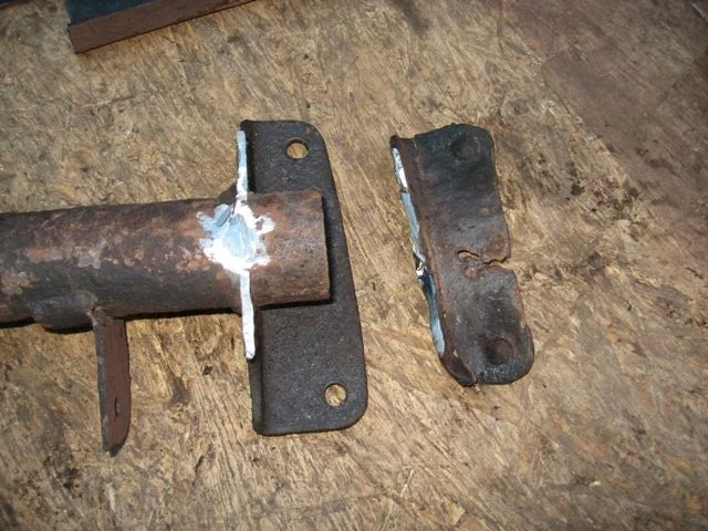

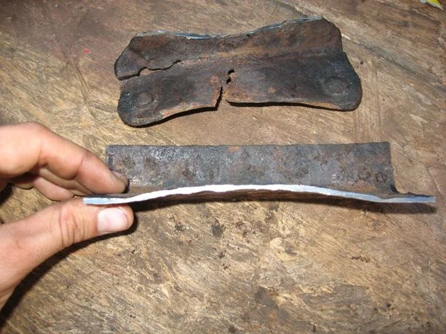

and the rest...

and..

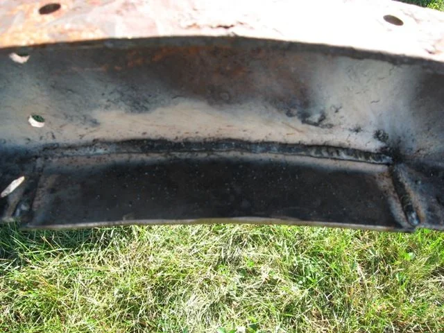

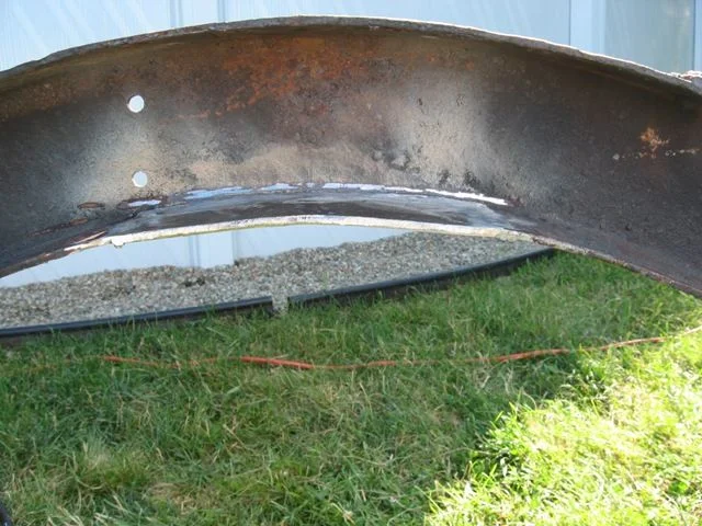

all of the welds were done on both sides and ground down so that they weren't visible... should be strong enough right?

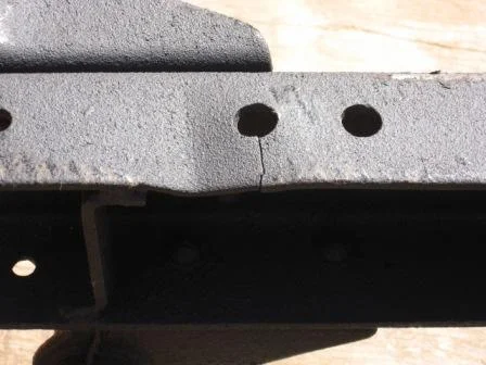

and.. now a question.. now that i've repaired the crossmember and the frame.. the crossmember won't fit in easily.. i wanted to get the frame blasted and powder coated to save me some time and since it will last longer than a rustoleom paint job, but i had wanted to do the crossmember separate since it is already apart - if i do that i'm worried i will scratch the powder coat trying to get the crossmember back in... so my question is do you think it will be alright if i bolt in the the crossmember and get it powder coated bolted in? I think it's my only option but just wanted to get some other opinions..
oh and the concert was awesome... went to see mindless self indulgence at the webster in hartford (never heard/seen them before) and they were pretty darn good.. damn i love the mash pit..

If it is bolted in and then powder coated you should be fine. I might spray some weld through primer in there before you reinstall it, but more than likely the powder will seal between the crossmember and the frame a little bit (not THAT well though).
I really don't think you can go wrong wither way, but if you choose to install them after powder coating them separately the powder should still be flexible enough that maybe it won't scratch too much. You could also use a little soapy water to help lubricate things as they go back together.
Really I don't think it matters much. I've done both ways, and been happy with both. I won't powder coat stuff apart that is pretty close tolerance though, as then you end up sanding the powder off anyway, which sort of negates the benefits of powder coating it separately in the first place.

Dan - yea thats what I was thinking about doing.. thanks for the confirmation on that.. i just don't want moisture to get trapped like what happened in the first place. I'll probably do the primer and then get it all together.

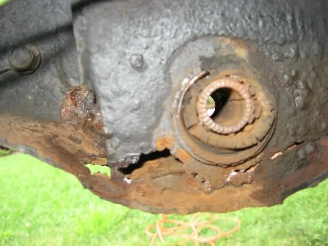

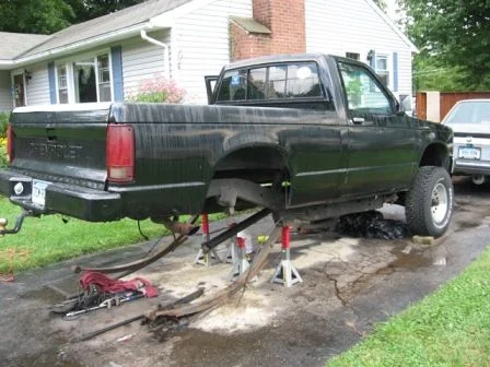

well. i'm back for colorado and so far not too much progress..
colorado was sweet though - got to see some nuclear launch facilities and silos (saw the silos from a distance) and got to see where they make the atlas rockets which send satellites into space - good times. also glad i didn't go to the academy got some pics down below... a picture of the chapel.. a view from eagle's peak (9200 ft) and one of a restored plane (yea i forgot what it is.. P-47?) at the Peterson AFB museum.. it was restored by all volunteers.. quite and amazing job.
as for the cruiser.. my frame is almost ready to go to the powder coater.. but i still have 4 broken bolts i need to drill out.. my drill bits went dull yesterday so i couldn't finish.. it took like 3 hours to do 8 bolts.. so i said screw that and started working on my front axle - drilled out the broken shock mount bolts and got some generic ones from napa that will bolt right in.. i was going to weld them but they seem really strong just bolted in.....

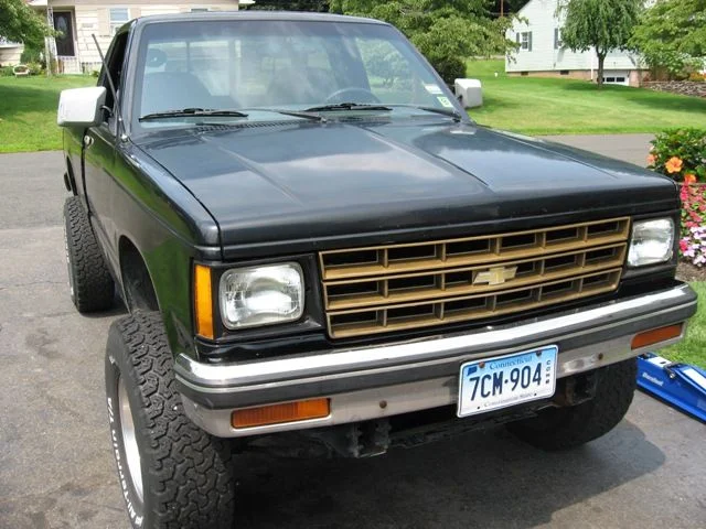

then on the way back from napa my s-10 started making some wicked loud clunking noises. and it started raining when i got home so i quickly got out.. shook the driveshaft and it seemed really lose i drove my mom to work today and took her car to get some u-joints.. replaced those today to find out that wasn't it!! although they were wicked lose - next thing (under some advice of a local mechanic) i took off the rear diff cover to find a bunch of broken teeth and black goo in the rear axle. sweet. so the cruiser is on the back burner - but i thought i would tell my story in case someone here knows of a good axle swap - i don't want to put that same crappy axle back esp if it is going to cost the same amount of money.
My brother has a '93 jeep cherokee and his axle has the same lug pattern and is exactly the same width as my axel. the only thing is i don't know what my ratio or his is.. anyone know how to check that out - there isn't as much info on s-10s as there is landcruiser unfortunately. anyways would have pictures of that too but it started raining again now so i'll be sitting here twiddling my thumbs for a bit. any advice would be appreciated.

well this isn't cruiser tech but it is what i was working on all week.. my mom wanted me to trash it but i can't stand to get rid of my S10.. the rear end blew and when taking off the axle to replace it with one from the junkyard i found the rear spring/shackle hangers were toast so it ended up being a lot of work... and then i went overboard with cleaning up the springs/shackles,axle housing and new brakes all around - man it is a lot cheaper than a cruiser (a wheel cylinder only costs $6.00 and the drums auto adjust since i got an axle from a '87
here are some pics - i start back on the cruiser on monday.
PS i sprayed the axle with rustoleum which is good because that is what i wanted to do to my cruiser axles but it is really soft and scratches easily/gets F'd up by brake fluid - are products like rust bullet a lot more resilient or do i just need to let the paint cure for a couple of days? i guess I could just spray it with a clear coat too..

more pics

and the last

amazing what can be done with rusted junk

Good work you are a rust kicking SOB!!! Is all the rust normal for where you live and what the heck is it caused from??? De-icer used for winter maintenance on the highways maybe??? Do you live in a snow zone??? Anyways glad you are back on the 40! I did read a post where someone said that brakefluid didnt eat their POR/RB i dont remember which. Just think it could be worse i spent the last week working on that little 4 wheeler you see in some of my posts.... And my XJ (jeep cherokee) BEES BEES BEES from not driving it for a few months just so i can think about fixing it!!!

Quote:
yea rust is pretty common up here.. esp on older vehicles - no idea what causes it though - i'm sure not having a garage plays into it somewhat - i think where i am they use salt here when they plow which definitely speeds up the rust process, either that or sand which has somewhat the same effect
haha yea i guess it can always be worse

Quote:
Urea...(ammonium nitrate)..... from what I've been told...... bad shit on metal....
Other wise known in the liquid form as magnesium chloride! I have possibly put some down on the roads in my day and it is claimed to be hardly corrosive but sure that is why the back of the 5 yarder looks like your old frame and all the other 5 yarders looked brand new!! BUT LOOK ON THE BRIGHT SIDE IT'S FISH FRIENDLY

well got the frame to the powder coater finally on my way somewhere...
got the rear axle disassembled and got the drum backing plates off - if anyone wants them the drums/wheel cylinders/shoes and everything look really good - come with lines too.
what was sweet was that i needed to grind the head of two of the bolts for the lower rearmost rivet holes on my rear crossmember because they are so close to the shackle mount.. you might know what i'm talking about - anyways i used the backing plate bolts which sit flush against the mount.. it worked realllly well.
also spent two hours searching parts.. had to go to ACE for some 3/8th hardware for the frame.. i needed a diff cover gasket, diff cover studs, and front/rear pinion seals - of course napa didn't have the diff cover gasket or the rear pinion seal so i headed to toyota - turns out the after market pinion seals are crap compared to toyota. i'll put up pictures later to show the difference. i'm going to put those in tomorrow and start to wirewheel the axles and get them ready for paint.
any suggestions on getting studs in? i read somewhere you can use a small grinder to put a notch in the stud and screw it in with a flat head screwdriver but I'd rather not cut the studs..
