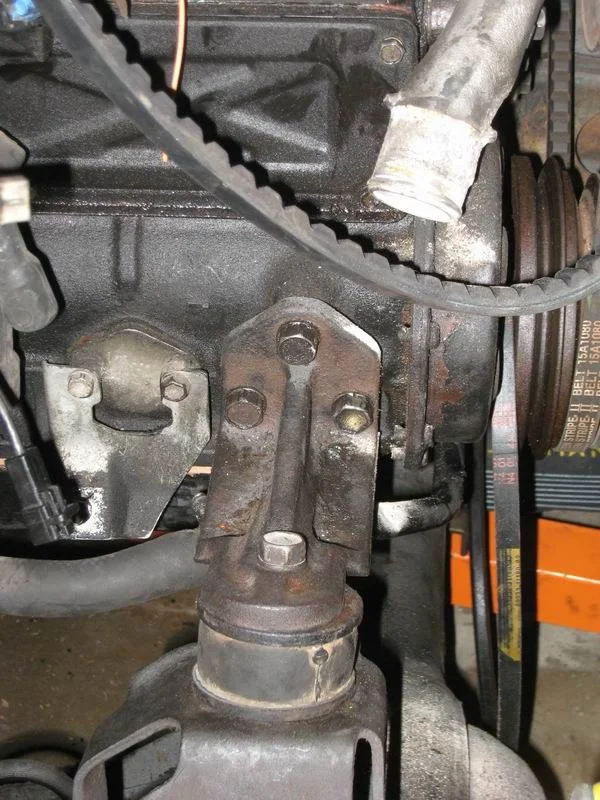

I've got a question about the mounting of the engine... What motor mounts were used? I just mounted mine and I had to use a 2F mount on the passenger side and the round cushions on both sides.
I still seem to have a slight angle with the driver side further to the rear of the truck. Not much but noticeable. I also noticed that two of the fan blades come VERY close to the radiator. My fan shoud hasno hope of fitting. Do you have a fan shoud? There was no problem with brake booster or power sterring box.
I want to use the A/C compressor and I can not do it with theis motor mount. Is there a way to use the original 3FE mount on the passenger side? Here are some pics:

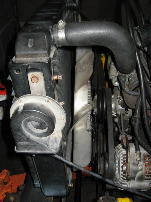

It does have a fan shroud but on the driver side of the rad. It has been cut off. I got in the middle of this one after mmw68 purchased it so I am trying to get the in's and out's down. For the compressor mount I am still looking at that. Probably just use the stock mount/frame, I don't have one laying around. But since there is an offset I will move the frame mounts to try and correct that on the next 3FE. Good looking install so far. I am going to dig in on 68's by wed. for the intake and other stuff so I can get some good pic's of the mounts and other stuff.

What about under the radiator? The 3FE fan is also lower. And, at least on mine, 2 fins of the fan come VERY close to the radiator mount. I may swap in the 2F fan also. It is an inch or so closer to the engine to give me more clearance. I loose the viscous coupling though.

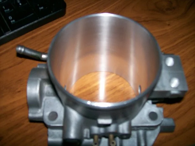

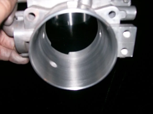

Randy - the TB looks great!!!
