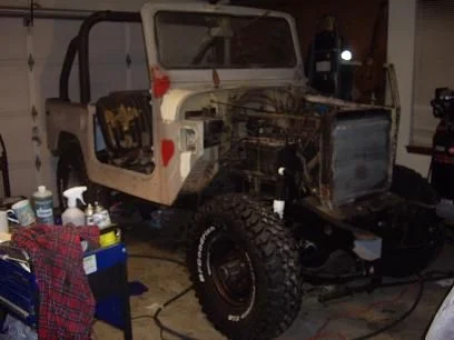

ugly betty
Here's my Project "Ugly Betty" although she looks better now with the lift and BFGs on her. So there are two Ugly Betty's on the board now!

Further?
I don't know about further the body is off now and I'm stripping the frame. At first I was going to do the lift and a fix up but once I saw the metal was in good shape I knew I had to preserve it or watch it rot away so I got to work.
Yours looks pretty good, what plans do you have for it?

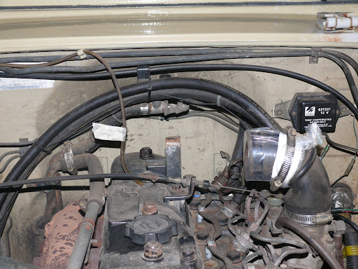

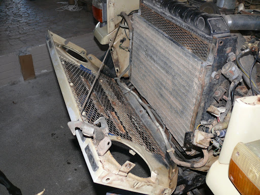

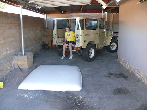

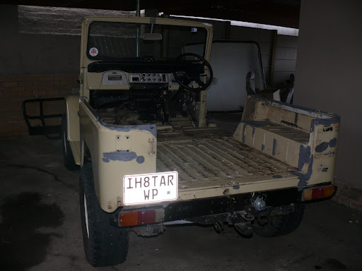

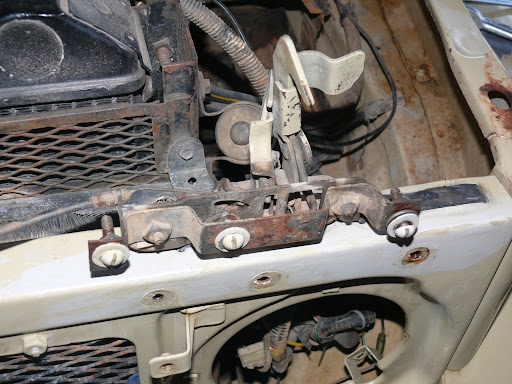

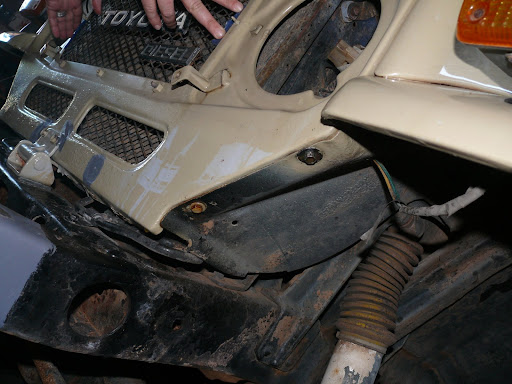

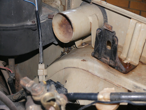

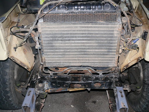

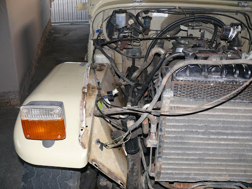

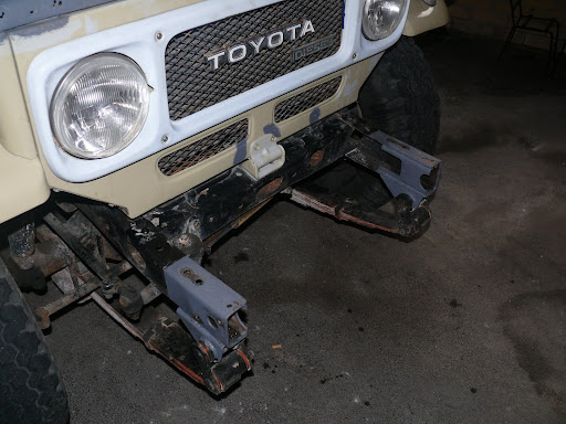

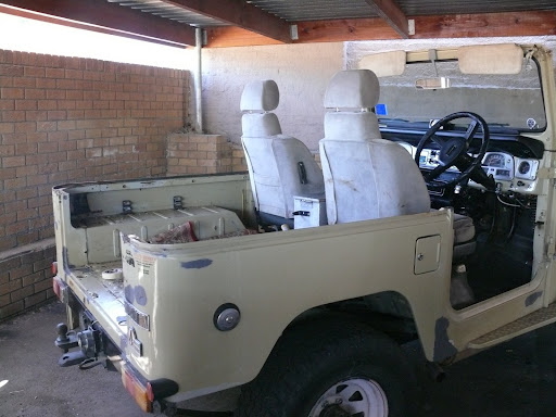

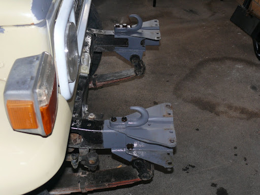

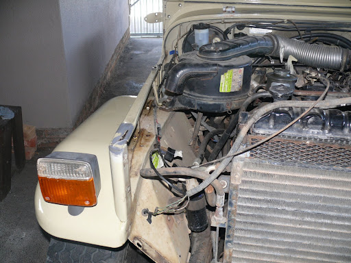

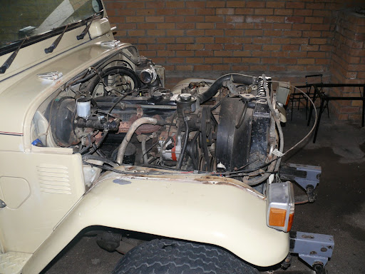

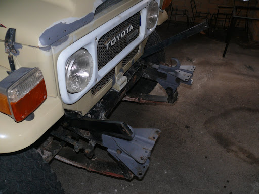

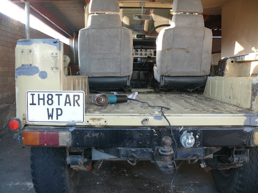

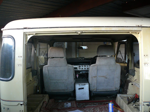

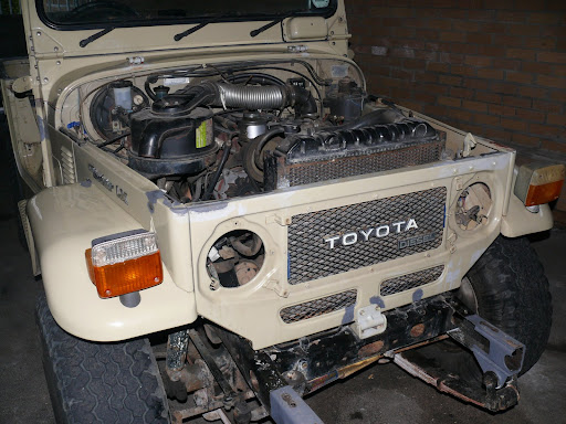

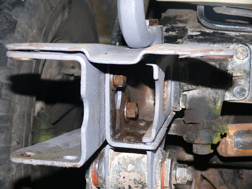

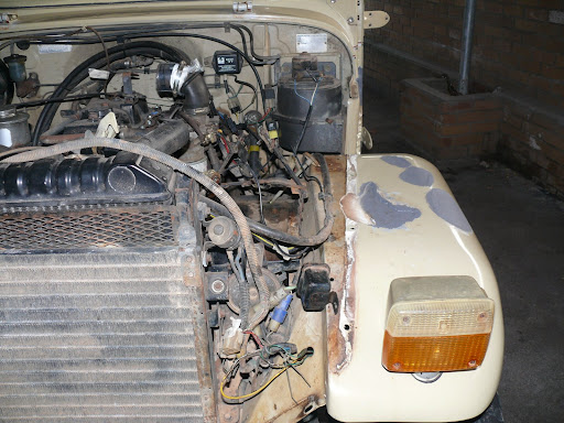

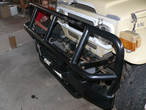

Time for an update as I eventually started stripping her about 2 weeks ago.I know I am going slow but this is a first for me so I take lots of pics and make notes of just about everything. once my shop gets its new lights tomorrow, I should be able to work after dark also.
Perfect fit on the long ranger tank !

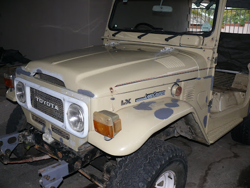

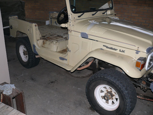

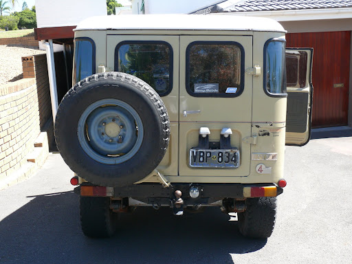

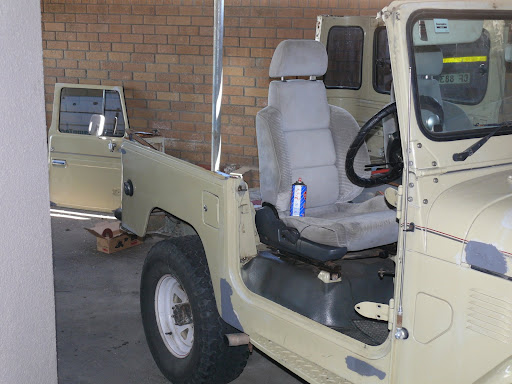

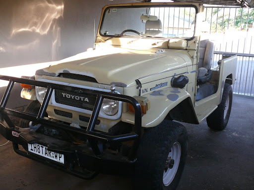

I also got her registered and on the road and for a week I absolutely enjoyed having her topless
But then I finally parked her last weekend...

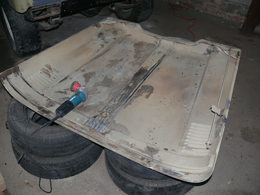

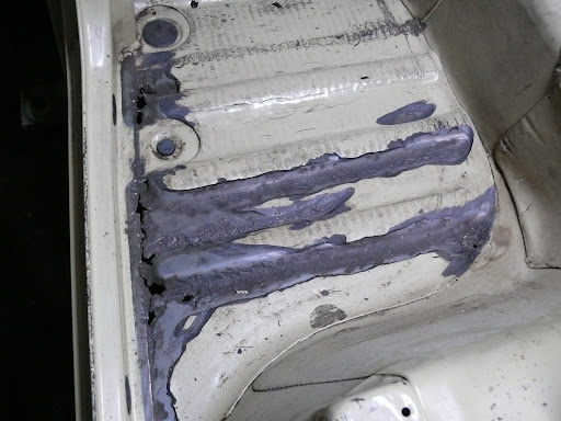

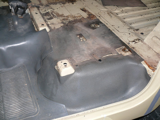

Old 06-05-08, 02:49 PM   #43
IH8MUD Regular
tmarx's Avatar
Join Date: Aug 2005
Location: CAPE TOWN
Posts: 314

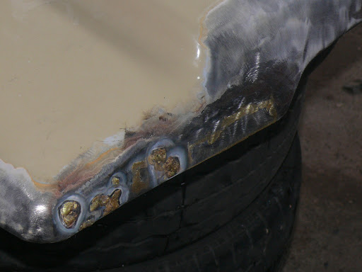

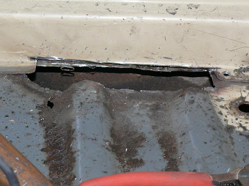

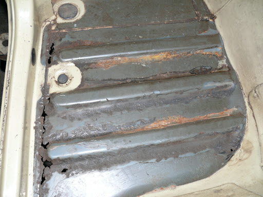

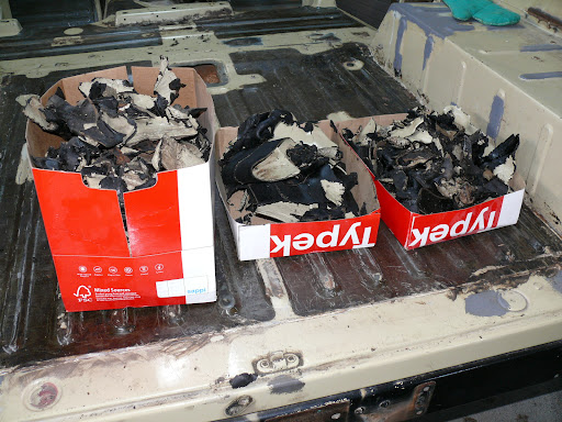

Time for an update.

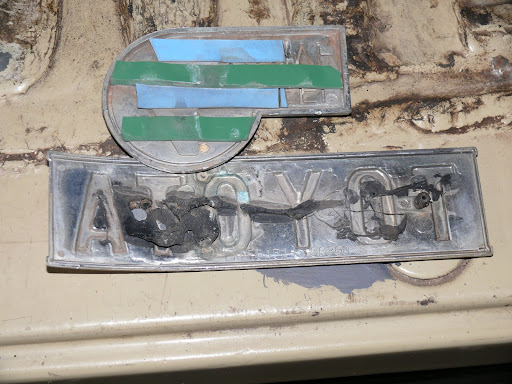

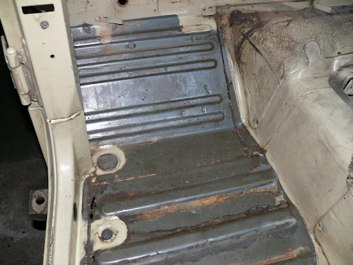

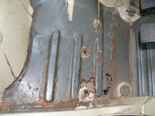

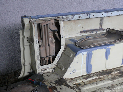

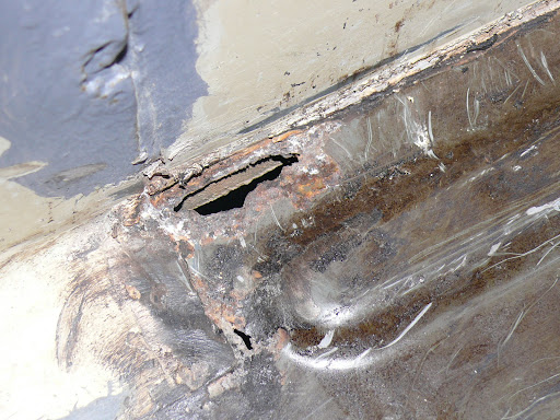

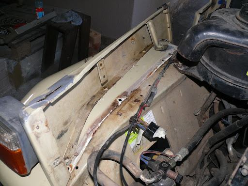

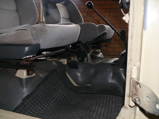

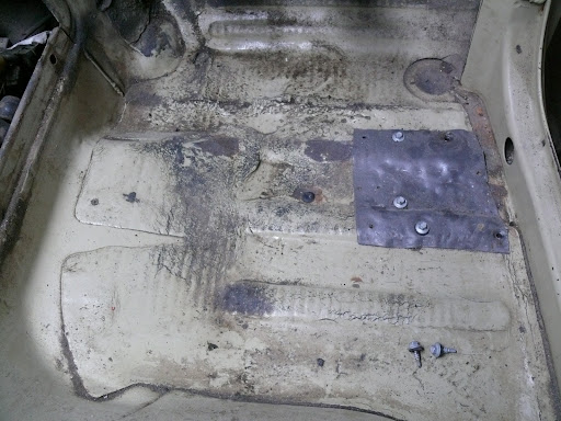

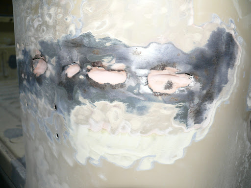

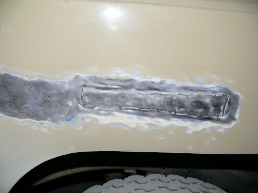

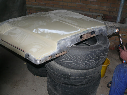

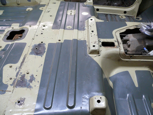

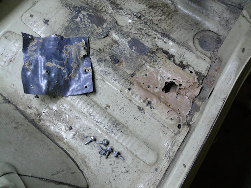

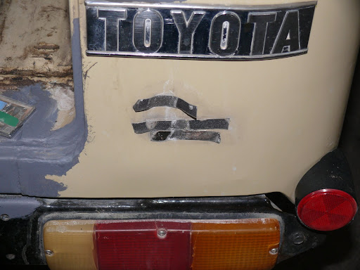

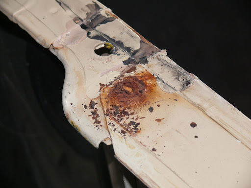

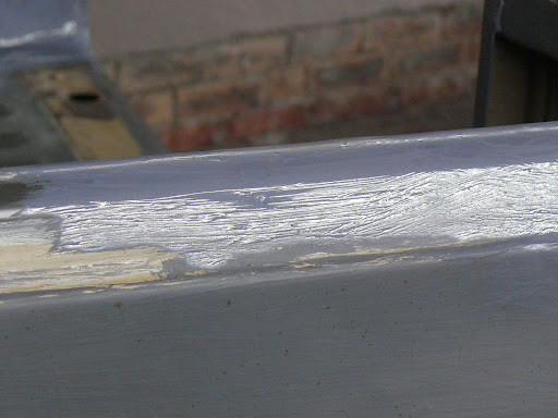

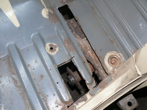

Hidden beneath all the bondo...

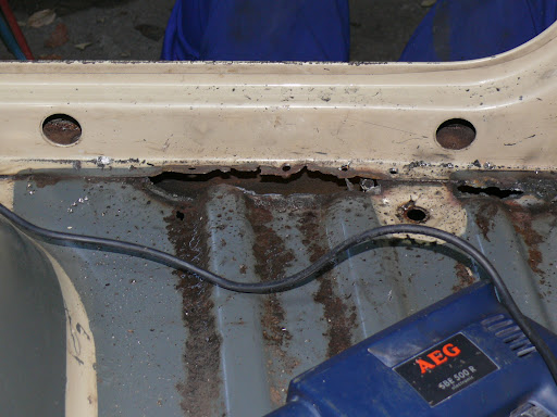

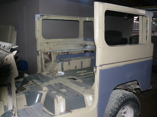

Time to remove the heat & sound matting to see what it might hide..

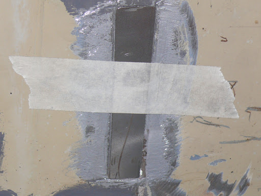

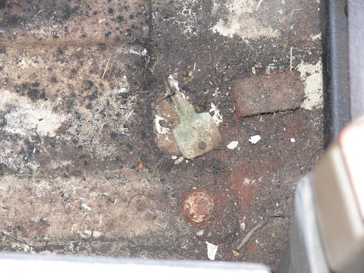

Only this spot in the back

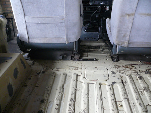

The front floor being a mix of good and bad
__________________
Theo
105 1HZT I/C
BJ 42 LX 11/83 - 3b H55F P/S 3 wipers and slidin windas
tmarx is offline   Reply With Quote
Old 06-05-08, 02:53 PM   #44
IH8MUD Regular
tmarx's Avatar
Join Date: Aug 2005
Location: CAPE TOWN
Posts: 314

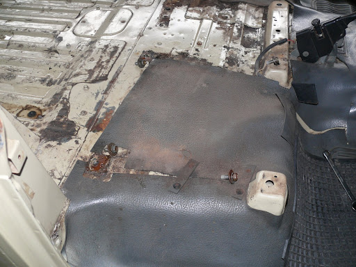

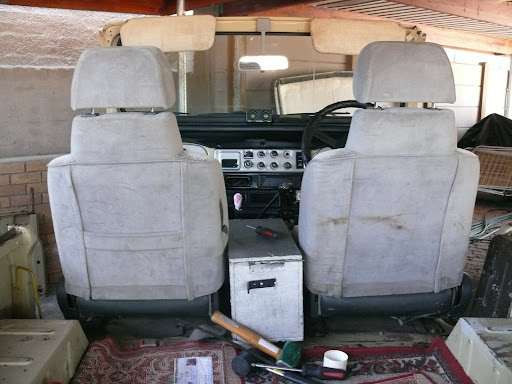

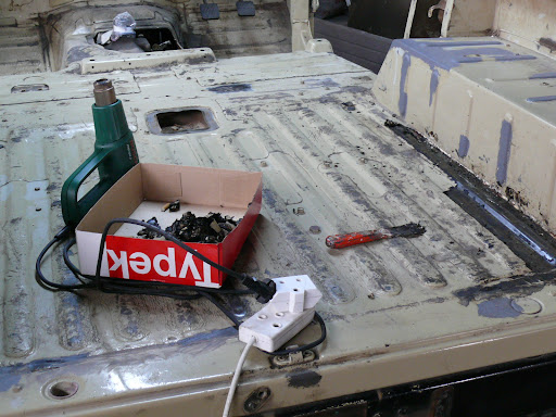

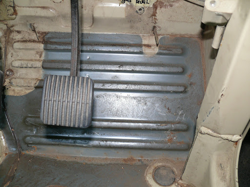

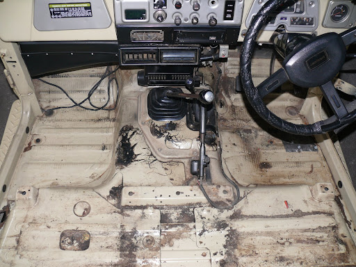

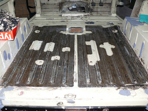

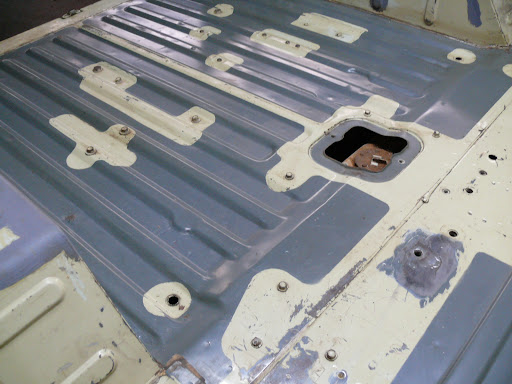

The total amount of sound and heat matting removed
Then after countless hours to remove the sticky residue she now looks like this.
__________________
Theo
105 1HZT I/C

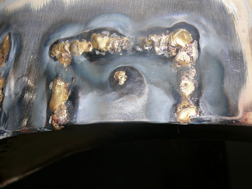

Old 06-05-08, 03:05 PM   #45
IH8MUD Regular
tmarx's Avatar
Join Date: Aug 2005
Location: CAPE TOWN
Posts: 314

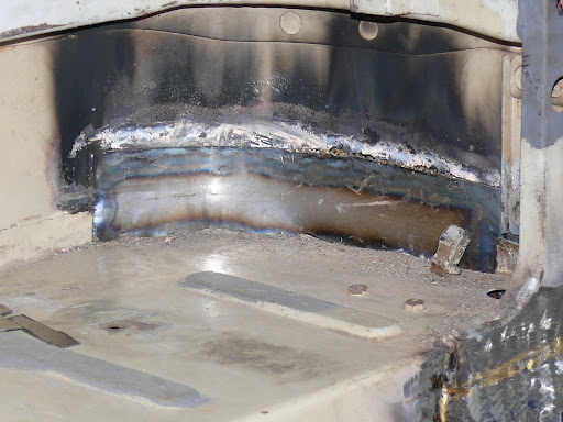

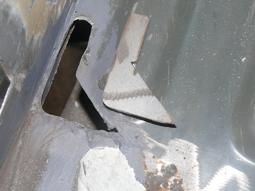

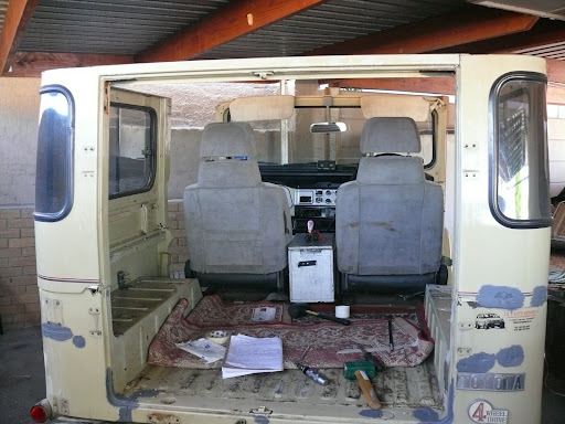

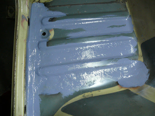

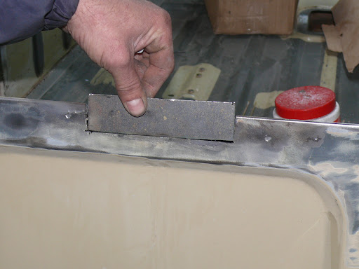

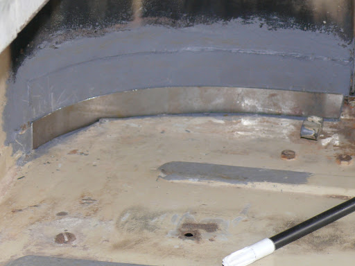

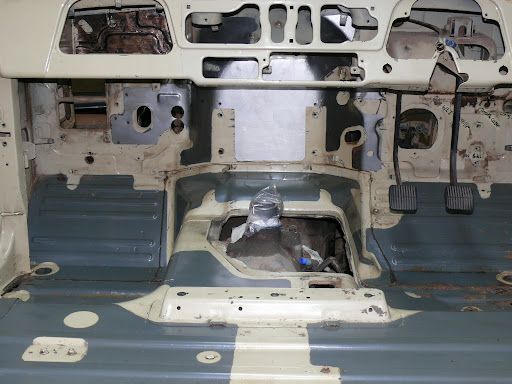

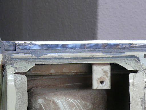

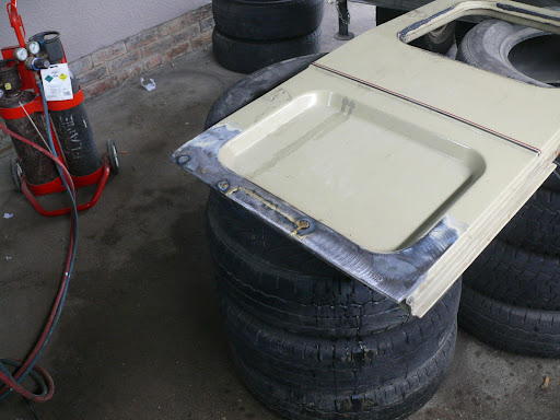

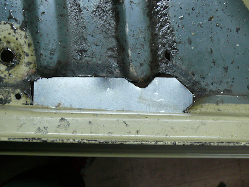

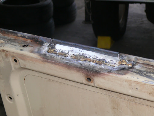

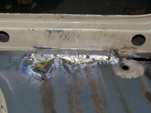

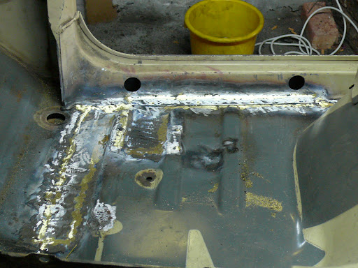

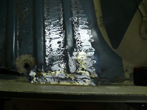

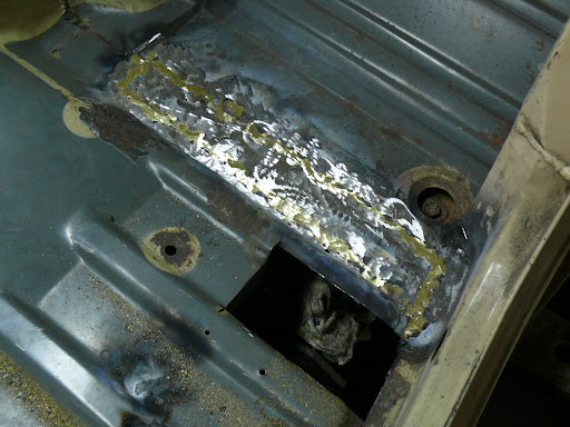

New floor piece shaped and fitted all the way into the sill.
new lip fitted above the floor piece
From the bottom
__________________
Theo
105 1HZT I/C
Old 06-05-08, 03:15 PM   #46
IH8MUD Regular
tmarx's Avatar
Join Date: Aug 2005
Location: CAPE TOWN
Posts: 314

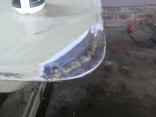

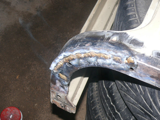

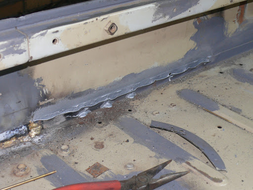

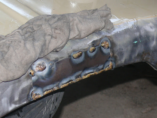

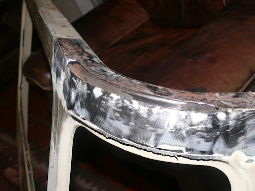

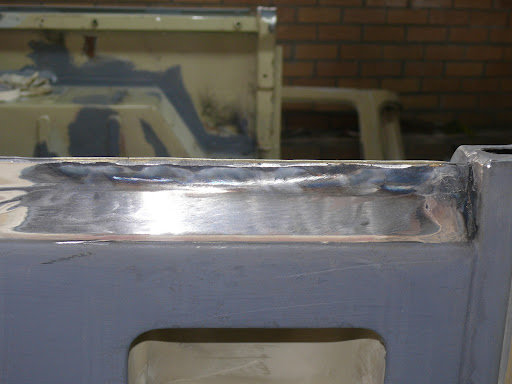

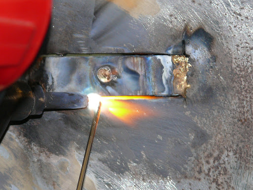

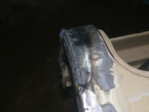

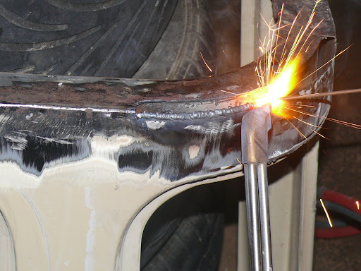

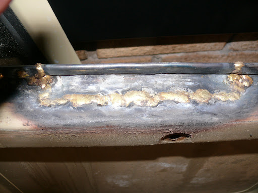

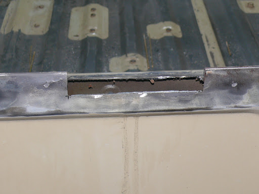

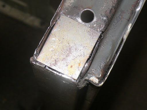

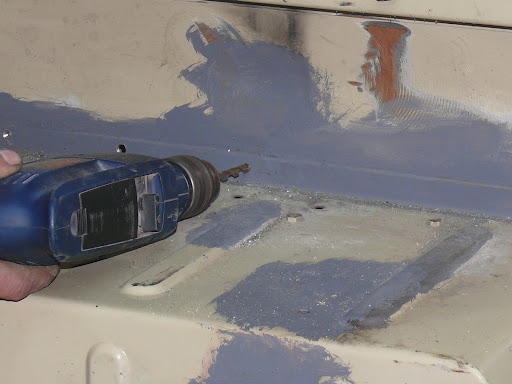

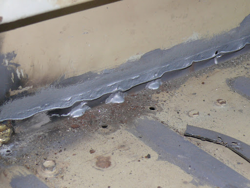

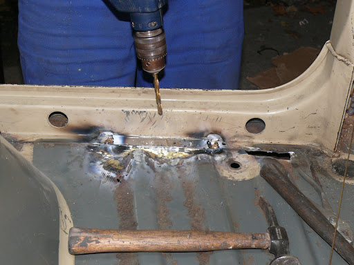

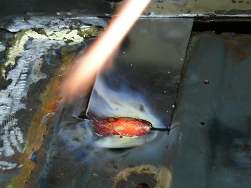

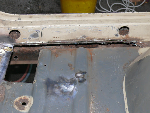

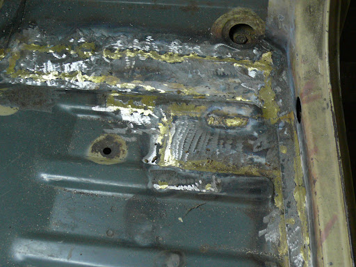

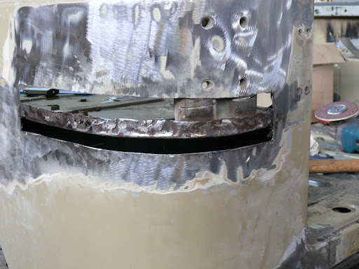

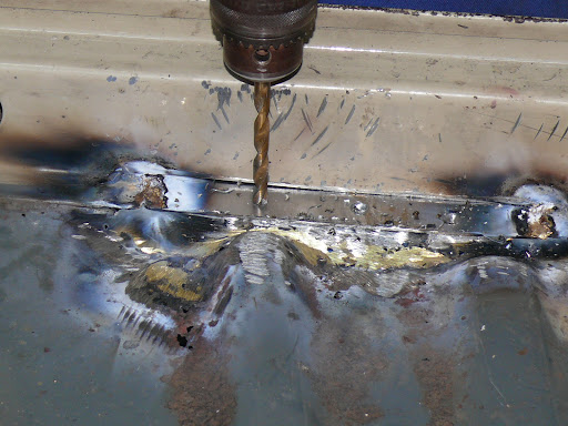

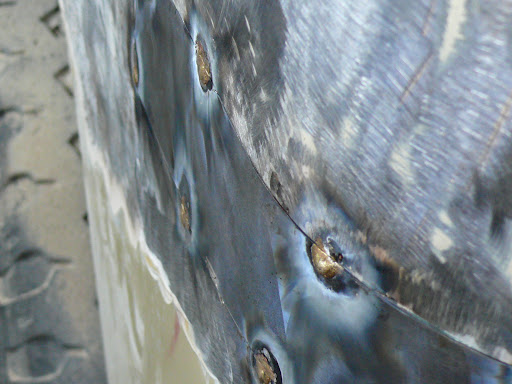

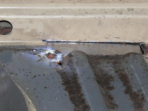

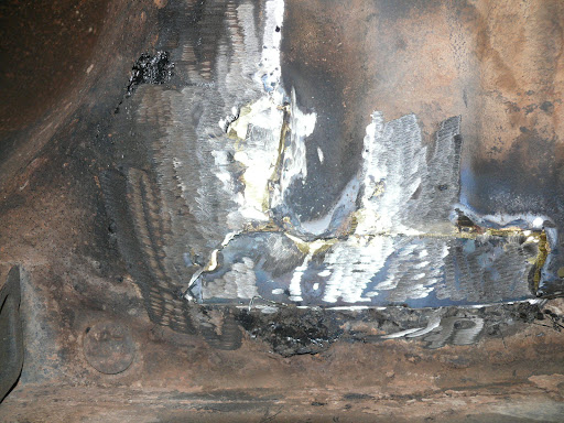

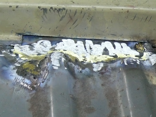

Rough grinded, etched cleaned & temporarily painted with NS4 untill the Rustbullet Silver Label arrives...

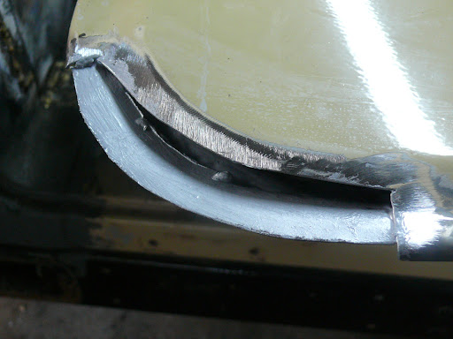

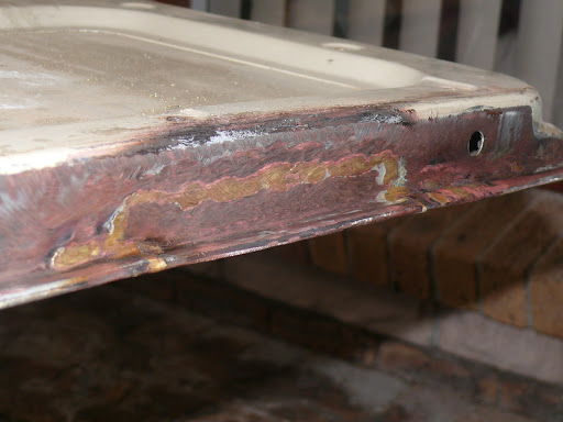

Once again the whole seam is opened and a new lip made to replace the old. NO SHORT-CUTS !
New lip to replace the old which was covered with Rust Bullet on the inside before being welded in, just like all the other closed areas..
Seams that are too good to be cut out are drilled open and painted with Rust Bullet on the inside before being closed up and spotwelded again.
__________________
Theo
105 1HZT I/C

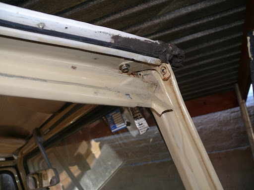

Old 06-05-08, 03:19 PM   #47
IH8MUD Regular
tmarx's Avatar
Join Date: Aug 2005
Location: CAPE TOWN
Posts: 314

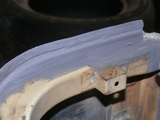

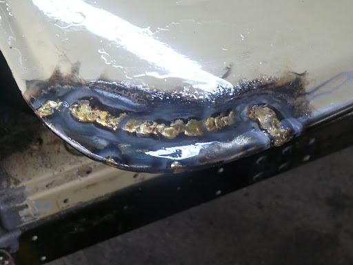

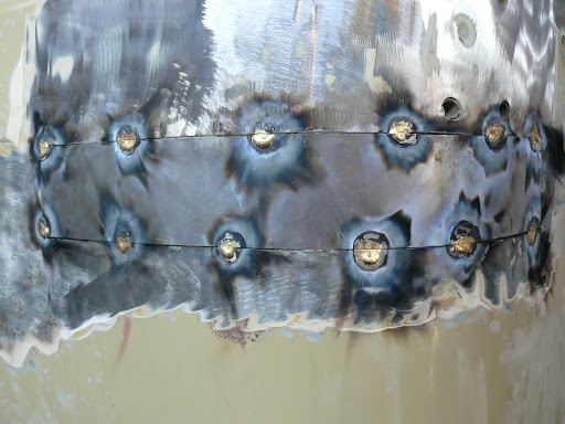

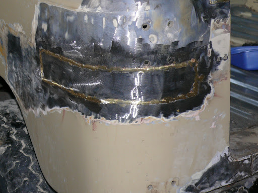

Rear ambi door
Driver's door: New bottom piece already Rust Bulleted and welded in.
Hardtop
And that is it,.... so far

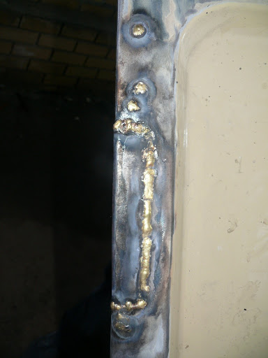

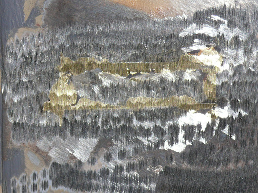

Thanks for the kind words but to set the record straight, those welds are not mine. I have a beater who comes around to help me, so my participation has been limited to some cutting, grinding and some shaping of the patches, but I am learning so .....

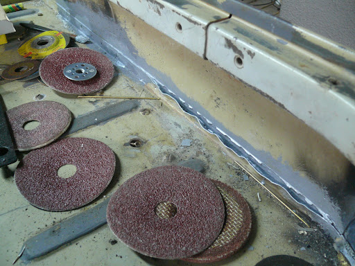

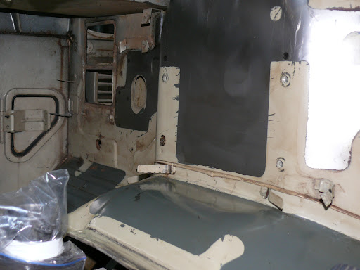

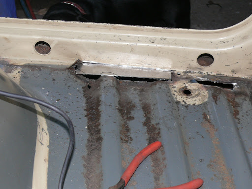

Some update pics.

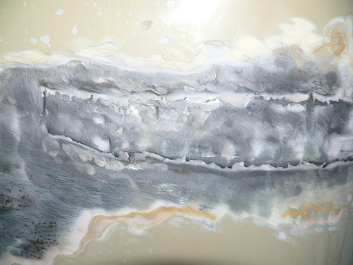

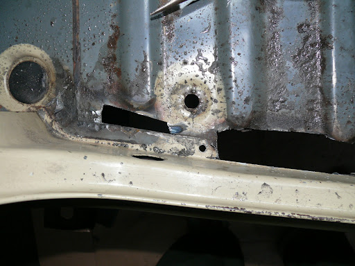

Self etching metal cleaner prior to the temporary NS4
New lips on inside...
From the other side

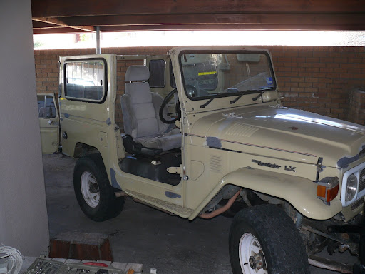

Getting ready to test-fit all the doors etc before fine grinding, dressing etc can begin...
