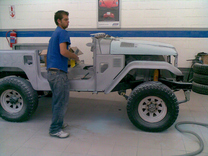

Looking great!
Amazing how just having everything the same color (primer) makes it start coming together...
Nicely played sir!

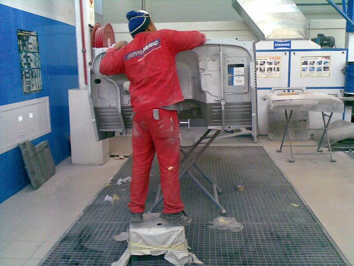

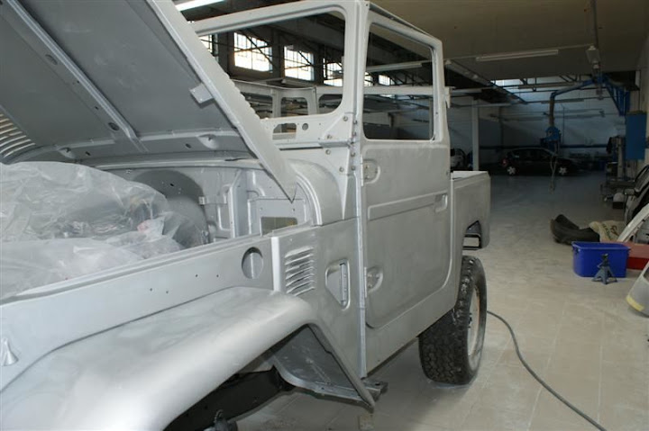

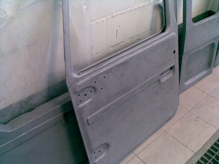

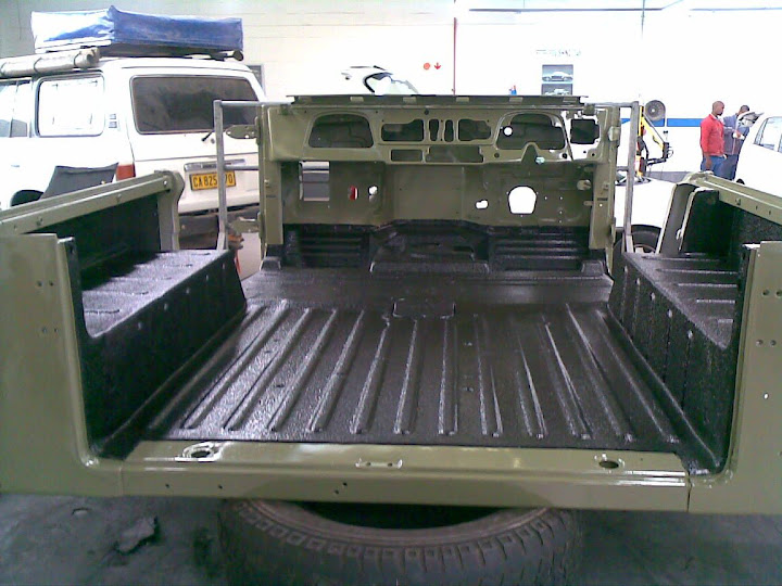

Quote:
I never planned on the cruiser ever being so straight. Non of the bondo is thick it is just a skim coat to iron it out. It is actually gonna look kinda fake because you know they didnt come off the show room straight...
So true....

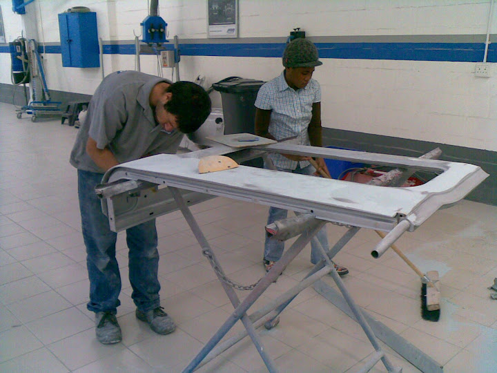

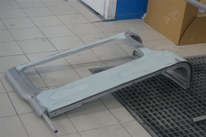

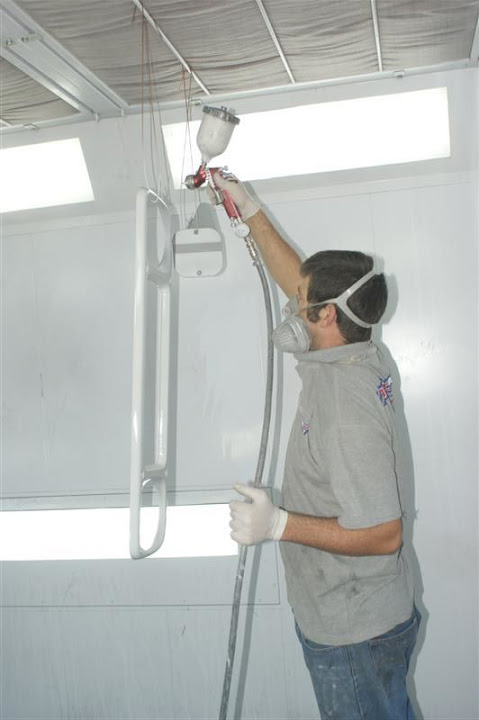

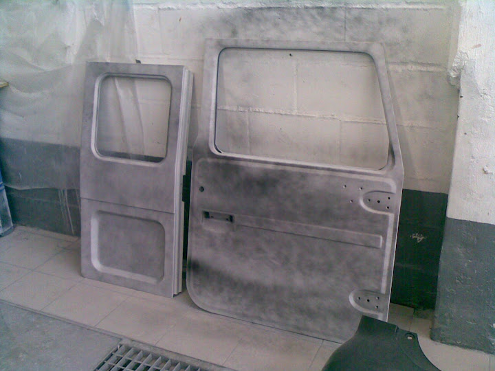

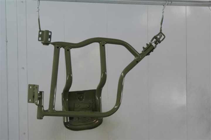

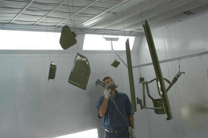

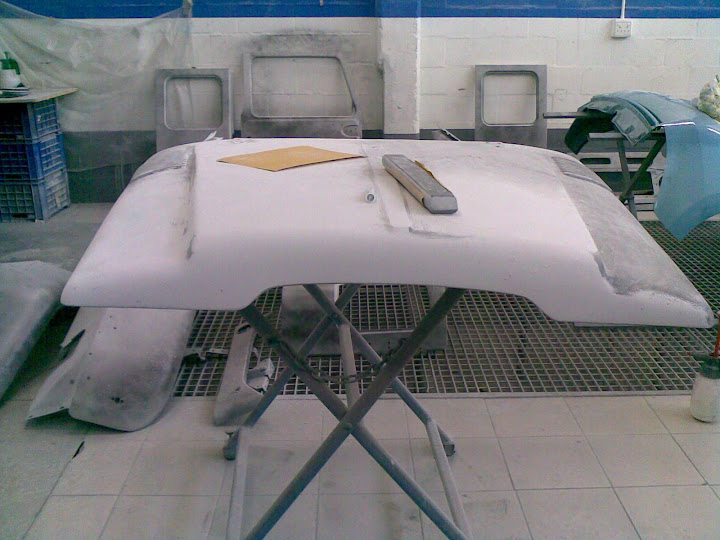

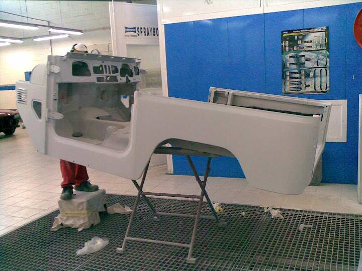

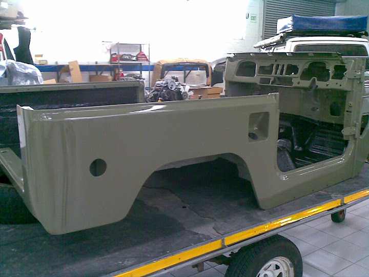

Eventually after a touch-up coat of Rust Bullet to cover the scuffed areas and the filler. The final 2 coats of Rust bullet will be added when all the beating and filler work is done
Starting on the hard top panels
Then just when I thought that was the end of it, imagine the surprise I got. Gordon and his guys caught me for a sucker but it was a very nice one. The buggers secretly started to prime and paint all the small bits that are not needed for alignment

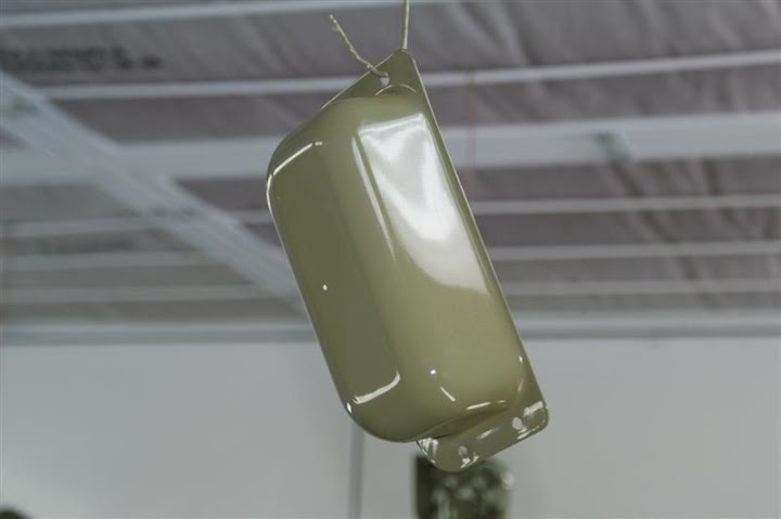

The bezel in white
And then my favourite the 6H9(Toyota Olive Grey)

You've got paint on there! How awesome is that?!?!?! I'm liking the 6H9 there. Is it Olive Grey, or Green? The 6xx paint codes were only for green, I thought? no matter, it looks wicked good!

Dan to me it is also more green than grey/gray but that is what Mr Yoda decided to call it so .. I just love it !

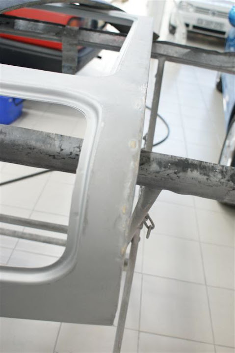

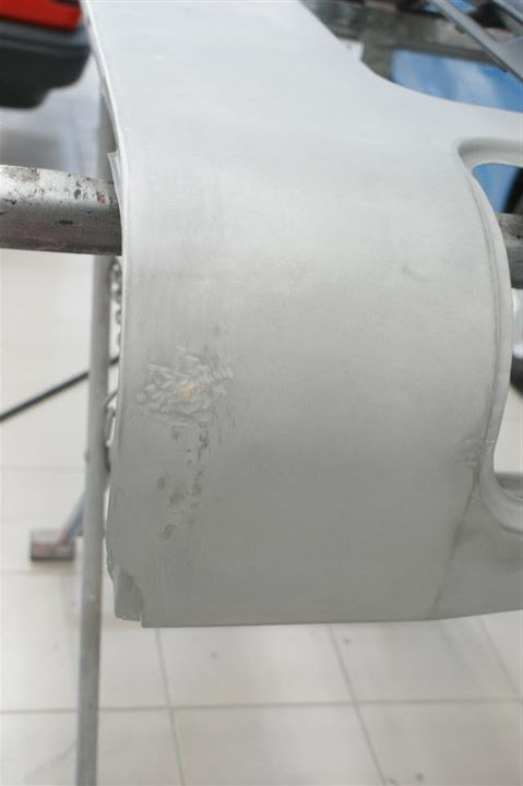

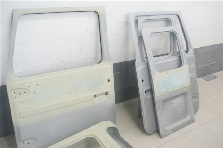

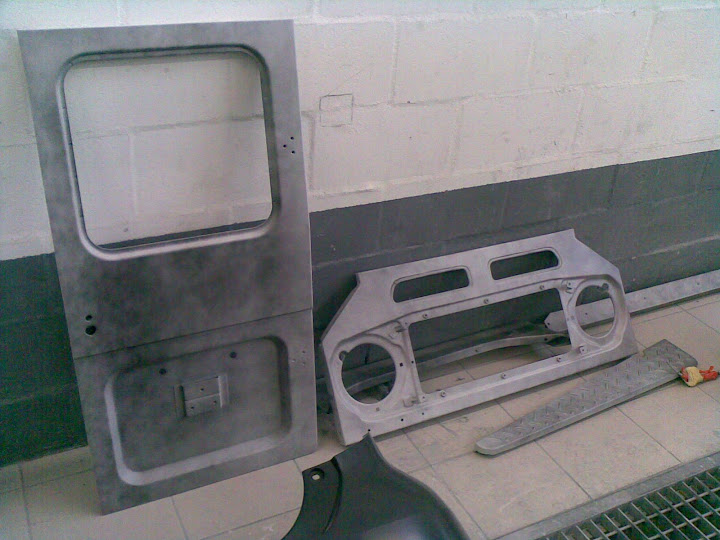

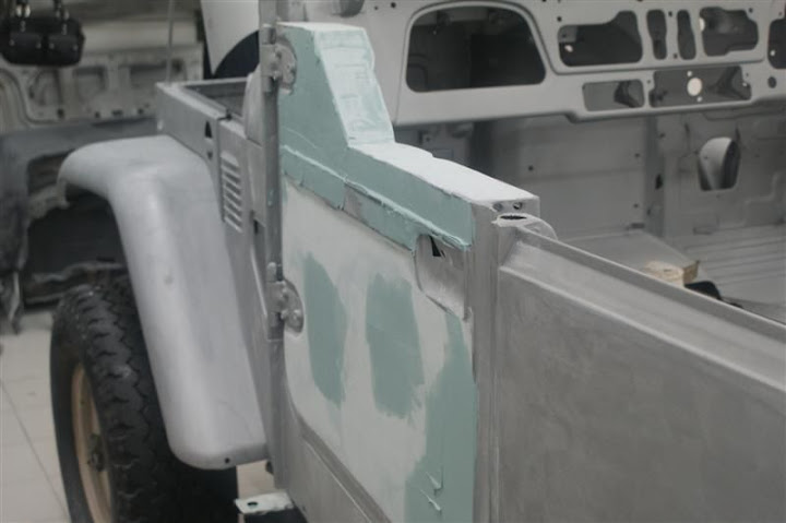

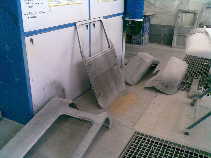

.. and work continues in spite of the weather slowing us down
The long & slow process of adding little bits and then sanding it down continues..
With all the rain around we cannot cover or do touch-ups with the Rust Bullet and have started using self etching primer as a temporary measure....
Next week when the rain is gone we will sand the primer down and spray the Rust Bullet

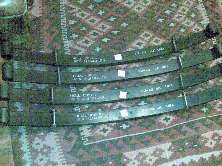

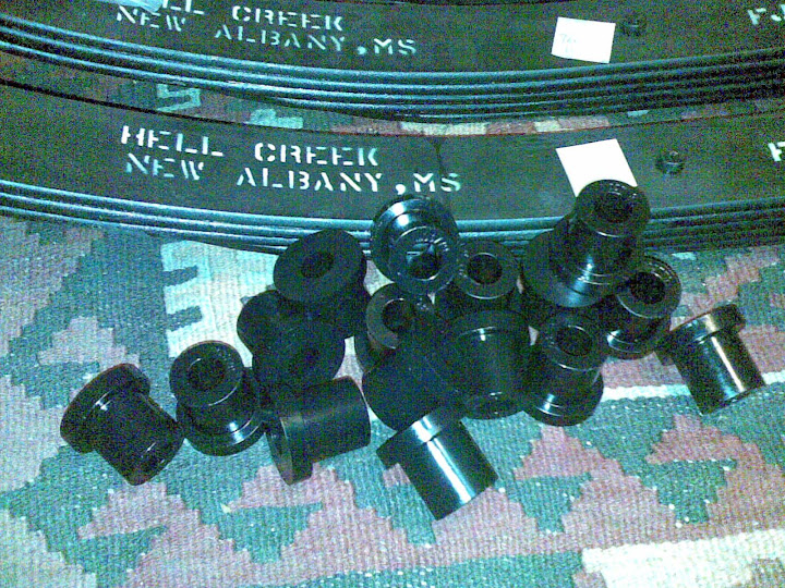

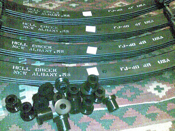

Got some very cool goodies in the mail today ...

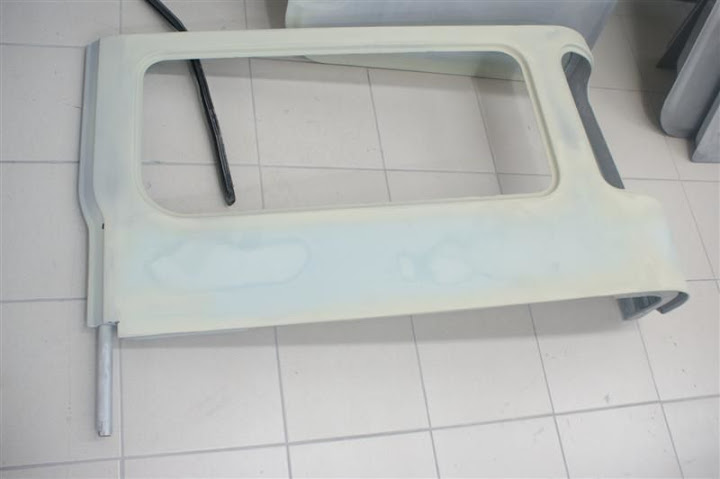

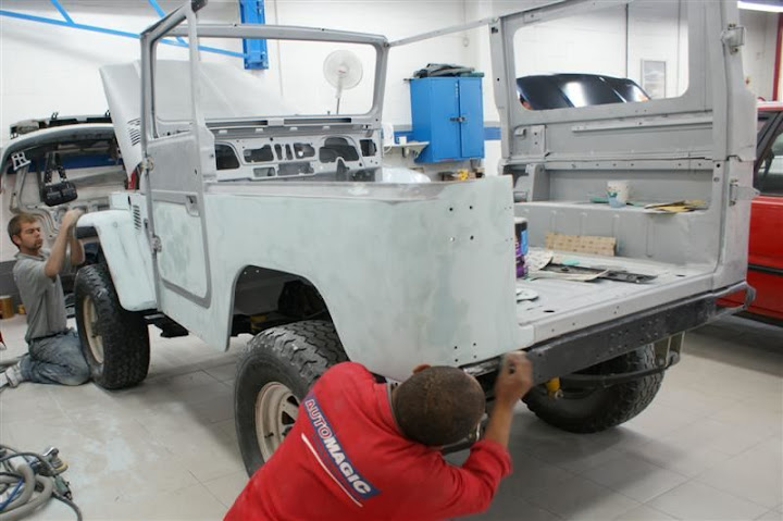

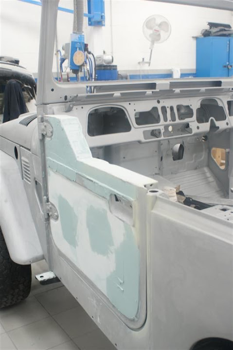

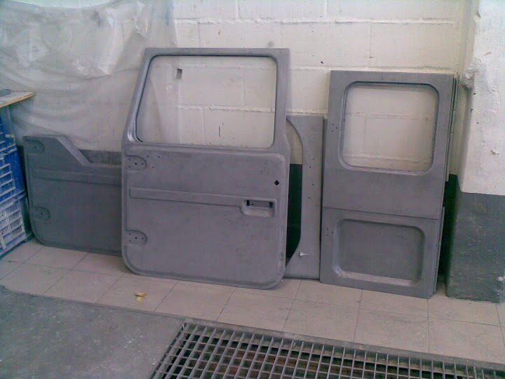

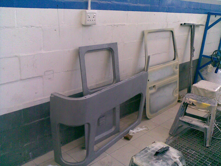

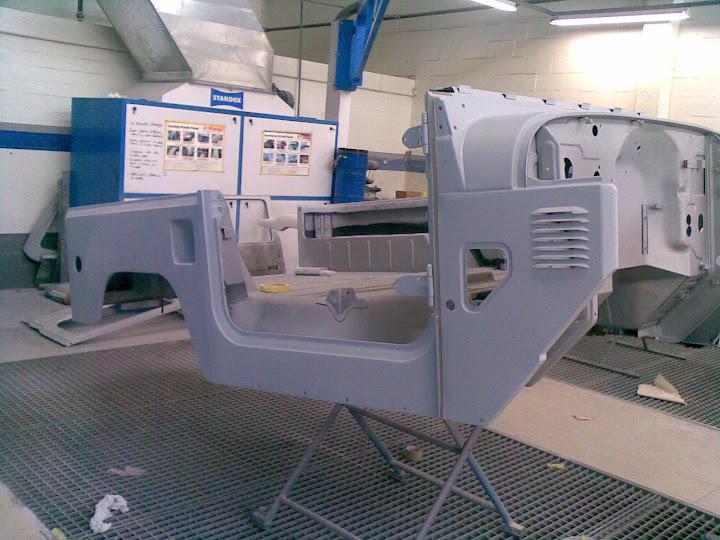

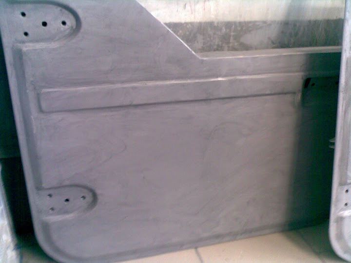

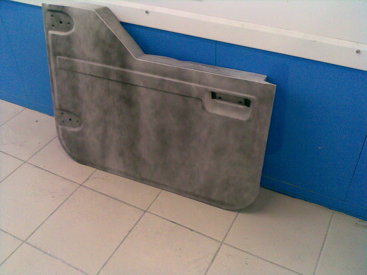

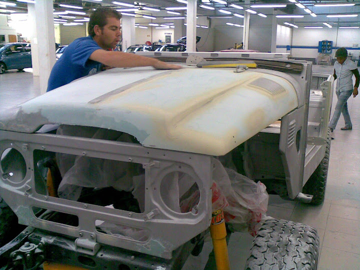

Well we had a week of no rain last week, but the filler work took up most of the time.On Friday morning we still had 4 panels to go ...
But true to form, by Friday afternoon they had managed to finish 3 out of the 4 panels and also made use of the good weather by finishing all the Rust Bullet touch-ups which included removing the self etching primer(temp solution)
Then while I was away for the weekend, some of the guys came in on Saturday and made a big push by finishing both the primer coats.This was a huge but very pleasant surprise to me this morning
Guide coats on and final fine sanding being done in prep for one last primer coat and then the 2 dummie coats ..
As I arrived this afternoon they were finishing the last primer coat on the outside of the tub, wherafter we did the seam sealer and then it was final prep for the 2 dummie coats of colour
After a got home I received a phone call just to inform me that the 2 dummie coats went on well and that it looks "brand new" .
These guys have really put long hrs into this job and deserve all the credit for the finished product. Tomorrow I will collect the tub in order to take it for the PU lining on the inside. Thereafter it will get a further 3 coats of colour paint ..

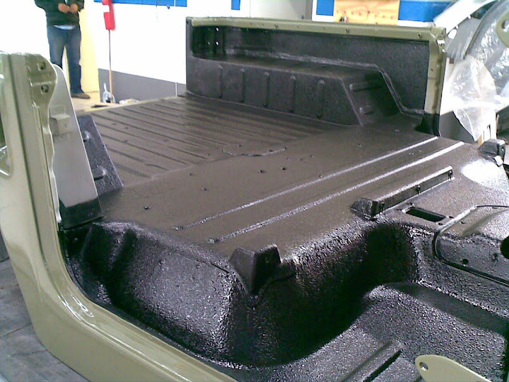

Mmmnn, difficult one to answer Rob as I don't know the state of your tub/rust. If you are going to be cutting out large areas of metal especially in the critical areas, I would suggest leaving the tub on the frame and /or bracing it where needed.Also if you expect to have a fair bit of filler to be applied I would suggest the tub and panels to be on the frame, in order to check and re-check alignment as the filler is built up and sanded down- although I would be the first to admit that I am slightly anal when it comes to certain things(), and have seen tubs& panels being done while not on the frame with good end-results.I would also only apply the RB once all the cutting and welding has been done as the RB otherwise, needs to be grinded off in those areas, in order to weld properly - that stuff is tuff ! If I had to do it again I would do things slightly differently:
1. Blast
2. Coat with a primer as a temporary measure while metal work is being done
3. Finish all metal work
4 Remove as much of the primer as possible and shoot with 2 coats of RB
5. Fillerwork
6. RB , prime and paint.
Initially we were concerned about the filler not sticking to the RB as the RB is PU based.We tested a variety of fillers but soon realised that the "trick" was, to make sure that you scuff the RB properly. I did not have access to RB Metal Blast or the accelerator products ...

Yesterday I collected the tub and this morning I dropped it off at Rainbow PU linings. At 14h00 they were finished and had done a really superb job. It was a frustrating and nervous drive back into town to drop it off during peakhour traffic.
I love the colour and in sunlight it is even better
The black and 6h9 gives a great contrast but I am thinking that the rims should be silver rather than the flat black I originally planned ?
