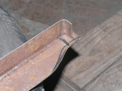

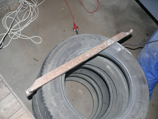

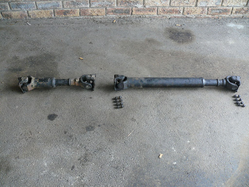

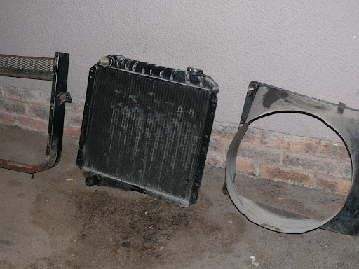

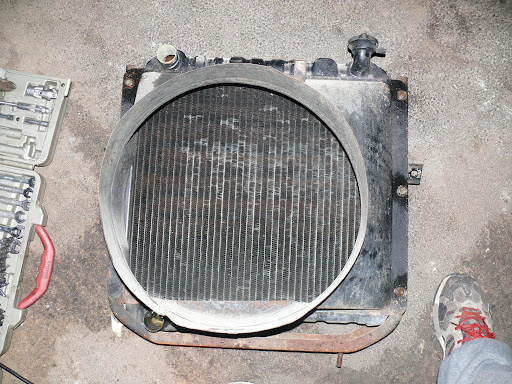

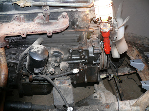

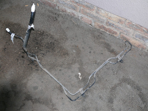

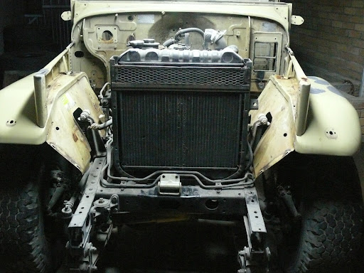

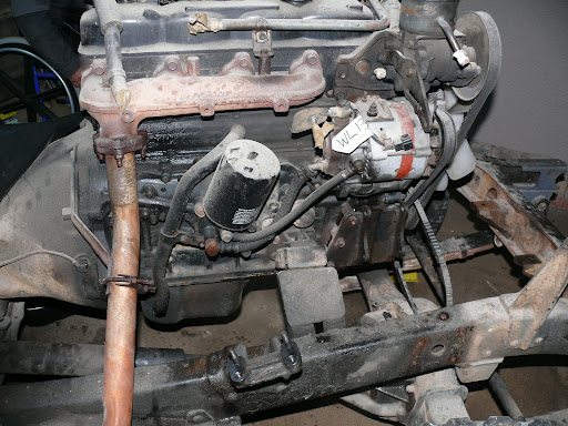

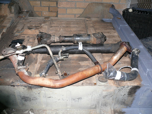

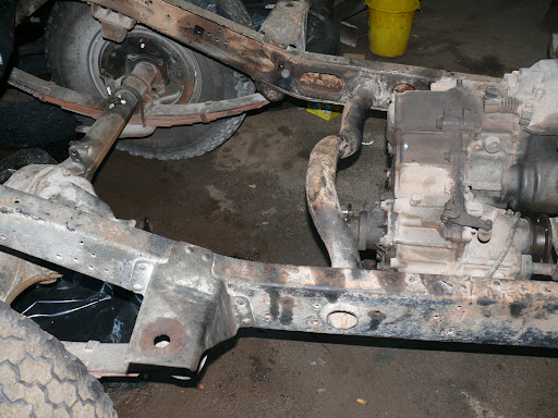

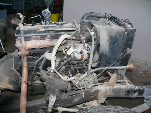

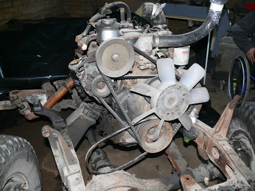

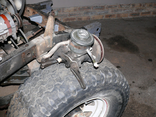

Time for an update as I eventually started stripping her about 2 weeks ago.I know I am going slow but this is a first for me so I take lots of pics and make notes of just about everything. once my shop gets its new lights tomorrow, I should be able to work after dark also.
Perfect fit on the long ranger tank !

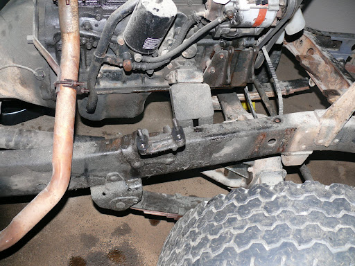

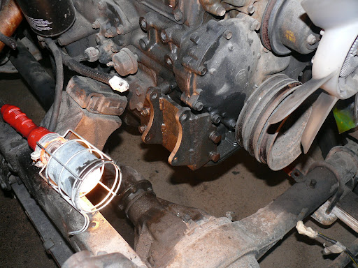

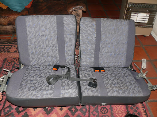

I also got her registered and on the road and for a week I absolutely enjoyed having her topless
But then I finally parked her last weekend...

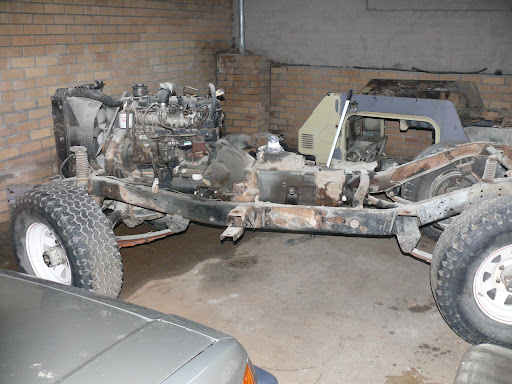

Which is where we are at the moment.

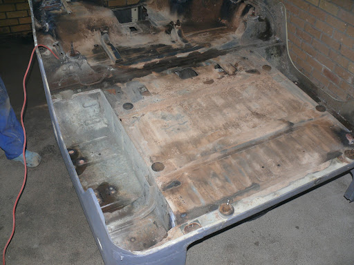

Old 06-05-08, 02:49 PM   #43 (permalink)
250+ Club
tmarx's Avatar
Join Date: Aug 2005
Location: CAPE TOWN
Posts: 701

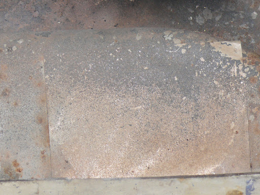

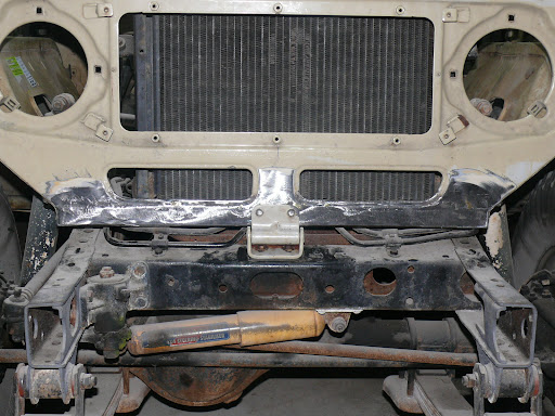

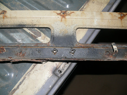

Time for an update.
Hidden beneath all the bondo...

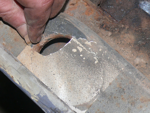

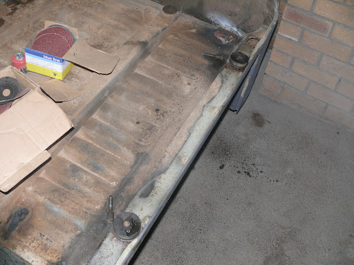

Time to remove the heat & sound matting to see what it might hide..
Only this spot in the back
The front floor being a mix of good and bad

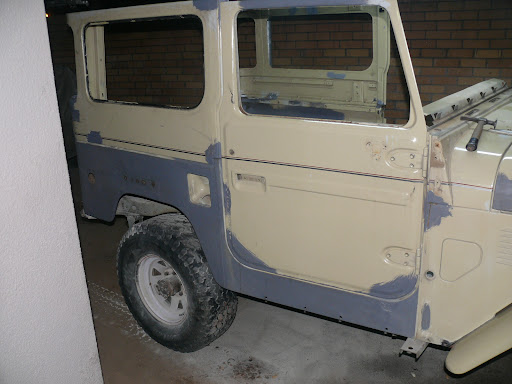

The total amount of sound and heat matting removed
Then after countless hours to remove the sticky residue she now looks like this.

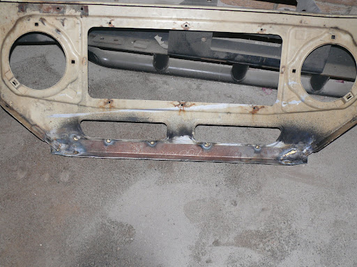

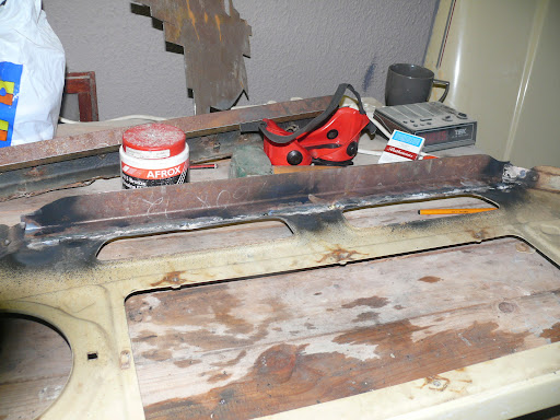

New floor piece shaped and fitted all the way into the sill.
new lip fitted above the floor piece
From the bottom

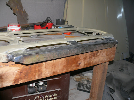

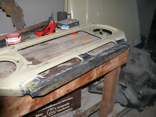

Rough grinded, etched cleaned & temporarily painted with NS4 untill the Rustbullet Silver Label arrives...
Once again the whole seam is opened and a new lip made to replace the old. NO SHORT-CUTS !
New lip to replace the old which was covered with Rust Bullet on the inside before being welded in, just like all the other closed areas..
Seams that are too good to be cut out are drilled open and painted with Rust Bullet on the inside before being closed up and spotwelded again.

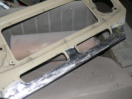

Rear ambi door
Driver's door: New bottom piece already Rust Bulleted and welded in.
Hardtop

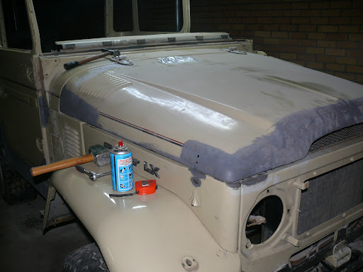

Some update pics.
Self etching metal cleaner prior to the temporary NS4
New lips on inside...
From the other side
Getting ready to test-fit all the doors etc before fine grinding, dressing etc can begin...

A few more

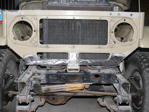

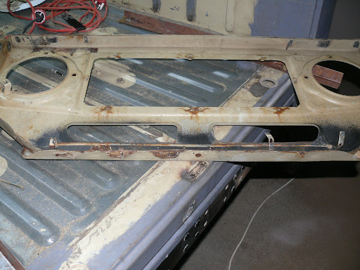

Both the inner and outside pieces needed to be replaced..
We cut, bent and shaped the new outside piece after lots and lots of calculations...
and after tacking, welded it in place.
All grinded down..
Although the inner piece has been shaped we did not weld it in as I needed to Rust Bullet the areas that would not be exposed to normal paint, once welded up and we wanted to test-fit the new bottom with the fenders etc first(in case we need to make alterations) before final welding and drilling etc
So it was time to see if the "new" bib would fit properly which meant I had to refit both fenders and side panels.
The culprit..
Is this a perfect fit or what ? Even the angles of the swivel hinge was good !
That meant we could weld in the inner part that acts as reinforcement
With our spirits up, we decided to check on how some of the other parts that we had butchered, lines up..
So far all good

After finally finishing the last of the welding(on the outside) and the test fitting it was time to remove the tub and face whatever she was hiding underneath, so the tub finally came off !
From the beginning I was praying/hoping that rustwise, she would be better underneath than on the outside and ontop as it seemed that the PO had sprayed her with some rubberising underneath. Most thought I was nuts and looked sceptical....
What a pleasant surprise it was to find that what looked like rust is actually very fine dust...
Bar a small spot at the left tub mount the sill is very good.
It even still had the OEM stickers covering the factory holes
If it wasn't for the rain preventing me form painting the Rust Bullet on the few patches we need to weld, we could have finished all the outstanding welding.( When some of the helpers found other entertainment we took it as a sign and called it a day early...

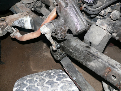

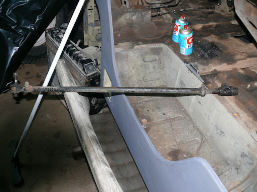

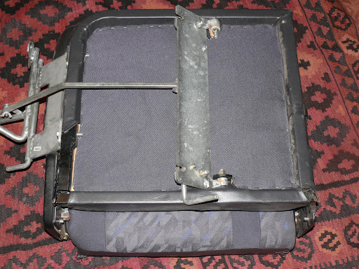

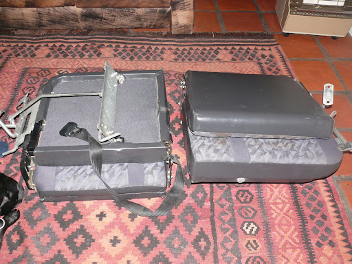

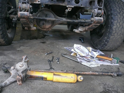

Time for an update: In prep for engine and box removal we removed the tierods , shocks and last of the brake hardlines. The help arrived early enough for the rugby and cladded in traditional war-dress nogal, well we lost and then I got my own revenge by putting him to work!
Thanks mate !

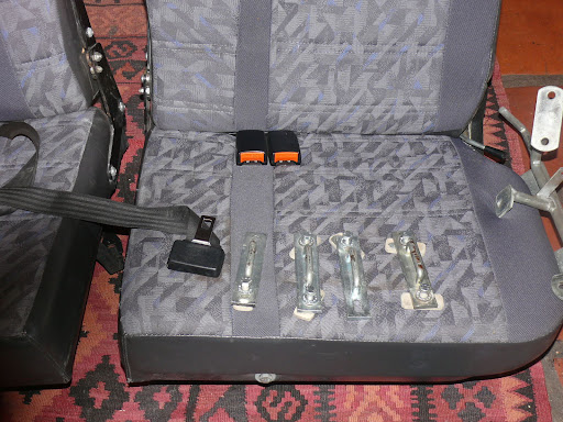

Then today I got a huge pressie !!
These were custom made for an 80 series but we have already worked out how to fit them in the 40. Watch this space...
Thanks JB ! You are the best ! Now I just need to find the 2 outside seatbelts etc

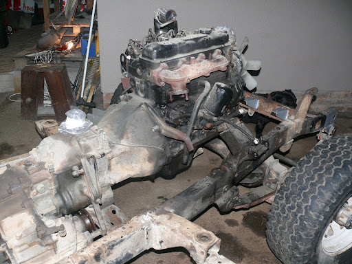

Got a little done ..

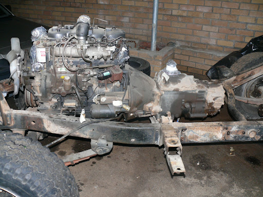

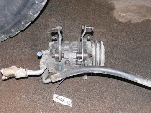

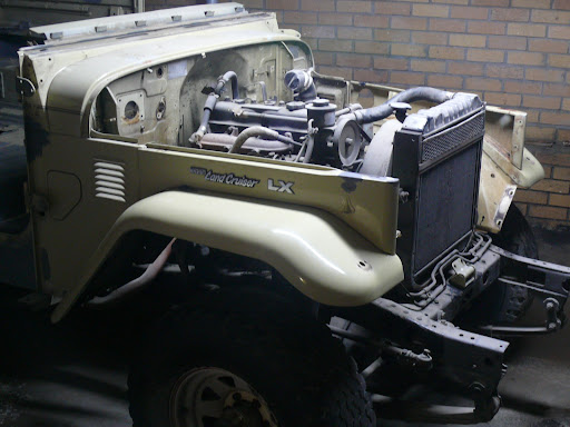

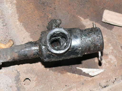

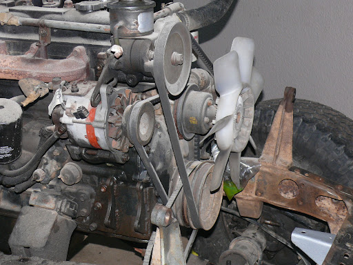

In preparation for pulling the motor and boxes I have been stripping some more stuff ...
The intake side I may just leave "intact", as far as possible
