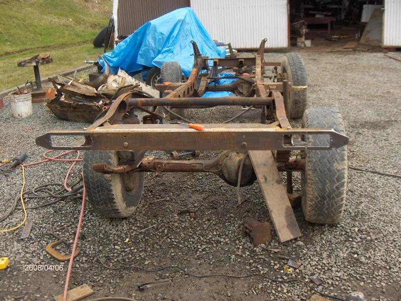

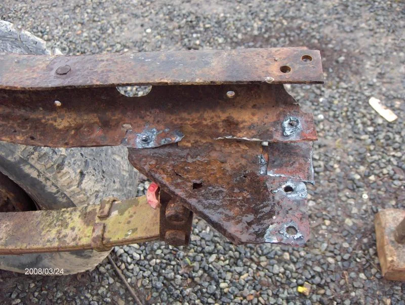

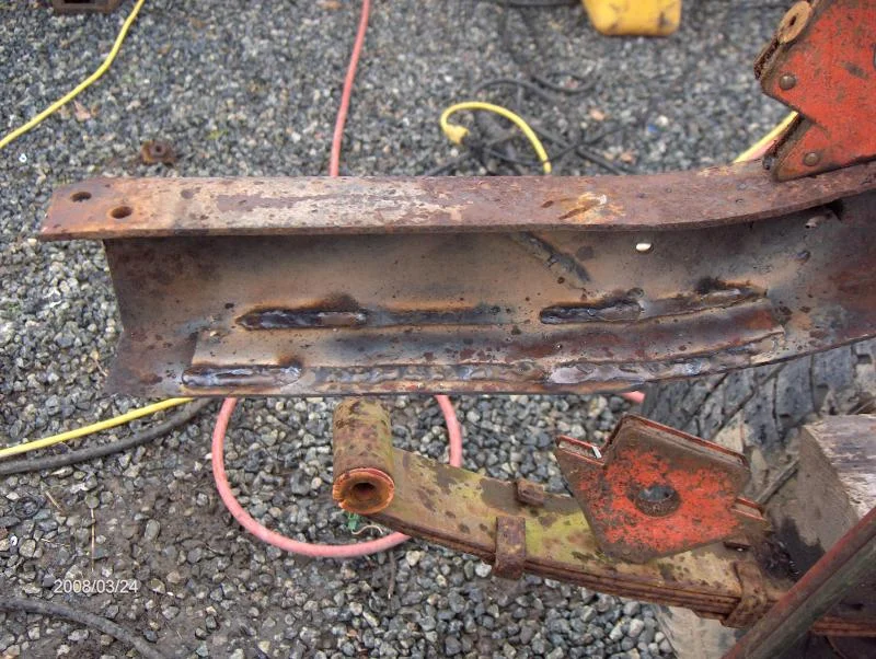

Ya dont be afraid of the frame mine was way worse and just made it stronger.

This was before first pic was after

Sencond the don't be discouraged quote.
Mine was just as bad and is turning out pretty good.

Here are some of the latest build pics of my resto. Still working on the frame. Its been a long process just working a couple of hours on the weekend and weeknights. The frame is ruff but I'm almost ready to send too my fab guy for stretching. Here are a few of the pics of the repairs I've done.
The PO had cut the front bumper mounts to make room for is plow frame.
This is what it looked like after the repairs.
The area around the driver side - rear spring mount
before
After
And here are some other frame repair and prep for the stretch.
For the frame stretch I'm thinking of cutting between the center crossmember and the front body mount. Here are a few pics (made in Solidworks) of what I think the strech will look like.
I think things are progessing well but I think once the frame has been stretched and the new Aqualu tub gets here this thing will start looking like a Cruiser again.
