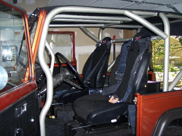

X10 for The Metaltech Cage. I actually bought one that he welded up and then shipped. It worked out great.
As far as aftermarket seats, I bought Mastercraft Baja RS seats and I would say they are the most comfortable seat I have sat in for a while.
Good Luck!

Rhino73,
where you able to mount those seats to the stock seat sliders or did you have to buy a new set.
thanks,
Brendan

I like those seats, Interesting way to run the shoulder straps. Any particular reason? Other than the obvious.

I had to build a custom bracket due to the MAF 28 Gallon Tank. Tough to see because I had it Line-X covered to match teh rest of teh interior.
Jeff
