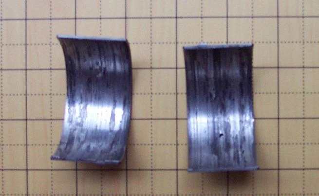

The Piston Bearings for #2 and #5 were both bad. The rest of them were fine. No guages were found o the crank. We took an emory cloth to the crank and only bearing material came off. Now nice and smooth. Ordered new bearings yesterday, will have to wait until next week to ge them.
We were confused for a while because the bearings had stamped on them 010 and this did not correspond to any standard 2F bearing sizes. Someone finally told us that that means 010 over which is the same as .25.
The scrapping and gauges in the bearings ended up covering the oil hole with metal. Engine seems to move freely now (by hand) with no noises. Will have to wait until we install new bearings next week, but it is looking real good.
Good thing it was only idling in my garage!
