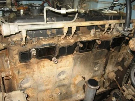

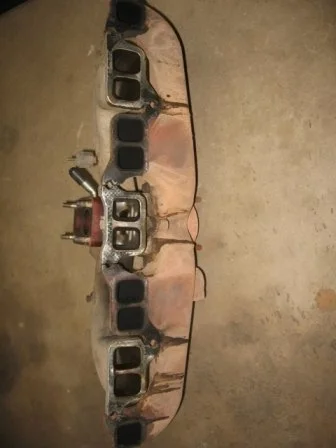

Yep...I'm gonna hafta wait on the headers. They look nice though. My gaskets are on order...all Toyota parts.
I'm pulling the manifold off tonight. While I have it off and I'm waiting for my gaskets from CCOT, I was wondering about putting a fresh coat of high-temp paint on the manifold after cleaning it up really good.
While looking for the vacuum leak, I sprayed a ton of carb cleaner on the intake manifold and it revealed a shiny cast iron finish below. I like to clean things up when I have them apart.
Any suggestions on cleaning or protecting / painting my intake manifold?

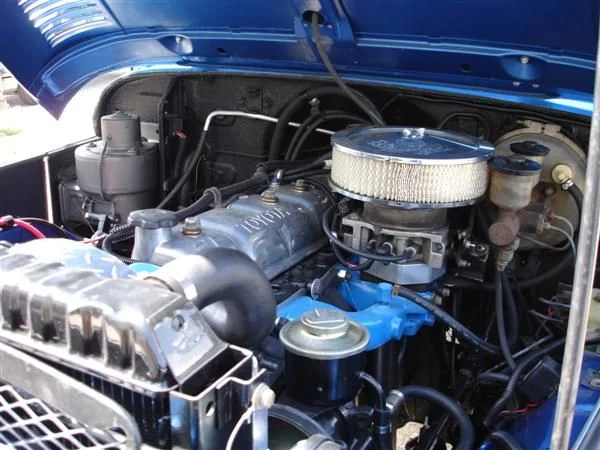

Quote:
a good wire brushing and paint.......

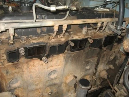

I took it off tonight. Waiting for the gasket to arrive.
Thanks for the photos, Grant. That looks really nice. I want to clean it and paint it while it's off. What type of paint did you use? Did you paint the exhaust manifold, too?
Do I need to take it to an engine shop to check if it is warped?
How would I check the head? I have a scraper, but the gasket is really loose. I'm thinking I'll scrape it nice and clean and put my level on it. I could probably find a relatively nice straight edge around.
Any other suggestions appreciated.

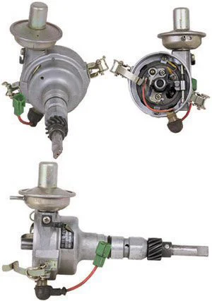

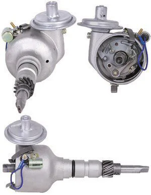

After market Dizzys
Look at these two dizzys at the Advance Auto parts website they list one as for CA emmisions vehicles and one for non-emissions vehicles. It looks like one is an advance and one is a retard. They are both listed as import. Would this be a cheap way to get a non-USA dizzy?

Now that I look at them sisde by side I can see that the one isn't an advance. I was fooled by the port being on the "right" side of the diaphram but they both move the advance plate the same direction.

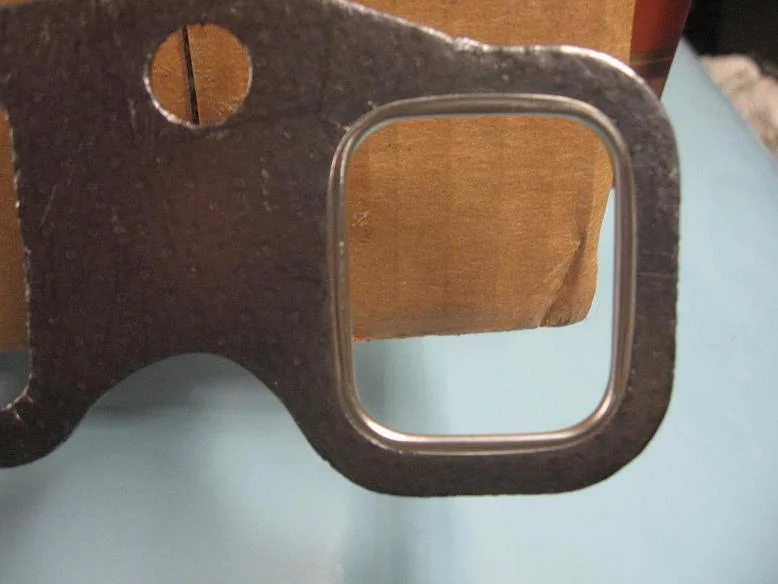

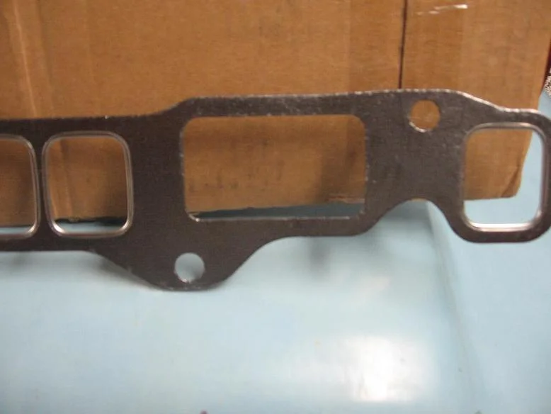

So the manifold gasket came from cool cruisers. I ordered the Toyota OEM part number and was expecting a nice copper looking gasket and got the same fiber/metal looking thing I just pulled off of there.
The kind folks on the thread told me to go with copper. Should I even waste my time putting this thing on?
Does anyone know where else I can get a copper one?
CCOT tech told me it took so long because the part came from japan.
I'm bummed.
They are both vacuum retard. The key is to look at the way the breaker plate rotates when vacuum is applied. You can tell which way it will rotate by looking at which side of the diaphragm the vacuum port is on.
I'm bummed.
I have never seen a copper gasket. All the F/2F gaskets look like the one in the picture. People may have been talking about Permatex copper casket cement, but I don't think that it matters as long as the sealing surfaces aren't warped. Gasket cement doesn't stand up to exhaust manifold temperatures.

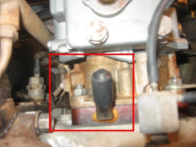

I sprayed two bottles of carb cleaner all around the manifold tonight. I got no response from the engine.
I did detect a vacuum leak around the carburetor. In the attached picture, I got a boost when spraying around the area in the red box. The leak seemed to be in the seam between the cast iron base and the middle portion of the carb.
Unfortunately, I ran out of carb cleaner before being able to pin point.
I'll test again tomorrow and see if I can isolate. At least, presently, it seems the manifold gasket repair job was successful.

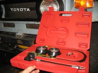

I think I have a blown head gasket. I did compression test and found #3 and #4 to be 124 and 125 psi.
At least I know how to make the rig idle right. Now I guess I get to pull the head off.

Yes I agree, can't jump to conclusions.
Here is what I do have:
1. The sound that occurred during the test drive.
2. Coolent on the driver's side of the head.
3. Lower Compression numbers than a test a few weeks back.
4. Idle Intake vacuum dropped from 17 - 13 at idle from before test drive to after test drive.
I thought the sound could have been the charcoal canister.
Then when I saw the coolant I thought it was the radiator cap. There was no indication of a radiator leak on first inspection. If the cap blew I would have seen steam coming from the engine. And I would have expected to find coolant around the engine and a shiney clean spot on the inside of the hood above the cap.

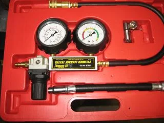

More information: I was test driving with the air cleaner off. As such I had a soft rubber cap over the valve cover vent which is now gone. Another possibility is some sort of pressure build up in the valve cover. I could understand oil, but I wouldn't think water should find its way to under the valve cover cap.
I was going to stop by the store and buy a leak-down tester and run a leak down test.
I'll post what I find.

I Got a Cylinder Leakage Tester
I read the instructions and am going to do the leak down test on Saturday morning. Does anyone have tips for getting each cylinder to TDC?

No leak down test - waiting for crank
I didn't get to do the leak down test this weekend. I did drive my cruiser around and it seemed to work fine.
Still idles down low, which is great...but it is a little rough (as you can see from my vacuum guage).
I'll post when I get a crank to rotate the crank shaft. I want to be able to place each piston at TDC, so the "rock against 4 th gear" trick wont work.
Talk to you soon.
