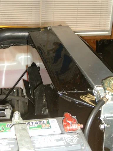

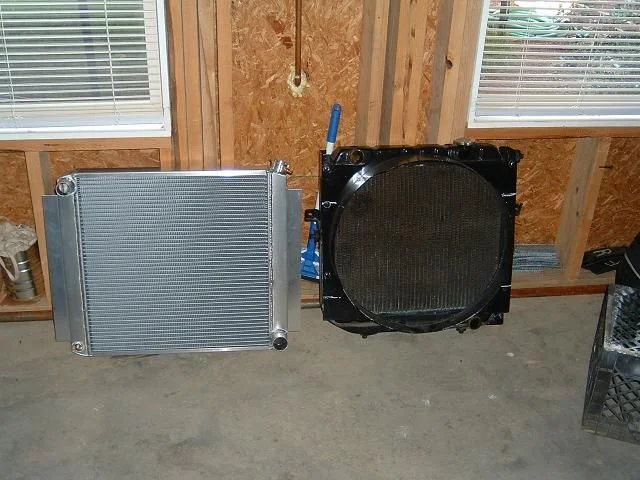

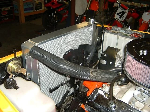

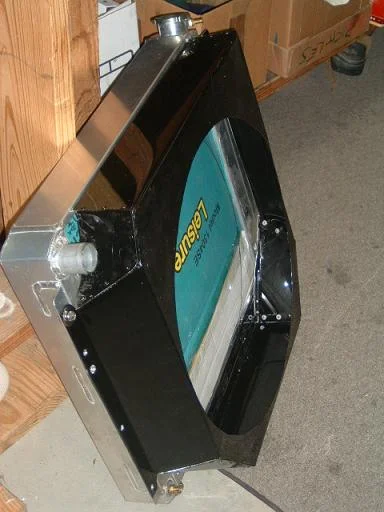

Boy you have hit upon a topic of debate. There are some that say the rad you have is adequate for the task, many more that say it isn't. Based upon my experience, I suggest a GM clutch fan from something big....caddy, blazer, suburban, etc. I use a thermal clutch fan from '84 1 ton Chevy with 454, AC, etc. Next is a properly positioned fan in a good shroud. By 'good shroud' a mean one that allows full flow of air to the core, not a flat plate with a hole in it that blocks 25-40% of the core area. From what I have read, input from others who have successfully cooled a Chevota and experienced myself, the fan needs to be positioned 1/2 in, 1/2 out of the shroud. I run an inexpensive SBC water pump with a no-frills $4 180F thermostat on an aluminum radiator with around 400 in2 area I had custom built by Superior Rad in MI. It has two rows of 1" oval tubes. Regarding engine placement, I have always used the recommended Downey/Advance Adapters dimensions so the engine is out away from the firewall. Last, or maybe first depending on how you look at it, is a quality, accurate gauge.

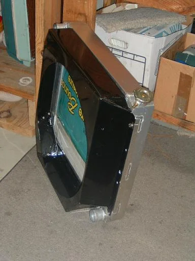

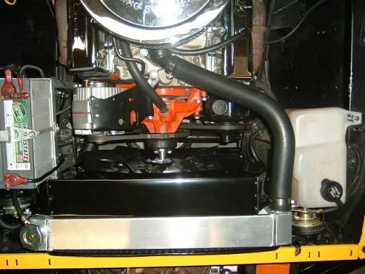

and some more

I haven't had any cooling issues with the setup the PO did. Standard radiator with a good shroud and good placement. The fan is about half way in as dgangle said. I'm also running a 180 thermostat and rarely see it rise to 190, even in when it's in the 90's out here.
The PO mentioned he tilted the radiator back a little so the fan filled the shroud better.

I too have the AA (Transadapt) front motor mounts. You could lower your radiator (preferred but harder/time consuming) or trim a small, equal amount from every blade (relatively easier but then there is the issue of balance and the possibility of looking like a hack....).

cpratt,
That looks like a good shroud. I bet that solid fan sounds like a 747 at take-off! Have you tried a clutch fan? I was impressed with how quiet mine was as I had a solid fan at one time. It would suck nuts and bolts off the garage floor!
One suggestion.....Go get a Gates 20416 top hose and get rid of that universal one. See
http://forum.ih8mud.com/showthread.p...gates+top+hose
posts 5 & 11. Fits like it came from Araco that way.
You may need a more angled thermostat housing, though.

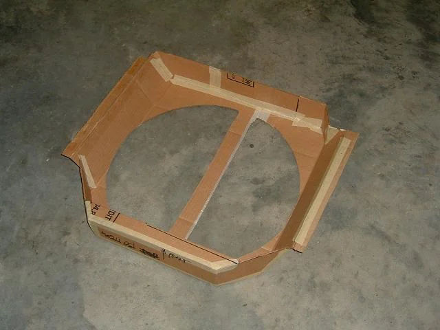

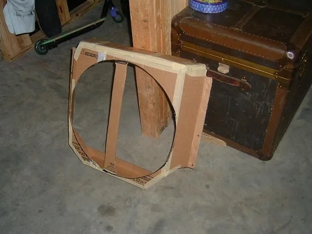

Quote:
Originally Posted by Black Dog View Post
Thanks for all the replys. The shrouds I have built for it look like crap compared to those. I will have to copy those and try it again!!! I also like the idea of a clutch fan. I'll give the old college try and report back
I made mine out of cardboard. Some sugegsted I should have fiberglassed it and called it good. I found a local old-school stock car body fabricator and he used it as a template to make it from aluminum.

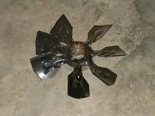

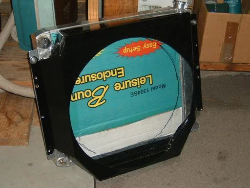

more
