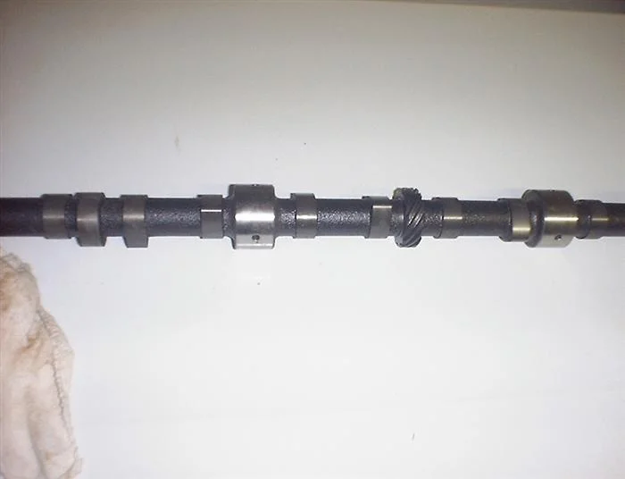

Quote:
Originally Posted by Trollhole View Post
On the stock Toyota camshaft the distributor drive gear is pressed onto the camshaft.
... howd they get that lil gear over dem lobes

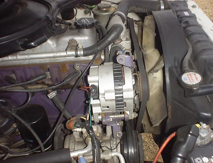

Colour is
Can I have the paint code

Originally Posted by matt.mcinnes View Post
Colour is
http://www.duplicolor.com/products/metalcast.html
Using ground coat first then the metal cast on top.
Very gay.

262 advertised duration.
Mark...
Thanks Mark. Do I need to buy SBC springs with this cam?
I normally run stock springs with this cam. You need to be careful about shimming them. they are running close to the limit and if you shim them much at all you may stack them. But I have found that even worn and "weak" stock springs do the job just fine within the rpm limits that you are working with for the 2F.
Mark...
Now I just need to figure out what shimming is. lol

Alright now you have got me what is shimming the springs? My machine shop did the valves. They and the springs are already together. Is this wrong? Sorry for all the questions.
Springs tend to weaken with age. There is a specified pressure that they are supposed to hold against the seat when the valve is closed. To bring this back into spec with used springs it is common to put shims under the springs so that they pull the valve shut a little tighter than they would without them. These shims cause the spring to be compressed a little more. This means that there is less room for more compression (as the valve opens) before they run out of room and fuly compress (stack).
It is not wrong, but with a high lift cam the loss of compression room for the spring may become a problem.
Mark...
This is good stuff.
So should I just buy new SBC springs and be done with it? Any particular type.
Thanks again.
I'd stick with the stock springs. I've never had a problem with them, even with runs to 5000 and a bit higher.
Not counting shipping, Delta will regrind your cam for about $90 IIRC. If you have damaged lobes that have to be welded up it costs a little more for each lobe that they do. Turn around is only a couple of days.
A new MAF cam, not a regrind, that is an advantage over a regrind. I use regrind in almost all of my engines, but a new billet will have a slightly larger base circle and put slightly less stress on the lobes and lifter faces.
Don't forget that you need new or reground lifters too.
Mark...

This purple attire belongs to a smoothie I know
