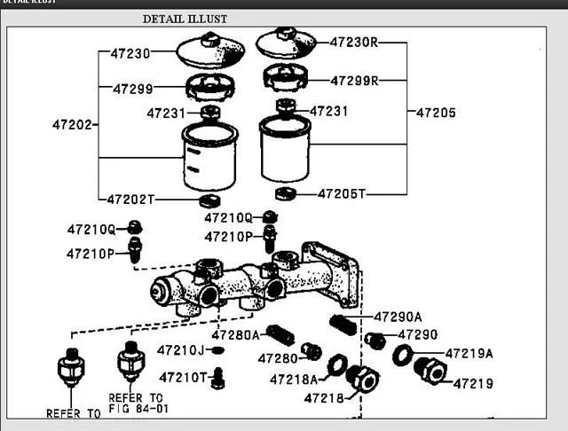

QUESTION does the 76-80 disc brake master have residual valve in the front disc line
I was looking at the EPC today and noticed this valve in both ports on the master for 75/09 - 80/07 FJ40/55 BJ40 disc brake .are these the residual valves ? if so
i thought that it had been posted that there wasn't one in the front, only one in the rear for the drums ,that needs to be removed when swapping to rear disc's ,the epc shows 2 also listing different part #'s for each . is there a residual valve for the disc brakes ? I don't have any in my master ,just curious
maybe i need one .

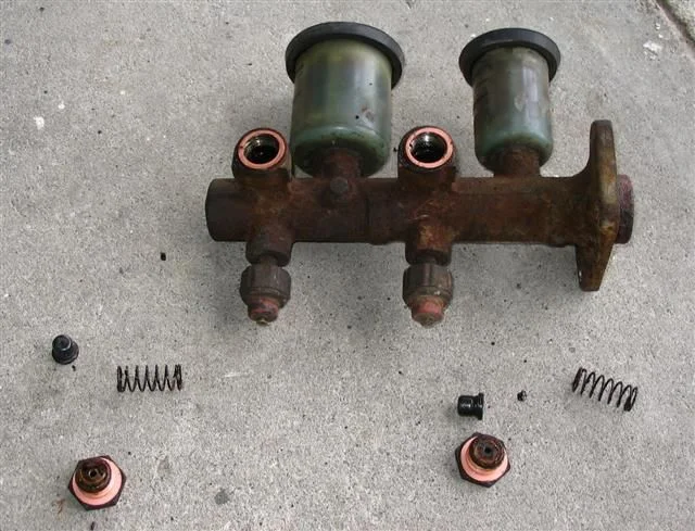

just opened up this one, not sure what year it is , but it has one in both ,the master looks like a disc brake master with the smaller reservoir ,it has the older style residual valves .

pgbottle's pic looks identical to my pre-disc '75 M/C.
X2 ...

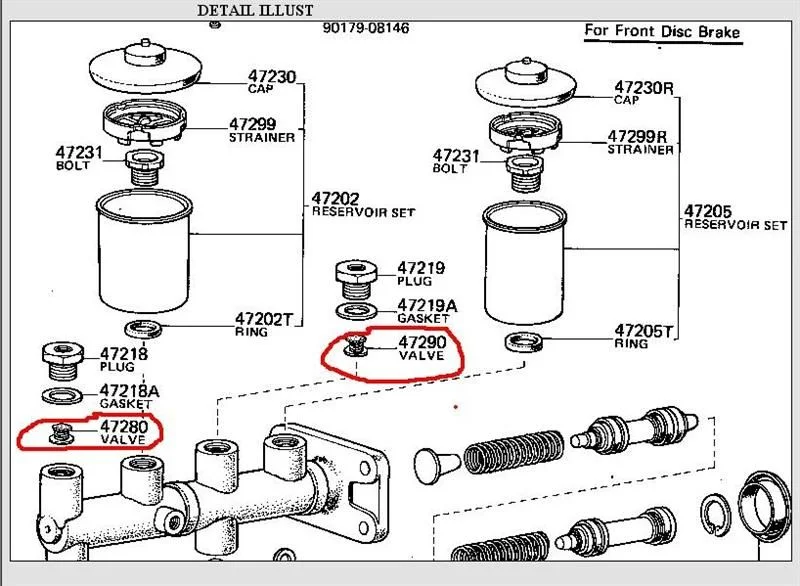

looked at the parts catalogue again and it also shows a master for the fj40
75-01 / 75-09
that looks more like the one i posted . guess it is a drum master

In the USA, 08/75 40/55 series trucks recieved the front disc axle...
Oh, and there should be a residual pressure valve in the disc and drum circuits...
