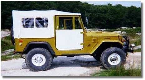

canvas :)
canvas

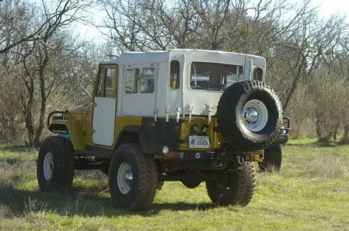

canvas pose

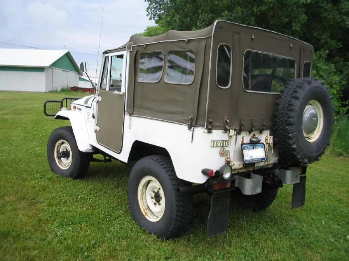

out side with sides rolled up
inside pic
and weather flaps over the zippers

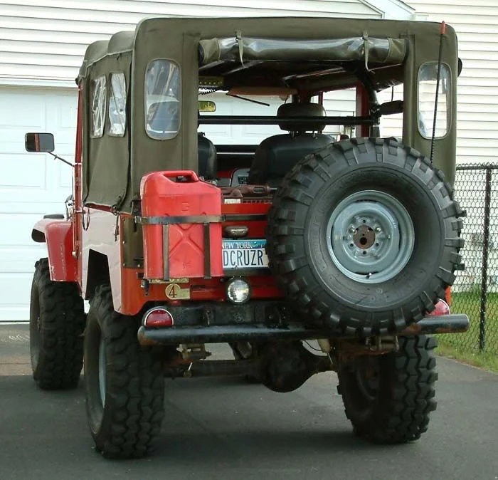

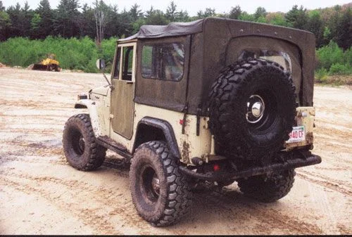

BigDaddy...BigRedFJ40's rig
love the look Chris
get it back on the road Chris

Quote:
love the look Chris
Boy Johnny.... my rig sure looked good then. Dosen't look like that anymore since I rolled it
All in time she will be back together again......

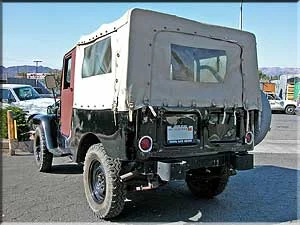

OEM canvas configurations i have seen come in:
1 window...no side windows ( van style )
3 window...1 in back, 1 on either side
5 window...1 in back, 2 on either side
7 window...3 windows in back (2 smaller 1/4 windows and 1 center window), 2 on either side (called the 'seven window' soft top some people call it the safari top...but have yet to see one on a safari rig )
and then the Ambi door soft tops
then you have zipper windows and/or twist lock windows
I will post some pics up soon...kinda forgot to add to this thread

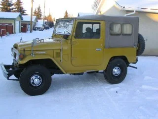

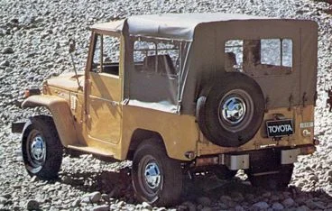

fj25 3 window
JohnnyC is offline   Reply With Quote

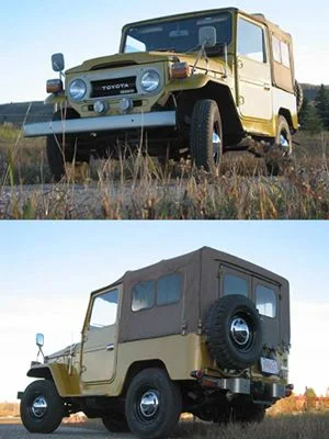

standard type 'A' rear tailgate
Type 'B' rear barn doors
Type 'C' Ambi doors
note the twist lock windows (removable windows)

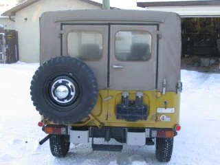

every true OEM canvas top i have seen...most every have the two seams down the top of the top...they may have ones with no seams...but have not seen any in pics from factory or from that era
