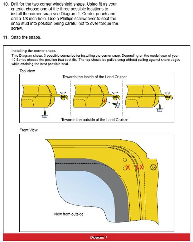

and last two pages for the factory replacement top instructions

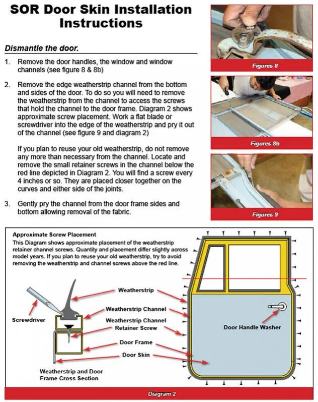

here is instructions on how to replace the oem soft door canvas:
http://forum.ih8mud.com/fj25-owners-...ml#post4848902
