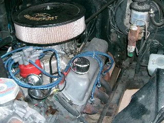

Sorry for the picture quality.
Edelbrock performer setup with a four barrel. Seems to run fine for now.
I could take some better pictures if you like.
Come to think of it, mine made that simular sound after reinstalling it. I had it out, drained and upside down. I think the noice was from the lifters not having any oil. Noise went away after about 15 minutes.
