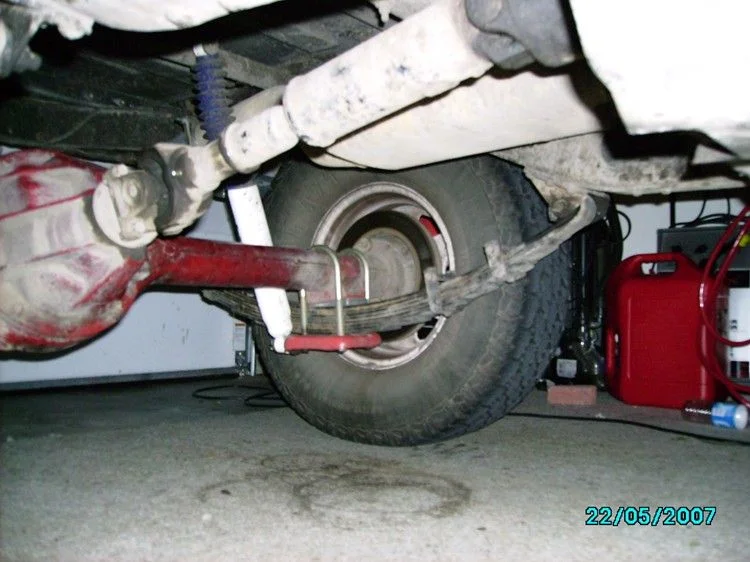

I fixed a few minor things (t-stat, oil press sender, fluids) and installed the JTO rear disc conversion. Then ran it for about 6 months before I decided to go with the lift and then my troubles and learning really started.
Here is what it looked like after the lift and new tires.

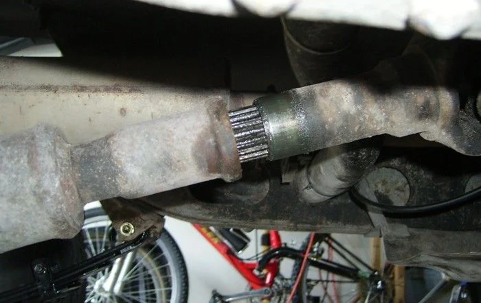

The rear driveshaft was definately the hardest thing I had to deal with after the lift. I had about an inch of spline showing.
Name:  old pics 001.jpg
I live in an area that is not renouned for its stellar machine shops so after three attemps with the local rednecks, I'd had enough. I decided to go with a CV and an early 60 series front shaft was the perfect fit (minus having to cut out the torque tube). Got one from another MUD member and no more issues after shimming the rear axel to get the pinion angle correct.

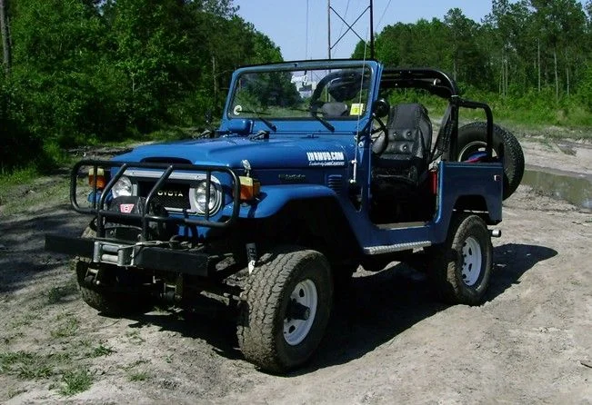

Got some new seats from DACICCI, and wheels from TEXX. I slapped on the tires it came with back on and am waiting to do a power steering conversion before I go to a bigger set, probably 35x10.5 so I don't have to get different wheels (I like the later stock wheel look).
Here is what it looks like now.

Here's a shot with the top off, as you can see not much terrain over here.
Jon
1phrogguy is offline   Reply With Quote

Jon,
Looks great and I like the route you're taking with the 10.5s and stock wheels.
Hey, where's a shot of the rear w/ a tailgate? Oh yeah, I bought your Aqualu tailgate!
Actually, just got done tonight installing it on the freshly painted tub and drilling all the holes and aligning it. Fits like a glove!
We'll have to meet up at URE sometime to do some trail riding.
- Drew

Quote:
Attachment 145228
forgot to add this pic, here is the 60 cv shaft and shims installed.
Name:  driveline shots 001.jpg
Thank you everyone, Happy wheelin!
