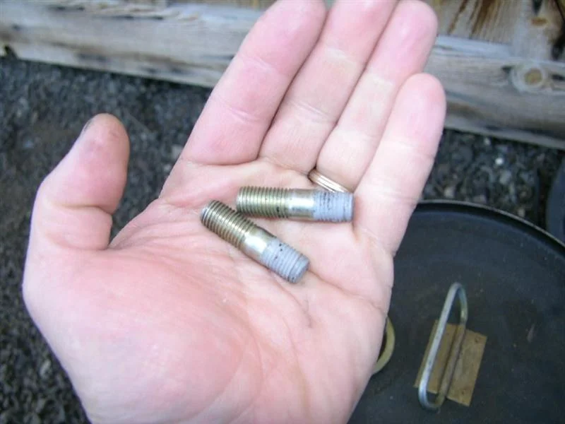

Allz I know is these Toyota manifold studs came new in the bag with this gray stuff on the manifold side. Don't know if it's loctite or antiseize.
Those are for the the two-stud flange where the exhaust pipe is secured to the manifold?
No, that's a bigger (longer) stud, IIRC. I'm certain I got these for the manifold. Perhaps someone substituted the part numbers. Unfortunately, I don't think I have the original bag from last year.
