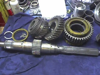

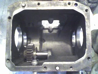

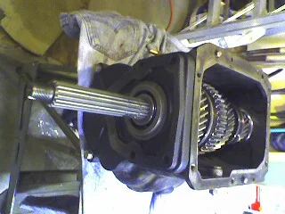

Just a quick comment. I recently rebuilt the H41 I have. It was rumbling really loudly in neutral, so I kinda figured the input bearing or the 17 rollers were toast. The bearing kit was identical to the H42 16 spline output trans. The outputshaft bearing was a beast, but I used a dremel to cut the outercage, then the balls just fell out, and off she came. A very thorough cleaning of all the internals in a parts washer made sure none of the grit found its way into the box. Had the case hot tanked at a shop. It really wasn't too tough, but that is one heavy trans! Have a helper to install it! Used Poser's two t-case stud method to guide the Orion onto the trans. SWEET! I spent about $275 to do this, so it was worth it IMNSHO.... For an H42, I agree with Pinhead...junk it!
Here are a couple pix for inspiration..camera phone, so not great quality..
Cheers!
