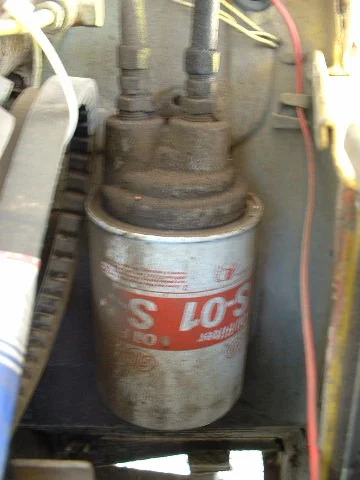

Not exactly sure if the 68 and the 67 are the same as for the oil system, mine had the large canister on the side of the engine.
Anyway, I removed the two fitting from the engine block, replaced them with standard brass fittings, pipe thread to compression (3/8 compression), that I screwed right into the block, and they have held for about thirty years until I replaced the engine.
Mounted the remote oil filter to the firewall that takes a standard spin on cartridge.
