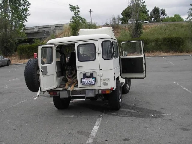

Disappointing weekend, but learned a lot. After tearing apart the Tranny and TC, replacing a new clutch, refinishing the flywheel, we decided to also replace the engine seal....while it's out and we do not know its history. Since we were replacing all gaskets and seals, to make sure that we got any and all leaks possible.
CAUTION: When inserting the main engine seal, tap tap tap, take your time!!! If you think you screwed it up, it's only $20!!!
We didn't follow this advice. We felt it didn't go in right and it got screwed up, so we stuck a bunch of silicone around it....just in case. that can act like a lube which doesn't help matters at all. Also the seal we got from SOR was smooth on the outside rather than with ridges....hmmm ANYHOOOOO, yep you guessed it....

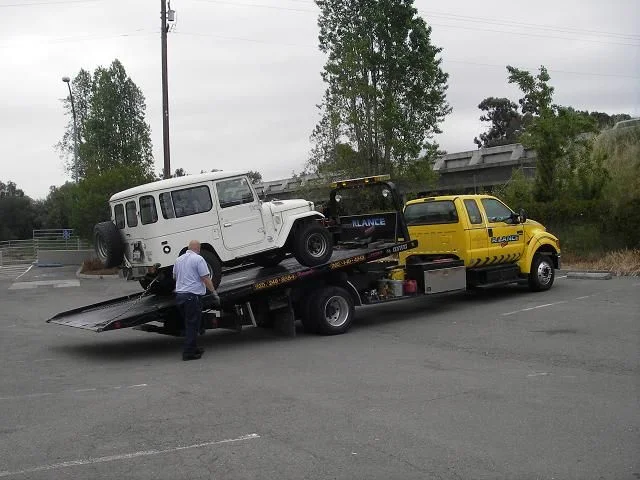

We ran a test run around the neighborhood after putting EVERYTHING back together. In the morning did the same. Off we went to Hollister. About 30minutes down the freeway, POOF! It popped the seal
Got it towed back to my dad's shop (an instant 24" lift) and had to tear it all apart again. The new seal should be in today. Will look for the ridges on the side, NO silicone, NO grease, and tap tap tap even if it takes 15-20 mins
Waiting patiently for a tow, and the instant 24" lift.
