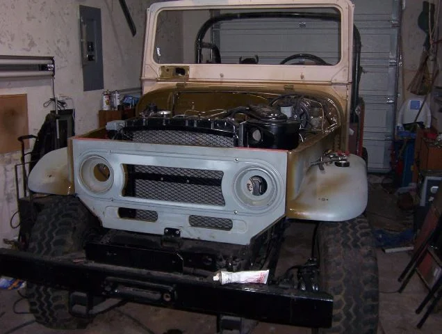

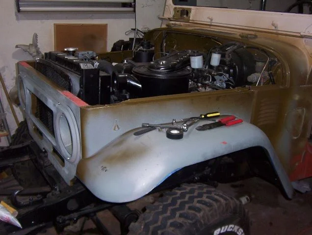

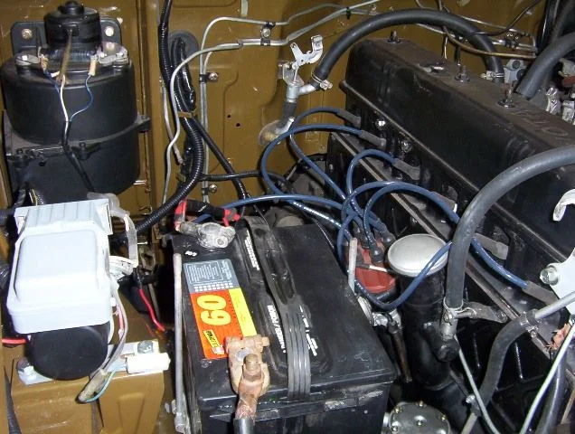

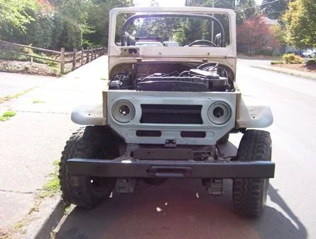

More Progress
Bolted up the front clip tonight. Test fitted stuff, made sure the wires all got to where they needed to go. Placed the coil where it was factory and not in the okie rigged location. Now I need a longer coil wire...
As you can see, I cut in all the painting inside the engine bay before mounting front end.
And most importantly, Bezel mounted correctly...

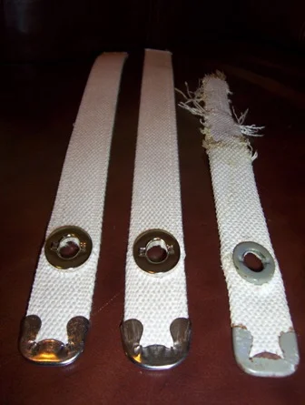

More
A couple more...
These are some jump seat straps I'm thinking of making for guys here on MUD.

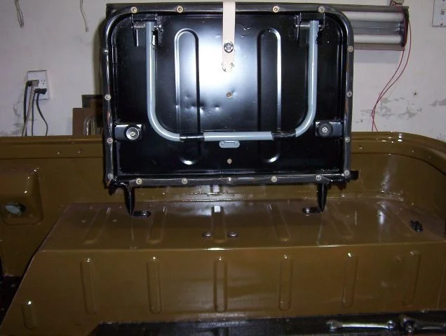

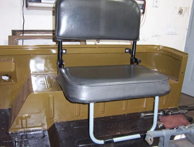

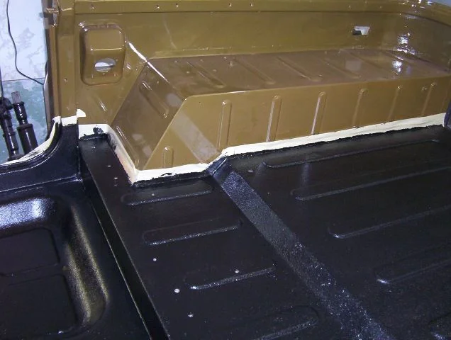

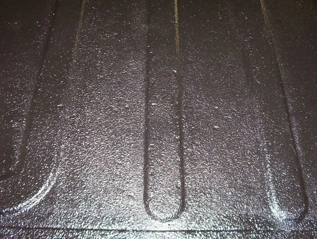

another update
Rear fender wells prepped primed, and painted, bedliner installed.
Sent seatcovers in to have new ones made. Was going to do jeep seats, but decided to stay OEM. Worked on Jump seats, got one installed, the other needs some finishing work, then it will go in. Got the rear amby doors completed by installing new lower door skins on both. Working on sides of hardtop and get those cleaned up. Lots of stuff happening. I'm hoping to wrap it all up in late Oct.

since these pics were taken I have applied another 2 coats of bedliner, (via roller with texture) and three new coats of paint. Will have updated pics soon. Interior should be completed by end of next week. Picking up seat covers next week...

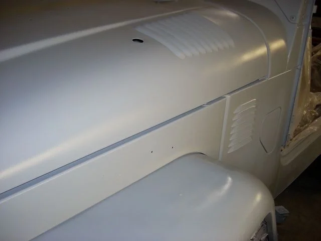

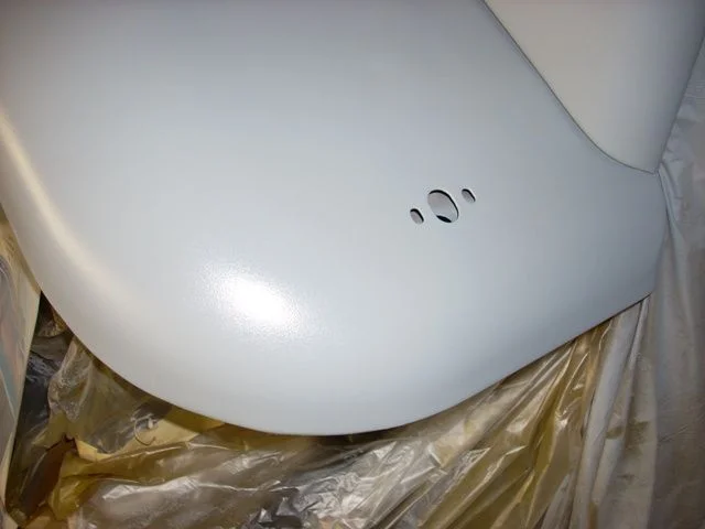

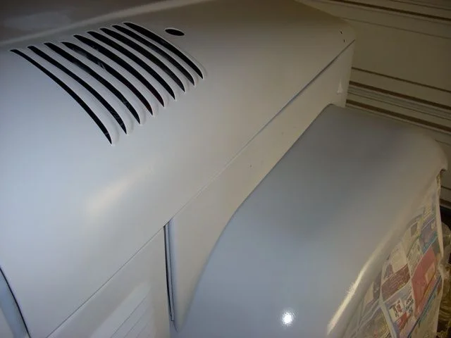

In Primer...
Finished interior painting. Now onto exterior.
Am going with the ACE brand tintable paint. Read more about it in the Paint and body forum.
Heres some pics. Coming along well...

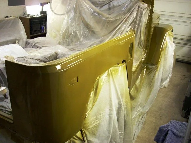

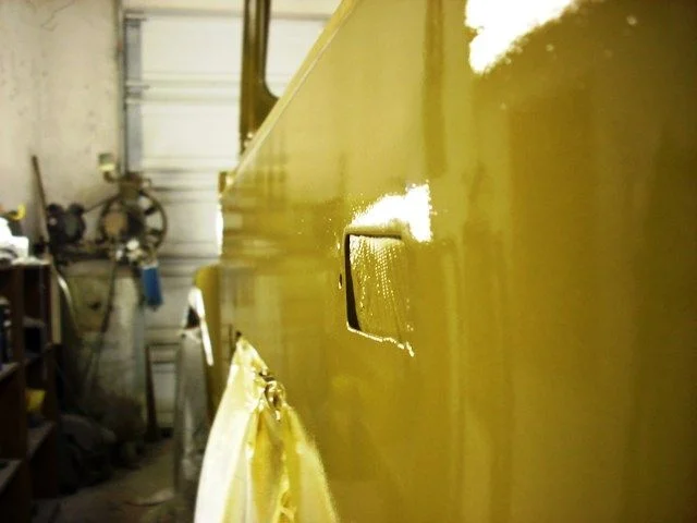

First color coat is on...
Shot the first coat of color about a half hour ago...
Used mineral spirits after reading some links here on MUD...
Mineral spirits is the ONLY thing you should use to thin this stuff... It layed down with almost NO orange peel. It should settle out very nicely!
The photos show after one light first coat. I will then be applying two additional coats getting heavier and wetter with each one. Will wet sand with 600 between first two coats, then wet sand with 1500 and buff the final coat.
Before I shot the first color coat I wet sanded all the primer with 400. Took about 3.5 hours from begin sand to finish of first coat.
Now the pics...

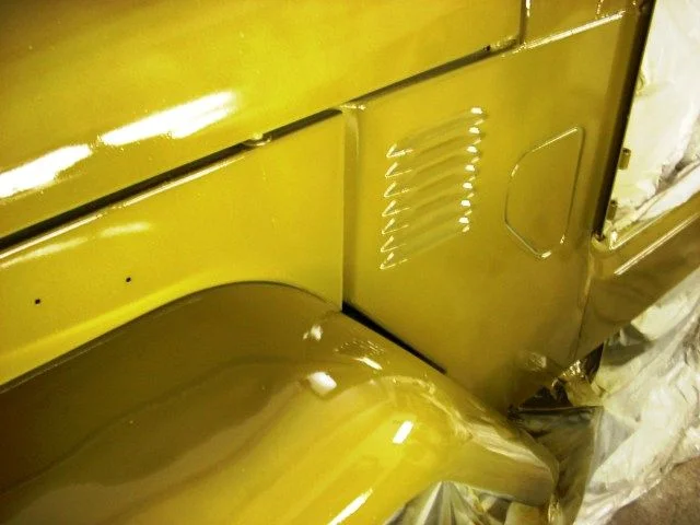

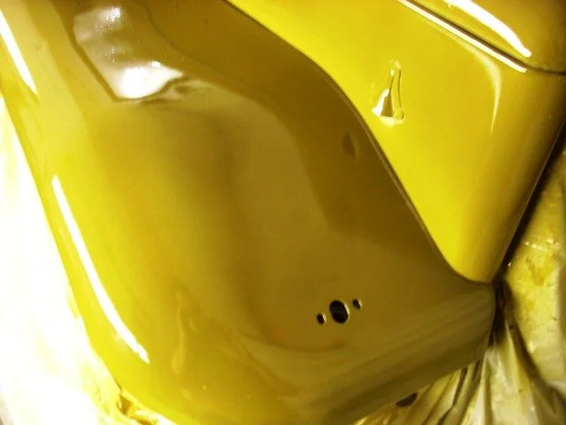

Posts: 771

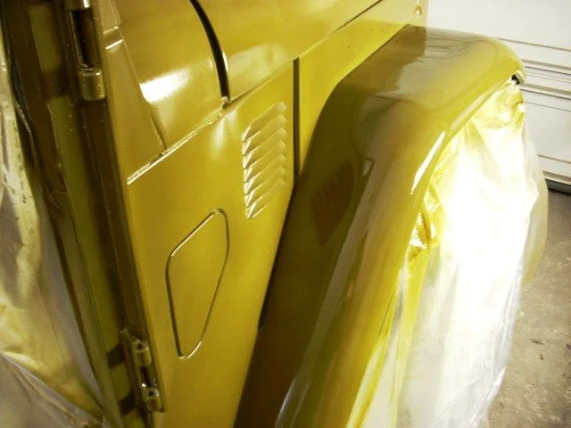

Couple more
Came out pretty good. Did get a little water spurt towards the end which I will have to deal with tomorrow. Going to run both compressors with a better water trap tomorrow.

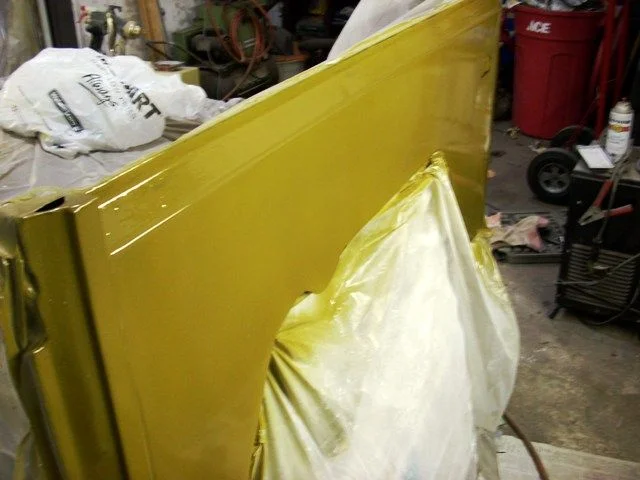

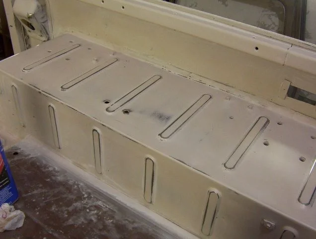

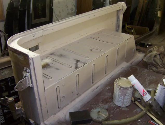

Coming along...
Got backed up on some extra body work I wanted to take care of. So I stripped a couple areas and made sure it was perfect.
Also decided on painting interior. Looks good I think. Next up are the doors, (which I have started on) and then shooting clear. I'm using LIC-30 Valspar binder for the clearcoat. Dries to a rock hard finish and looks great.

Almost done... I'll post some more pics up tonight.
Just installed gas tank cover, roll bar, and moving onto pass seat etc...
Getting the last little things finished is a PITA!!!

Wow... I'm impressed.
Very nice work. This is the first time that I've checked back on this thread since you first started it..
It looks awesome.

That is very impressive! Love the color and also the bedliner material.
Question. What are the holes for near the fins on the hood?
