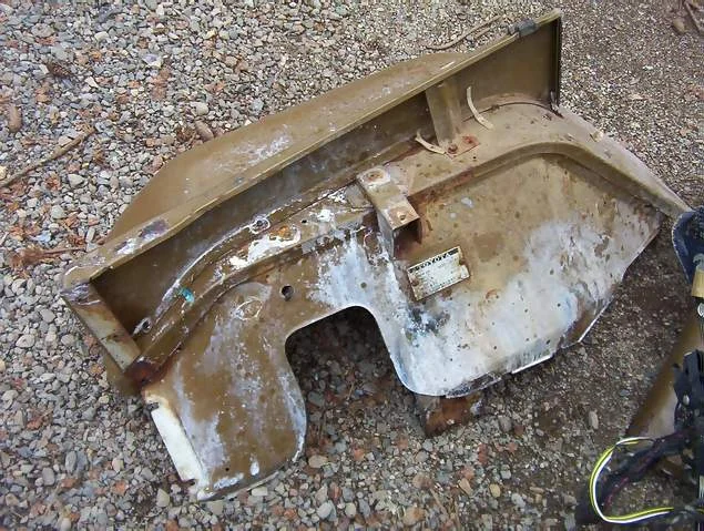

Took the front clip off today... Sending it all to the sandblasters...
Going to be doing a thourough clean up on the front end begining with wire wheelin and POR 15. Pulling and replacing all the soft lines, cleaning up the rest. Replacing "stuff" as needed.
The entire front clip sandblasted including the hood (where nessesary), fenders, bib, grill, bezel, radiator shroud stuff, was only $80.00. Good deal in my book.
The white stuff in the pics is phosphric acid to kill the rust... (works Great) same as Metal ready, and only 5 bucks a quart.

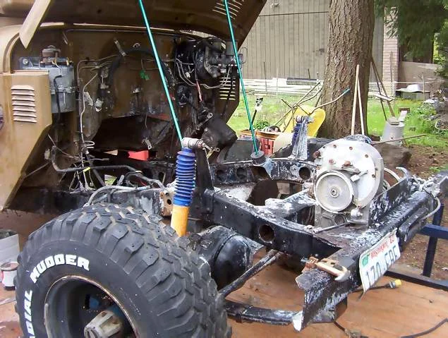

Decided to go body off on the resto. We pulled the body and blasted the frame.
Did the POR15 treatment to the frame and diffs. Cleaned up the underbody and shot POR on it as well. (looks sweet) Then placed body back on frame with new Energy Susp body mount kit.
Got the parts back from the blasters and got them into some NASON Epoxy Primer. (the two part 50% primer 50% catylist) NICE stuff btw.
You can see my 6940's rear end through the plastic in one of these shots. The pics have blurry spots... must be something on the lense.?

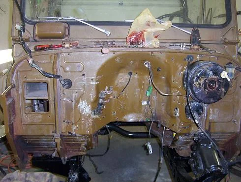

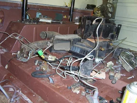

Finally got the rig over to my garage for the stretch run.
Pulling firewall stuff off for sanding, primer and paint. Going with a urathane primer and paint.
Should be puting the firewall into paint by Friday.
Also putting on a new Master brake and clutch with lines...

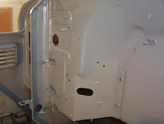

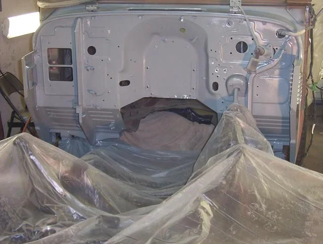

Primer Prep
Got a solid 6 hours on the 40 yesterday.
Dismantled most of the firewall, inside and out. Spent about 4 hours just sanding the outside of the firewall using a DA, , drill with wirewheel, and good ol' paper. Took the heaterbox apart for a restore, and found a nice nest fit for a family of mice.
Pics are of a big mess, firewall, and the NASON primer I used. Good stuff.

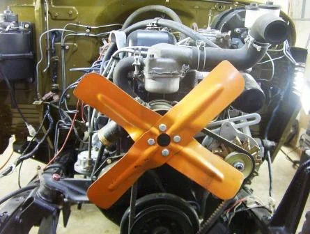

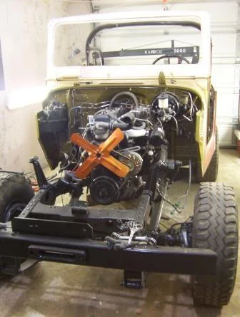

Another Update, Engine Installed

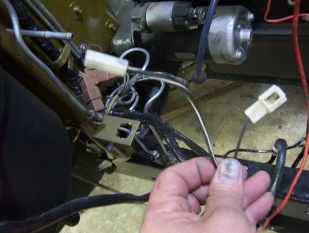

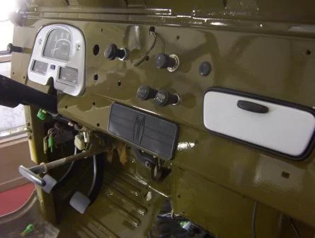

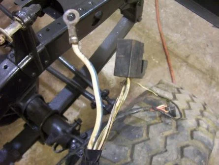

Finally got the engine installed.. now I'm having issues with wiring. Can anyone identify the wires in the photos?
Dash is coming along as well... Do you like the black out treatment on the ash tray trim? or no?
And yes I am installing a F155 into a 76. Its been rebuilt and is SOLID...
It does have the 4 speed etc..
Anyways pics...

The wiring in post #49 looks to be either the horn or headlight wiring. It will probably make more sense when you get the fenders and bib back together.

I think your right, Its up front but the colors threw me a bit. The first pic of wires (the BW ones) I have no idea where they go. Plus I have the wonderful task of mating a 76 wiring harness to a F155 Engine. Lots of "extra" wires I would imagine.

Keeping on...
I guess this is turning into my resto thread...
Got some work done this week. Installed dash switches, and wired em up, installed water temp wiring as I could NOT find the damn thing, Installed radiator, installed all wiring minus lights and a few tidbits.
Went to the yard, and found some nice OE hose clamps. Also found that a chevy cavelier has very good seats for installing into a 40. Will need to add some cross braces but the mounts are all flat which is huge for getting them into a 40.
Anyways, some pics of my progress to date.
Wiring goodies. Had to rewire the alternator as it sits on the drivers side on a 1F, but is wired for the Pass side on a 76.
New dash switches. Thx Degnol!!!!! I added some white crayon and they came out real nice.
Water Temp gauge wire. Going to add it into the loom. So it doesnt stick out too much.

2F Alt Bracket
Quote:
Take a good look at the lifting hook on the front pass side of the motor. The 2F alternator bracket will bolt right up in place of this hook and leave the drivers side open for a power steering pump in place of the F alternator if PS is on your list of future mods.
Are you in the Salem area? Or am I getting you mixed up with someone else? I'm just off I-5 about 2 miles south of the Santiam River bridge.
Looking good!
Oops! Just looked back in the thread, you are in Salem. Only a hop, skip, and a jump away!

I thought about doing the 2F bracket. Can you get those from NAPA?
Also, will I need to get a new fan belt with the relocation of the alternator?

No, you have to get them off an old 2F motor. I got mine from Mark at Marks Offroad. Very fair to deal with too.I don't remember what I paid though.
If I remember correctly I just got a belt for a 2F alt, anyway it is NAPA # 25-22495 .The belt for the F engine alt will be too short. The Toy alt should bolt right up with no problems. Howev
