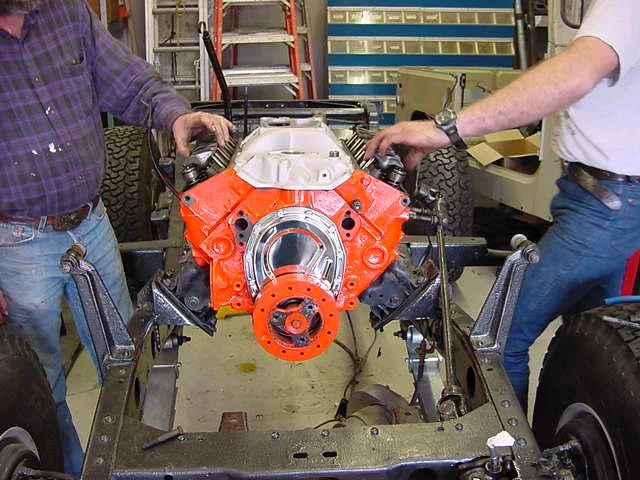

I found it much easier to remove the entire body, makes things much easier. Also in my experience, most of the bolts are going to break. Might as well get ready to invest in a lot of new ones, a good grinder, drill bits, and some easy outs. Good Luck, keep us posted!
