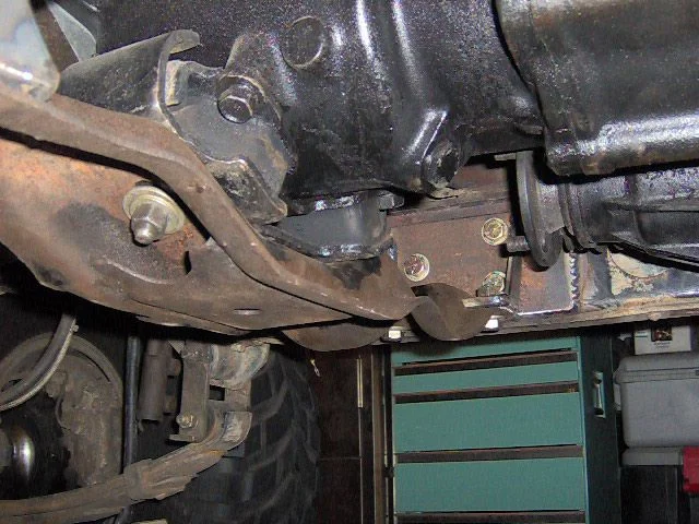

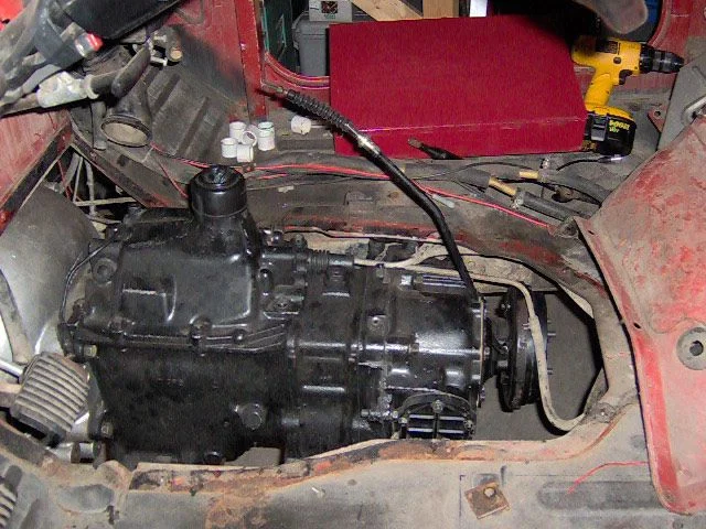

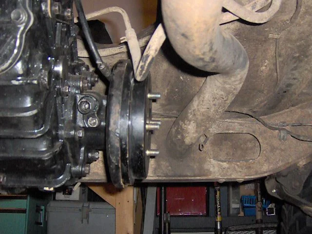

Brets pics:

Mmmmmmm.... I love the smell of a new H55F
The money is all worth it when your side by side with your pal in his H42 equipped rig... and you drop it in 5th and say good bye!

I would much rather give my cash to MUD vendors than the others. Who's got the parking brake kit here? Poser? Kurt?

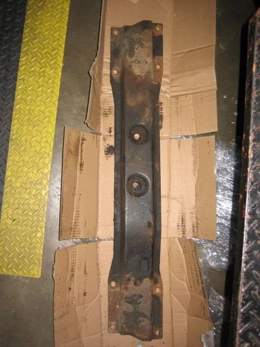

Received my tranny support this week. Just need to grab a few more parts and get this thing going! Are there bushings that mount between this crossmember and the tranny? Good source for the bolts?
Ohh... now I see them on Bret's pics.

The isolators that are pictured above came with the tranny. They bolt to the tranny, and the isolator has bolts that stick through the x-member.

They didn't come with mine and I'm having a hard time finding them on SOR, MAF or here: http://www.ih8mud.com/tech/60pdf/serie6_chassis.pdf.
Anyone have a P/N or vendor? Same as the 4 speed?
