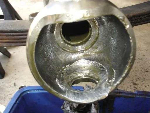

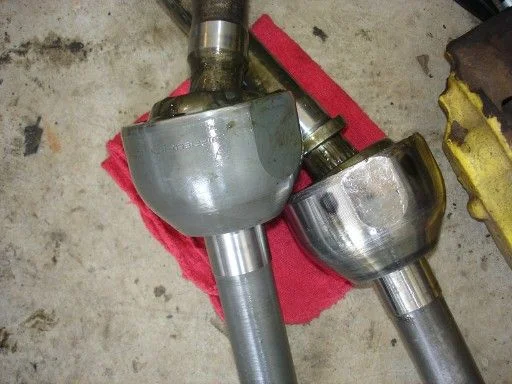

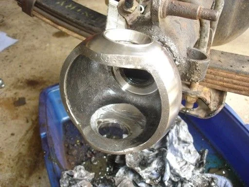

Finally sold my bike, so that freed up some room in the garage (not to mention $$$), so I at long last got to tear into my front end.
I started with the passenger side since that's the side that was making some strange noises before. Basically, when I'd turn left hard (at the stops) going slow, the passenger axle would make some funny popping noises, and the truck would lurch with every pop. I took it apart yesterday and I couldn't see anything that looked messed up. This is my first one though, so I'm not sure I'd notice if something was wrong. Nothing was broken or damaged in anyway though. It looked fairly new.
So today, I decided to time myself at the drivers side. At about 1 hour, I had the whole thing toar down with the exception of pulling the birf and inner axle out. Finally got them out after a lot of coaxing, wich screwed my good early-on pace. The inside of the birfield housing looked all sorts of chopped and dinged up. PO must have been in there at one time.
Now looking back, and going through my tech manual, I'm noticing that I never took out a snap ring like the manual and this forum says. there wasnt one in there.
Another thing I noticed is that the outer axles are different. the one I pulled out of the passenger side (the duller of the two below) has 'birfield' stamped into the side of the ball end. The shiny one from the driver's side doesn't, and was the hard one to take out. It just has some numbers stamped into it. Anyone know the differences? The flat parts on the shiny one are smaller, so that could have been a reason it was so hard to get out.
Oh well, here are some pics:

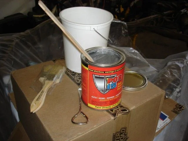

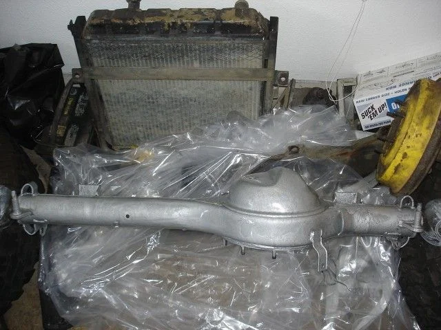

I then decided to give por-15 a try on my front axle. I wire wheeled it, then used Marine Clean and Metal Ready. I just put on the grey Por, and I've got the Black coat to put on it next. We'll see how it turns out...

Posts: 1,756
You must be die hard to part with your 2 wheeler... I lose my mind without mine. My only method of therapy is my bike(s). My gal has threatened to leave me over the cruier and bike madness several times, I guess she finally figured out I'd live in a garage with my toys and not be broken up about it.
I've enjoyed this thread as I'm working on a 78 right now too. I finally started to drive it a few weeks ago. well until the knuckle job anyway. keep posting up those pics!
__________________
1978 (mostly) FJ-40, lift, 2F, bigger tires and custom swiss cheese body panels to reduce weight!
Various other toys 87 4runner, Motorcycles Ducati and Triumphs with an old Mach III in the mix.
06-12-07, 09:22 PM
#47 (permalink)
250+ Club
Join Date: Nov 2006
Location: Charlotte, NC, USA
Posts: 344
Mike,
Looking good and you are basically doing the same thing as me. Since you are this far into it, can I offer a suggestion? Go ahead and pull the engine and the other axle and take the frame to get it sandblasted and powdercoated. It seems like extra effort, but it will save you time in the long run and you'll probably spend 1/2 of the cost anyway on wire wheels, sandpaper, and paint.
It took me ~3 lloonngggg weekends with a heavy-duty wire wheel on my grinder plus some 80 grit on my DA sander to get the rust off my frame and prep it for paint. But since I didn't pull my engine, the frame rails facing the engine aren't accessible and thus are still grime covered. One day when I do an engine rebuild I'll also need to re-do my frame in the engine compartment.
Once I had the frame prepped it took me 2+ more weekends to paint the frame with POR Hardnose. Make sure you mix the Hardnose paint 100% accurately or the finish will fisheye really bad. I had to sand down the first coat and then go back and recoat it again. It actually helped fill in the surface pitting on my frame, but this is the 2nd and last frame I'll hand sand and paint.
For my axles, I just wire wheeled them clean and POR-15 base coated...before it dried I dusted it with self-etching primer and then followed up with multiple coats of Krylon semi-gloss. The axles are going to get scratched and dirty on the trail, so my thought was to make future touchups easy.

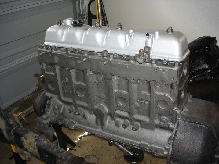

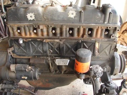

Finished block. Still have to paint all the little odds and ends though.

Looks Great!, now go over that cast finish with Clear engine enamel, you'll be happy!!!

Sweet! Will do.

looks just like mine too... do like Ed says... Clear it you will not be dissappointed!!! looks great!!

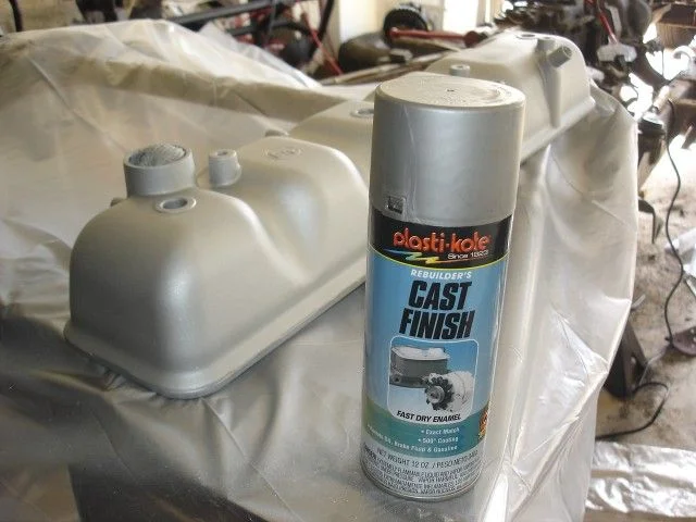

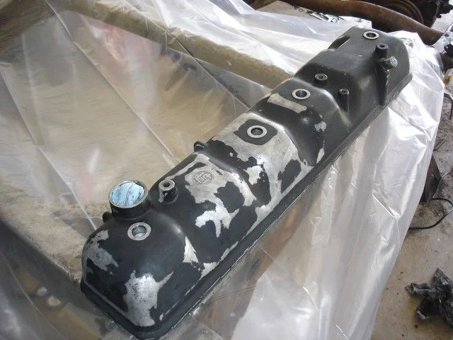

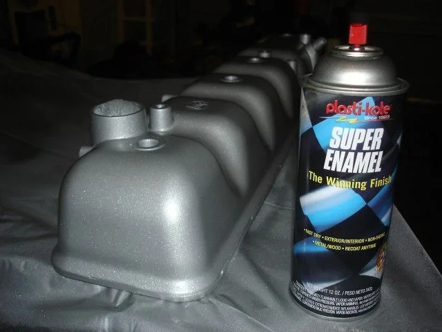

Would this enamel be okay?
I used it on the valve cover already:

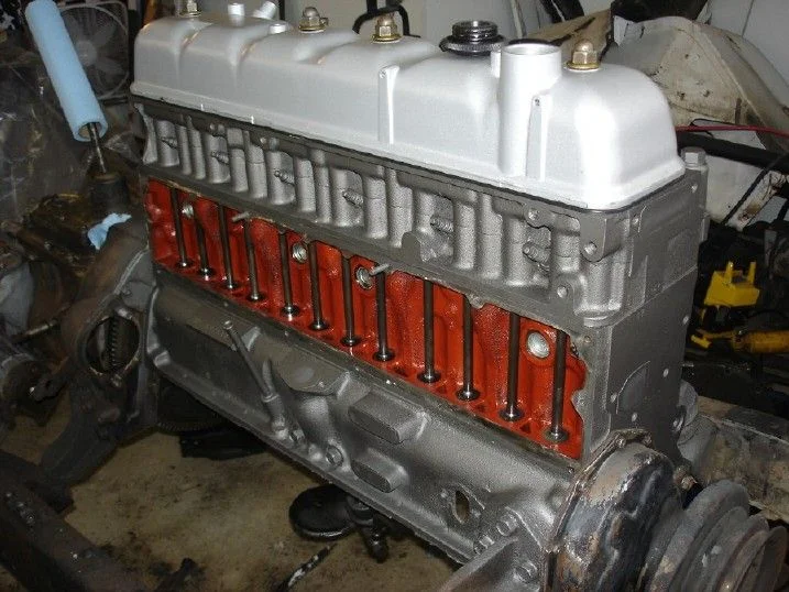

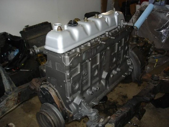

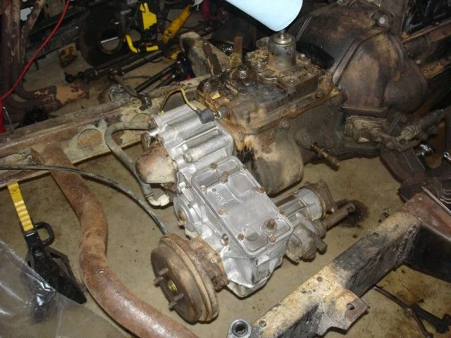

Almost done with the engine, tranny and transfer case. Cleaning and painting are done atleast. Now, I just have to put a coat of clear over the transfer case and odds and ends, then I'll be done... time to finish off the frame now I guess.
before and after pics:

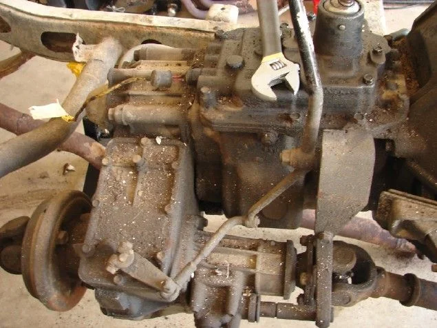

#60 (permalink)
The Real Gunslinger
Join Date: Aug 2005
Location: Honolulu, HI
Posts: 365

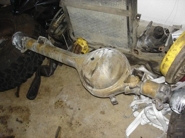

before
