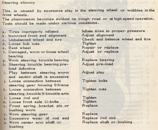

Death Wobble (FAQ?)
Alright I noticed that there isnt anything in the FAQ about solving death wobble...and It seems like a common enough problem that maybe this could go into the FAQ
Im looking for a list of all of the possible causes of death wobble. Having allready seached, it seems most of the threads are very specific to peoples vehicle.
Thanks for any info.
EDIT: HERE IS A LIST FROM THE FSM (THANKS IDAVE)
Name:  wobble (Small).jpg

Location: McCall, ID
Posts: 6,740
Toe In
Forgive me if someone else answered this already and I missed it.
The toe in should be 3-5 mm according to the FSM for an FJ40. This means that the distance between the center points of the two tires should be 4mm less in front than in back.
I have read elsewhere that this determination is for bias-ply tires, and that for radials, a toe-in of "0" is correct.
I would certainly fix the "penguin-toed" arrangement you describe.

Posts: 6,740
Wobble
A succinct list of causes and repairs from the FSM, most of which have been mentioned.

Thanks IDAVE, thats exactly what this thread needed!
