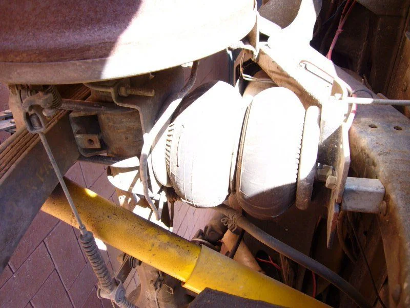

My Cruiser and the Airbags
Unfortunately I have little idea of what I am doing on this sight, But I think I have posted one pic of the Airbag setup. I might try setting up a web Album and posting all my pics on that, then posting a link for you to look at

Hi Mal,
Thanks for the pic. Can't wait to see the rest of them. How is that top mount attached to the frame?

I have to admit, I have been slack, The kit came with the plate you see at the top and 2 square U bolts and a top plate for above the chassis. Now I haven't lifted my body so I couldn't fit the top plate so I could fit the front U bolt without the top plate , but then I used a small piece of square square tube and a bolt hole from the bump stop mount, Ultimately I will be welding a couple plates attached only to the plate you see there now and running a 2 bolts to pull the plates togetheraround the chassis rail. You might notice the plate below the chassis has a curve in it at the front I had to do this so as to get the plate to fit to the chassis curve. Maybe if you have raised your body you can use the supplied plates and only have to worry about that curve and a means of packing the rear as I have done. The bags do stretch quite a bit but you fit them so the limit of your travel is about the same as your bags. I only really run more than 10 lbs air pressure when I have the old girl fully loaded and then it rides flat. 10 lbs is the min recomended at any time. I might try reducing the some more images further so I can post them on here, so this one will either go or be down sized. I sent a PM with other contact details for where I got the kit, did you get it?
