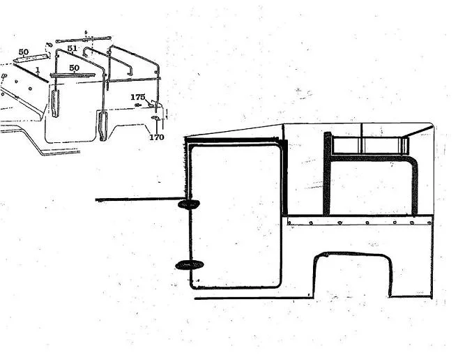

I call these "MINI BOWS". I included a reference sketch of OEM bows.
OK, here is a sketch showing the profile of Mini Roll Bar rack with mini bows erected. The bows on the rack are easily removed or possibly folded back into the rack. Some elements of this top may stay in place such as the main bow that the doors rest against. Or perhaps the main bow can break into a few parts and the overhead section could be removed while the pieces that surround the door stay in place. You can see that there is less overall frame support, especially on the sides of this soft top system. But I don't think that those areas require much support.
Another thought that comes to mind is from a "bicycle tent". I remember these tents that long distance bikers would carry. They had some sort of internal frame that I was told was metal. The entire tent would roll into a pack, frame and all. To erect the tent, you flung it open and the frame would go rigid-- at least rigid enough to support the tent. I can't help but wonder about its potential for a "packable soft top".

Quote:
Without having something right up against the clear windows, it was suck in and look like a bra from the insde out. imagine an egg crate looking down and turn it on the sides. that is what the top would like like above the windows. The abck sucks in also but due to pressure, tends to stay fairly flat. Something needs to be supportive right up to the window since the air pressure is less inside the rig when moving. Everythign sucks in, except the top which pushes out. Unless the sides had something to keep them from sucking in, they would have to be VERY tight, then we are back to difficulty monting the soft top and it woud rip after a while at the seams from the pressure exerted on them.

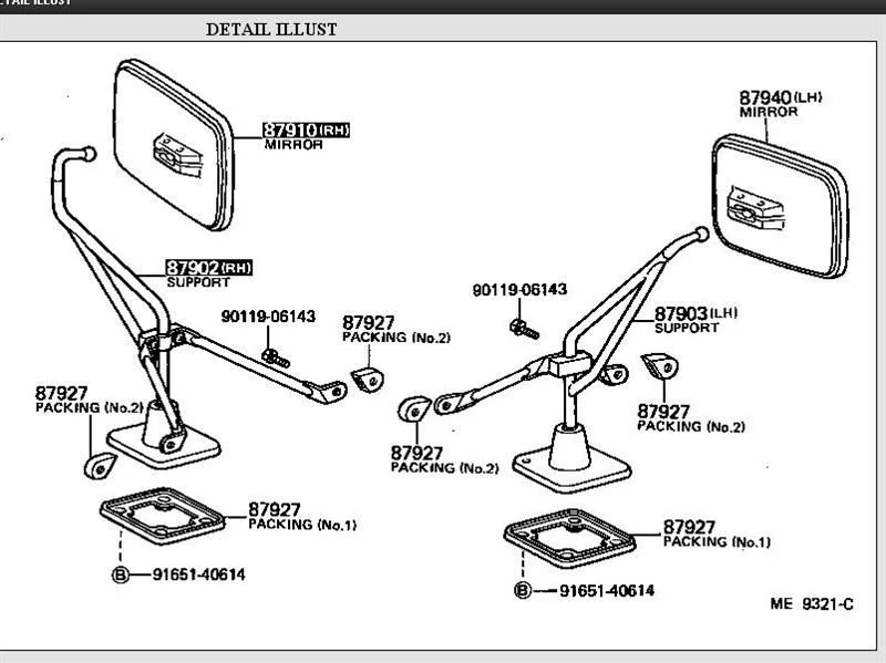

intersting the mirrors on that thing are oem ,sorry if a little off track ,
