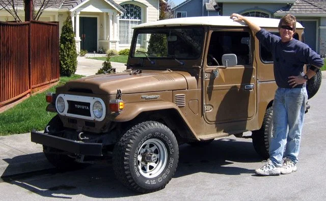

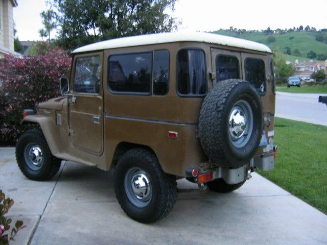

These two pictures, including the PO are from the day I picked it up. This was April 13th, last year, so I've had it exactly 10 months. I'm happy with the progress, but I wish I'd done more wheeling.
He charged me an arm and a leg, and wasn't completely honest, especially about the brakes. OTOH, I've sold a couple $thousand worth of the parts he saved, and used many more myself.
When I got it there was a residual valve in the front disc circuit of the master cylinder and one of the pads was metal-on-metal, tearing up the rotor. I still haven't replaced the rotor. I put in some Kragen pads shortly after which will get me to a future front end rebuild.
My goals have been to continue to make it better for a fairly low budget while keeping it running as much as possible so I can enjoy it. I've gone on two wheeling trips and 3000 miles on it in a year. The longest it was down was from Thanksgiving until New Year's getting a new carb and exhaust.
It's a survivor. The paint is all original with four major areas of rust. It's not getting worse, really, despite living in the driveway. It's only rained 5" here since I got it.
The only thing that was not original is the engine. The PO hot-rodded the original engine and told me that over 6000rpm wasn't a problem. He cracked the crank. I've got it on a stand, covered up in my back yard awaiting a future rebuild. He also included a nice spare crank which is safely stored away in the garage.

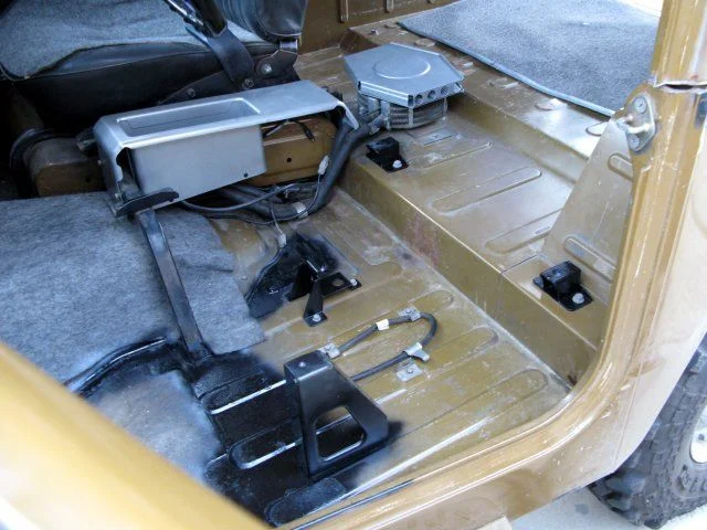

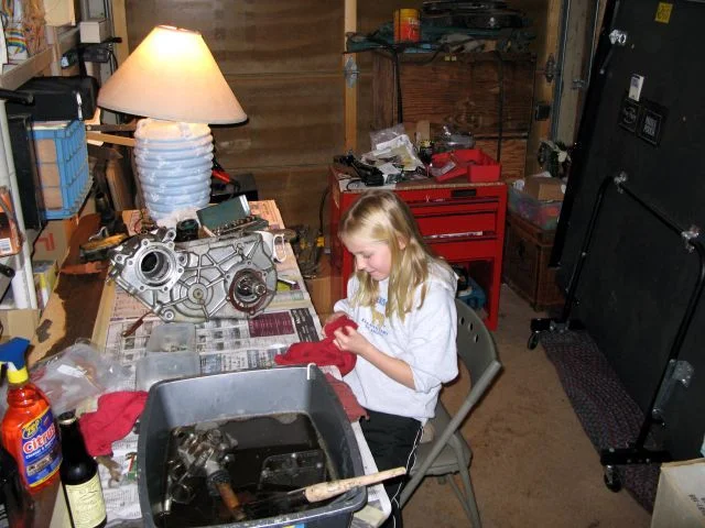

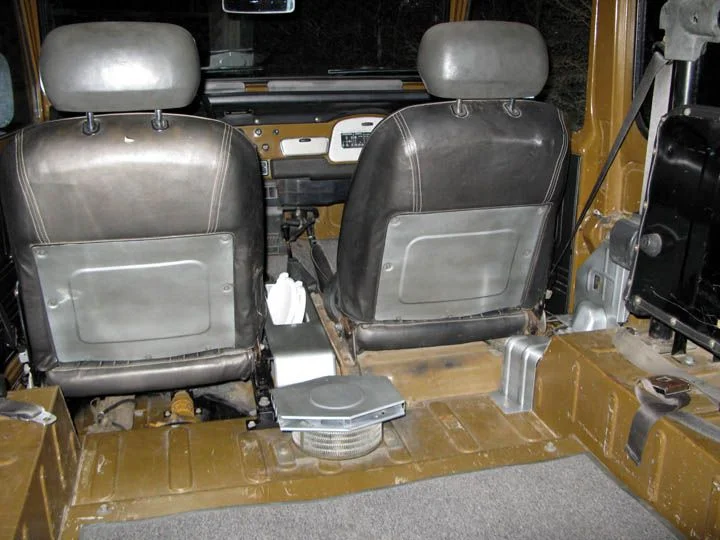

The first weekend I spent sorting through the truckload (literally) of parts I got with it, and using the obviously-better parts like the mirrors.
I installed the jumpseats and eventually all the original seatbelts. Here's what it looked like after removing the PO's woodwork and taped roll bar padding job. You can kind of see a rust hole peeking out of the sill on the left. Unfortunately you can't see the 3/8" nail that is taped to the bottom of the left door to get it to close.
Books and records. It came with these and two FSMs. I think I paid about $1000 for them.
Someone likes it though.

very cool!
great pic of the kid

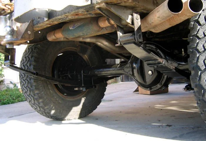

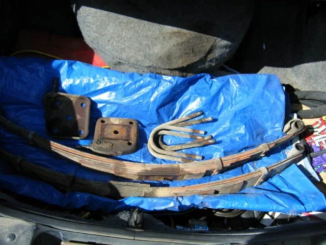

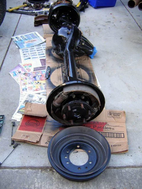

First big repairs

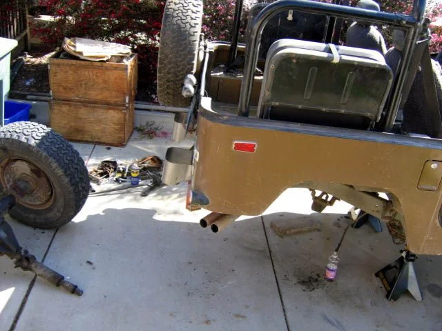

I got a spare rear end with the truck, so instead of dealing with the brakes, input shaft bearing and seals on the old one, I cleaned up the spare (<30k miles according to the PO) and had the springs rearched.
I always think I'll bring it back to the spring shop to have him massage a bit more of the cruiser lean out of it. You can see the difference between the shackle angles in the last picture. The u-bolts and plates are the only thing I've had powder coated so far. They came out nice, but not 10x nicer than rustoleum, so that's been my weapon of choice since then. You can take the boy out of the farm, but...
A year later it needs a seal on one side, so an Aussie locker is in my immediate future if they ever get any in stock.
Notice the dual exhaust. It came from a 2x3 header.

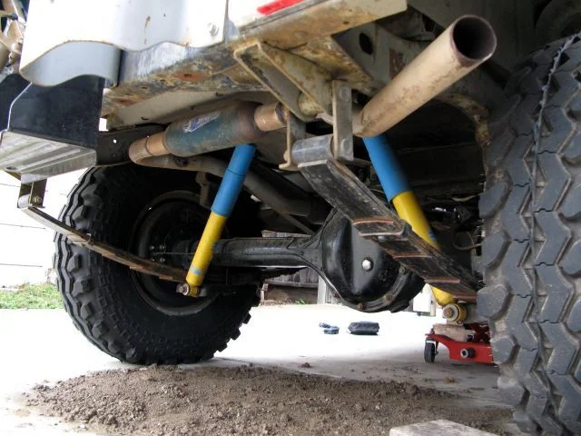

At the same time as the brakes and rear end, I splurged for Bilsteins.
My steering rebuild included new: - shocks
- spring bushings
- steering stabilizer
- rag joint
and: - stock steering wheel
- tightened up center arm and drag link
You can see the steering wheel that came on it in the picture of the new mirror above. It was a well-used leather Grant from about 1980. The PO wanted it for his garage wall, so I gave it back to him. In exchange I got him to go up into his attic for my soft half-doors and the original steering wheel. You can see the stock wheel above with the tach and radio.
With these fixes and the skinny tires in the more-current pictures below it drives great!

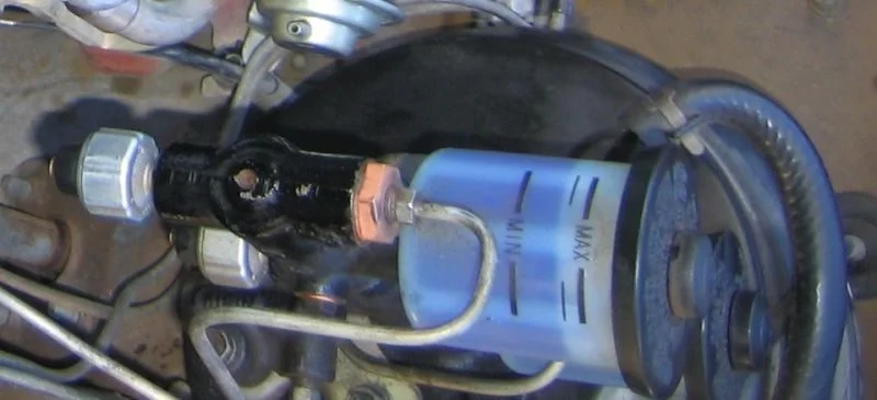

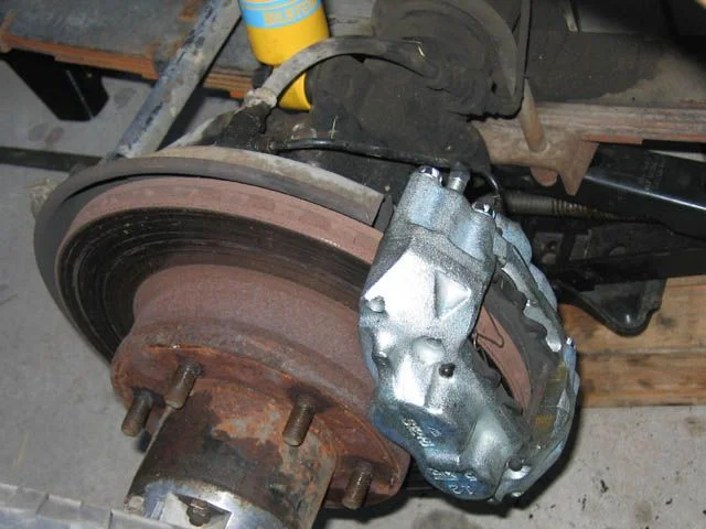

Brakes
The brakes are a sore subject for me. I always have considered myself to be a    mechanic. During the brake rebuild I made a bunch of mistakes and do-overs and got discouraged and depressed. I bought parts from the shaman and got the wrong parts twice. He actually told me I was the first person to get mis-boxed from Toyota. He told me this twice in two weeks.  Being the kind of guy he is he made it right without question, and then some.
Eventually I got it sorted out, but my 'new' master cylinder now needs to be replaced to make them perfect. I cracked the front piston and it scratched the cylinder. It's good enough for the street, but I suspect it won't hold on a steep hill.
The jury's still out on DOT 5 silicone brake fluid. I've had the master apart and the seals seem normal. My last resto was a '69 Corvette 427 3x2 bbl L71 Convertible. No one ever hesitated to use DOT 5 in those, and I wasn't warned about it until it was in my Cruiser. I've heard it's very hard to get it cleaned out, so I'll be the guinea pig for it's use in a Cruiser.
I had the rear drums turned a tiny bit just to remove the rust. The shoes are original and 75%. I replaced the cylinders after this picture was taken, just so the whole system would be new.
The picture of the front rotor is the one that was damaged due to a completely worn out pad. It's still working pretty well. I replaced the soft brake hoses sometime after this picture was taken.
The booster originally worked, but went bad while I was working on the brakes. I got two used ones and ended up using the one from a '91 4 Runner. It barely fits, actually touching the hard brake lines on the right side of the picture.

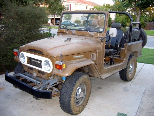

Steelys
With my truckload of parts I headed over to Stockton to George's (OrangeFJ45) swap meet. I arranged to sell the wagon wheels and tires to one guy who drove down from Sacramento, then bought these steelys from George for the same price!
This picture is before the spring work, so it's still sitting low. I love the look with the stock steelys and hub caps.

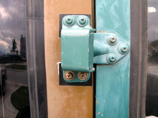

Preservation, not Restoration

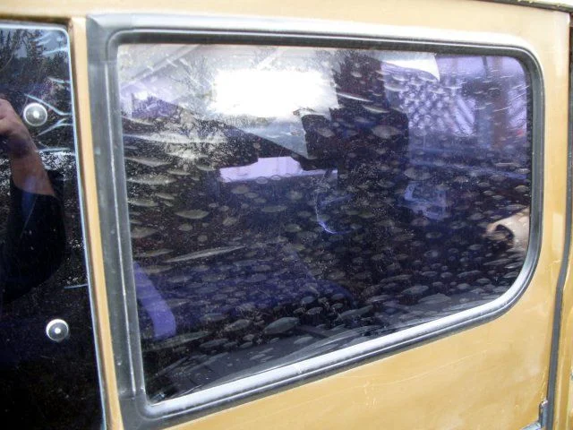

An early picture with the original ambulance doors. Body work isn't my top skill, so I've since put on the spare doors and deferred that part of the body work to someone more capable.
I used every original screw I could find in my copious stash. It turns out I had a full set. I sanded the rust behind the hinges and painted the spots with Rustoleum for now. Many of the holes were too stripped out to hold a screw before. You can see in the top picture, many are missing. By running a tap into them, then being careful when tightening, every hole now holds tightly.
As you can see, this isn't really a restoration, so much as preservation. I'm like an undeclared major. I don't know where I'm going, but I'm on my way.
I haven't done any body work or rust repair to the replacement doors yet. I did go around the rain gutter before I put the top back on in the fall and sand the rust, prime and paint it the wrong color. I'll make someone a fine PO one day. It's almost not noticable when you're standing there looking at it. This picture makes it look worse than it actually does.
Note the original Dunlop Sno Cruiser spare. I've got two.

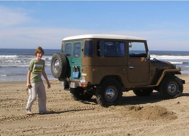

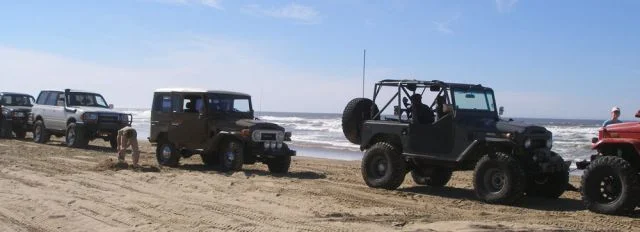

Our 2nd trip was the big one. Surf & Turf '06! It was awesome!
We got stuck about 30' from where we turned onto the soft sand at the camp site. Some helpful mudders recommended 10psi and we spent the rest of the weekend unsuccessfully trying to get stuck. There were a few dunes that were too steep and tall to make it up, but we never got stuck. The little Swampers rock!
Here's my trusty copilot and son, Nick. He's digging a jeep trap.
Check out the stylish green doors. They close well and I've got an original key that works after swapping the lock cylinder.

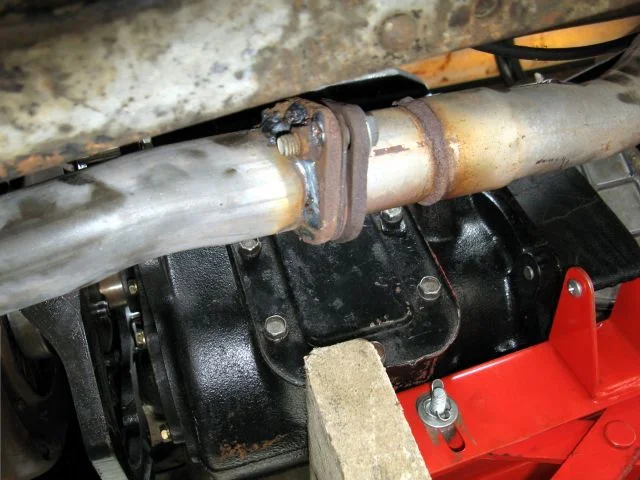

Carb and Exhaust
It came with a Holley and dual 3-into-1 headers and dual exhaust. I suppose it was a bit more powerful, but all of it was old. The Holley caused the motor to stall exactly twice in exactly the two most precarious spots we ever got ourselves into. It threatened to stall a bunch of other times. The header flanges were a mass of embarassing, noisy leaks by the time I took them off and sold them for beer money.
All the smart money on the board is on rebuilt original Aisin carbs. Mr. PO saved mine for me nicely. I met and wheeled with Mark A. of Marks Off Road Home Page at Surf & Turf, so I gave him the nod and sent my carb down when we got home.
It wasn't free, but the result is very nice.
This is the first set of hard lines that I bent up. I made a few more sets, kept the best set and sold the rest.
In parallel, I had the rusty original Thermal Reactor exhaust manifold sand blasted. This revealed a few little cracks, which I patched with a Permatex product and otherwise ignored. Then I painted it with Aussie Nu-cast VHT Manifold Coating Paint. It's holding up ok so far.
After another bout of brake issues and finally getting them figured out, I got it to the muffler shop. They reused one of the dual pipes, and its two cherry bomb mufflers. I had them take the 2nd header flange and bolt it to the first, then weld it all up to a SOR-bought exhaust manifold flange. This way I have a 2' removable section of pipe just behind the exhaust manifold so I can get it out of the way if I need.

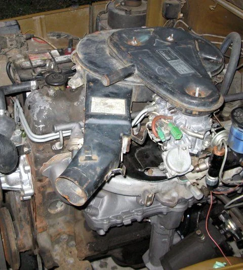

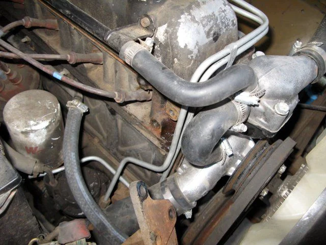

More Carb, Exhaust and Fuel Lines
I'm a bit embarassed I didn't do anything to the air cleaner that's on top of all this work. I'll get to it. I even used the stale old air filter that's been stored in it for 20-odd years. Not pictured is the cold-air extension that takes the air from in front of the radiator, near the hood latch. The PO saved it all. You can't see the $60 exhaust manifold bracket either. I guess I should thank him.
You can see the final routing of the hard lines we made.

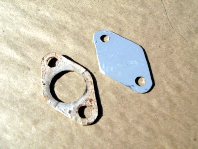

And the EGR block-off plate we made. I've got the EGR parts, but I wanted it on the road. It will need to pass smog less than four months from now.

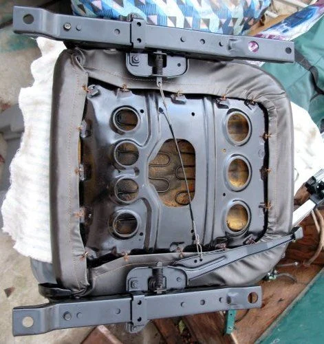

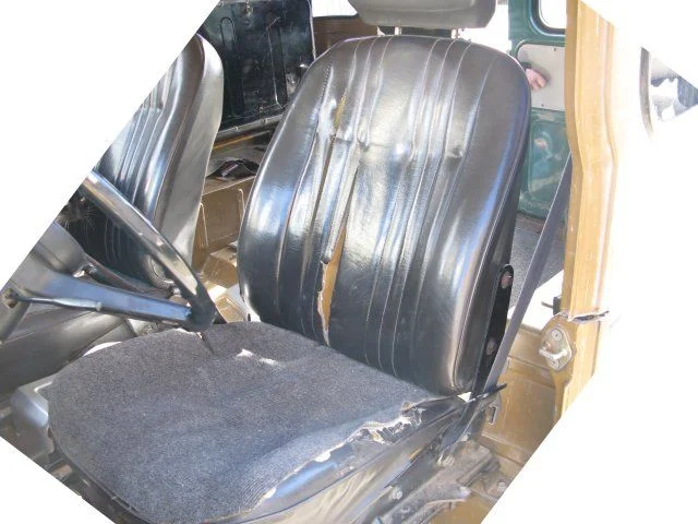

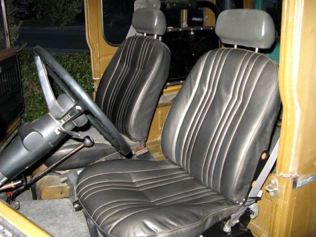

Seats
You can see, in some of the early pictures, the ultra crappy seat covers. My kids liked them for some reason, so I kept them on until I couldn't stand looking at them any more.
The passenger side seat back is in nice original shape. The driver's back was pretty torn up, and the seat bottoms had some stylish indoor-outdoor carpet glued to them.
I shopped around for some new covers, went to a shop and got a quote, and eventually ended up buying one good used '76 passenger seat cover from member FJResto for $100.
I put it on myself and painted the frame and brackets with Rustoleum. You can see some more evidence of preservation on the floor. I wire-brushed the rust, primed and painted with rustoleum. I'm starting to think about having just the floor done in color-matched Line-X. There's a large spot under the clutch pedal where the clutch master leaked fluid and took off all the paint. I haven't done anything to it yet, and it's rusting some.
I'm still looking for a seat bottom cover for the passenger side.

After
The '76 seat has one additional rib instead of a stitch that's almost not noticable. There are some extra holes towards the center because this was a passenger seat originally. I added some foam on the outboard side of the bolster that looks and feels like crap. I'll probably bring it to the shop where I got a quote and have them fix the seat bottom foam, now that I know it matches well enough.
The passenger side is waiting for someone to sell me another seat bottom cover. Hint, hint...

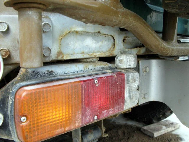

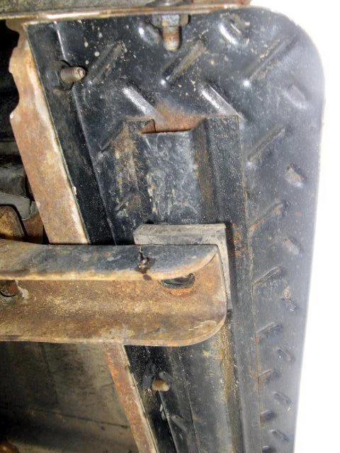

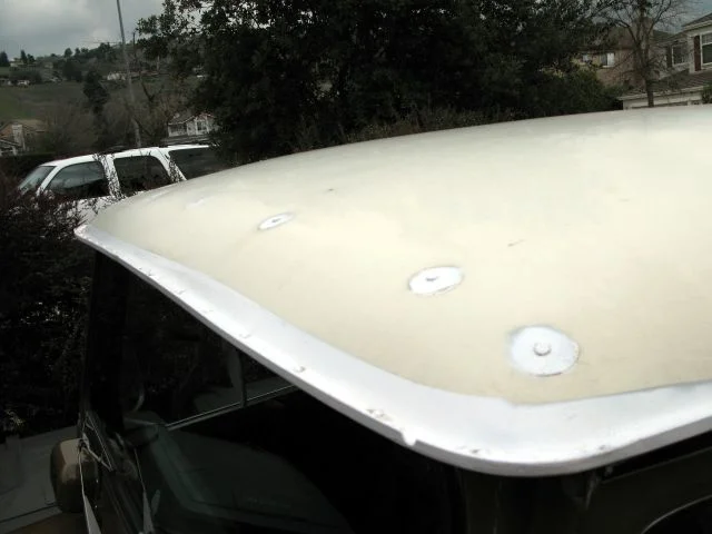

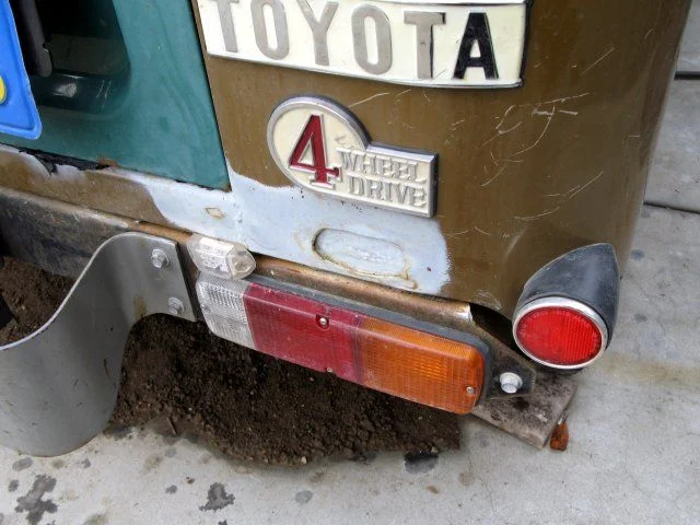

Rust
Compared to many I've seen, my rust isn't bad, but I have some. I'll get around to patching it all this year. I promise.
You can see my little LED trailer lights above the backup lights. The red color of the '4' is fingernail polish.
- Right rear
- Left rear
- Windshield

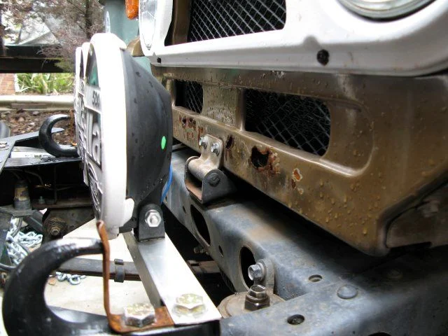

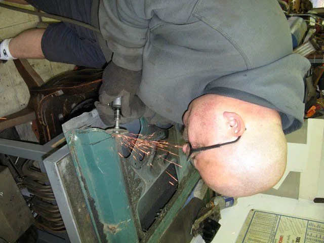

More rust
The bib is kinda tough to deal with. I've got another damaged bib for a donor, but this part is somewhat structural and there are two pieces spot welded together. I'll dig into it one of these days. In the meantime, you can see that it continues to rust.

Low-Cost Low Gears
I posted this somewhat controversial thread in November.
http://forum.ih8mud.com/40-55-series-tech/119382-low-cost-low-gears.html
After wheeling a bit my co-pilot and I found we wanted lower gears. The stock crawl ratio is about 28:1, so we had to speed a bit up steeps to keep the revs up. Then, coming down I had to use the brakes some. On steep downhill dunes that will toss you sideways.
So, my solution was to aquire an H41 from http://www.marksoffroad.net and mate it to a 3-speed transfer case. Member MustardFJ40 is upgrading to an Orion and he sold me his case for a great price and helped me with some tools and parts. It came complete with the gear and bearing to make it work with the four speed.
Much thanks to D'Animal for hauling my tranny around with him for over a week on it's long trek from Burbank to Morgan Hill via Vegas and Exeter.
It turns out that there's a '78 only (?) top-gear switch on the top cover. I wanted to retain that so I swapped that over to the H41 and muddled my way through connecting the case and the tranny. I didn't take a lot of pictures. Poser's thread is way better than anything I would have come up with. Speaking of Mr. P, you may recognize his transfer case saver on there.
My little helper and I cleaned up a bunch of junk in the garage and made a proper work area. I often just work out in the driveway, but rain was forcast and I didn't have time to wait it out.
I had to separate my old transfer case to reuse the speedo parts, a couple spacers from the input shaft and the covers.
I really wanted to use the stronger front output housing from the '78 case, but I stopped short of that. The 3 speed is all together, and tearing into it for a part that is only marginally stronger isn't on the top of my list right now. Maybe I'll keep it and do it later.
The old tranny and case were leaky as is my engine, so there was some pretty serious cleaning to do. Motivation was supplied by the local El Toro Brewery and their Centennial Ale. Yum. Foreground left in the first picture.
As of this writing the whole thing is about 4" from being installed, as you can see. It's precariously sitting on the tranny jack waiting for me to find some time to finish. I've got a minor 4 wheeling opportunity this weekend for which I'd really like to have it finished. If you've ever done one by yourself before, you know my pain. It's close. I waited too long to install the clips onto the throw out bearing and I may have to back it off a bit to make room.
Even though I try to keep my rig stock, I really like this mod. It's all Toyota and I'm going from 28:1 to 48:1 crawl ratio. I also cut and bent the transfer case shifter bracket so I could get 2wd neutral and 2wd low.
I've got less than $1200 into this, including lunch for D'Animal, the transfer case saver, various rentals, oil and other misc hw store trips. I sold the POs spare he-said-under-30k-miles '78 h42/case for $500, complete from shifters to e-brake to help pay for it. I suspect I can get another $150 for the tranny and transfer case parts I have left.
It's taking me about twice the time I expected. MustardFJ40 and I took a few hours to fab a puller to separate his old case from his h41. The garage cleaning was unplanned. My Impala ('96 SS  ) died on a parts run and I had to be rescued. I broke one rental puller trying to get the pilot bearing out and had to fabricate a tool to add to the 2nd one I found to get that little bitch out of there. That was no fun. Finally, getting it all back together is like one of those little wire puzzles. They look easy enough, but you have to do everything just right to get it to go together.

Future Hard Half Doors
I mentioned selling my original ambulance doors to someone who was more capable than me to do the body work. That someone is member Otterav. Eric has a badass shop up in the mountains. We got to talking about my plans for half doors and he offered to help.
One is about ready for final fitting and body work. We're trying to plan a day to complete its twin. Maybe next week since I'm not done with my tranny and I need my Cruiser up there for test fitting.
The top of the doors is made out of a piece of mandrel-bent 3" muffler tubing. The door panels will look very original if I can pull off what I have planned.
I made the FAQ with this thread.  Look there for more pictures.
http://forum.ih8mud.com/40-55-series-tech/13205-%2A%2A%2A-f-q-%2A%2A%2A-frequently-%2A%2A-asked-%2A%2A-questions-%2A%2A%2A-f-q-%2A%2A%2A-updated-28-jul-09-a.html

Rear Step & Receiver Hitch
I got one of these extra beefy Downy receivers delivered to me by Mark A. at Surf & Turf. I don't plan lots of towing, but I have a receiver-mounted bike rack. I may mount it behind the rear cross member if I can, to get it out of the way so I don't have to remove it when I'm not using it.
The PO saved the rear step for 28 years, it's perfect, and the kids like it. I have to pull it off this weekend for trailer duty, and it will probably stay off for now.

Running Boards
My running boards are in good shape. I wire brushed the bottoms and painted them with Rustoleum to keep the rust down. While taking off this one on the driver's side I broke off the big bolt. Then I broke off an easy-out in the hole. I'm not looking forward to trying to drill it out, so I'm just leaving it for now.

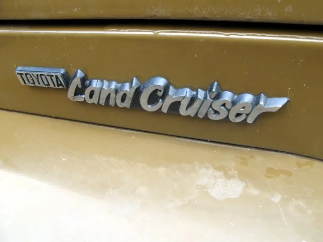

Emblem Restoration
I sprayed the cowl emblems with Rustoleum, then wiped off the chrome with a paper towel and a bit of thinner. Not bad, eh?

Ugly Window Tint
That PO had a style all his own. When I sold the ambulance doors I swapped one window because of a big scratch. I had to scrape off the tint. It was not fun. I'm not looking forward to doing six more windows, so it looks like this. This one is actually the worst one.

Roll Bar Pads
Mr. PO didn't save the original roll bar pads. I found a set here on mud and later found these '79+ junction pads. Not original for my '78, but functional, keeping the little ones heads out of the exposed bolt heads.
You can see a little rust repair on the top and the missing headliner. Plenty to do this year.
