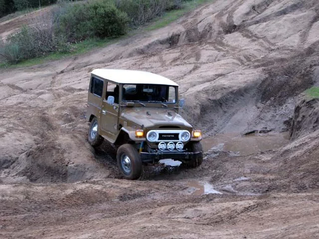

Wheeling pics from Hollister - Feb 24, '07
On the Trails, Events, Expeditions Forum
http://forum.ih8mud.com/showthread.p...91#post1889291

Looks like a good time Eddy, you know I spent almost my whole life in hollister and only went wheeling out there once. We always went illegally in the river bed or out in fields. Im hoping that when I get mine all fine and dandy to be able to take a trip up there in it and wheel with some of my old friends who are still hanging around. The rig looks really nice and it is awesome that you made the cruiser a family project. Mine is being worked on by 3 generations Grandpa, Dad and yours truly.
Take care and enjoy!

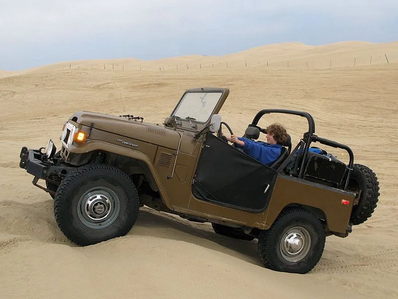

You mean like this:
And this:

And how about one from Surf and Turf showing the rock rash I got on the fj45 run?
